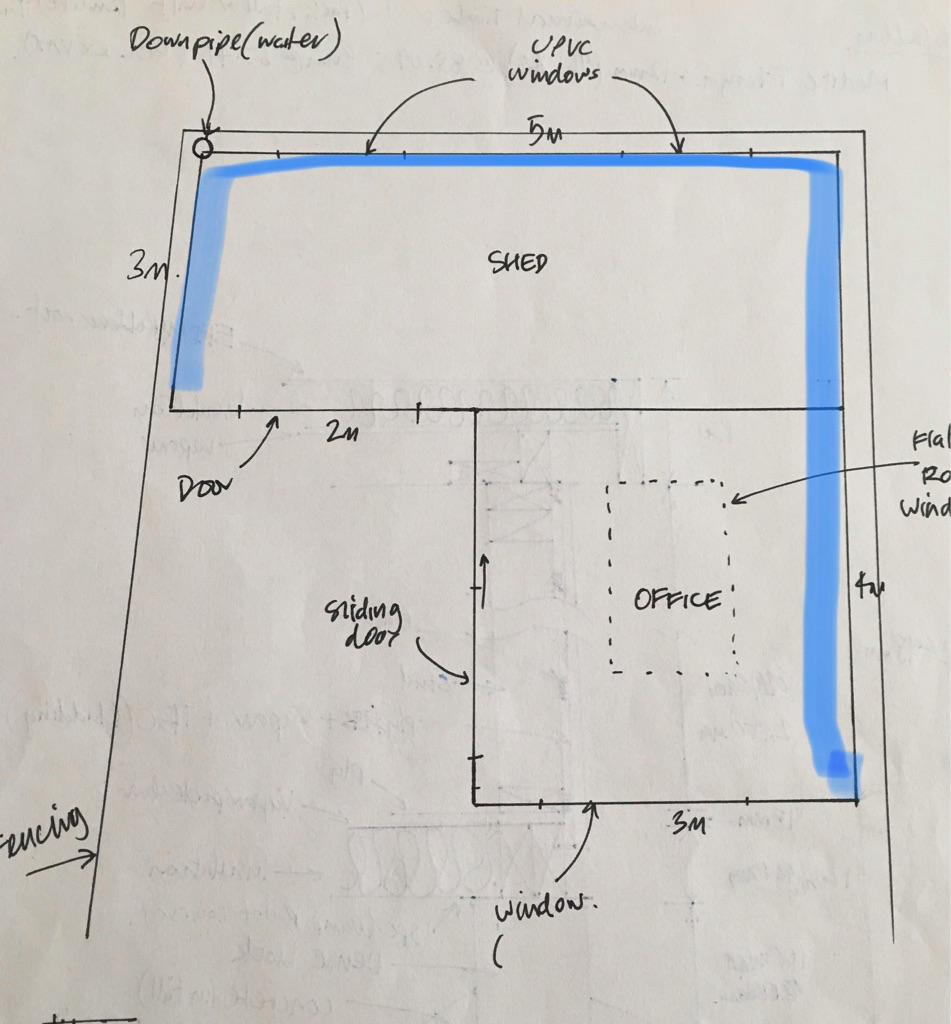

Sketched Plan:

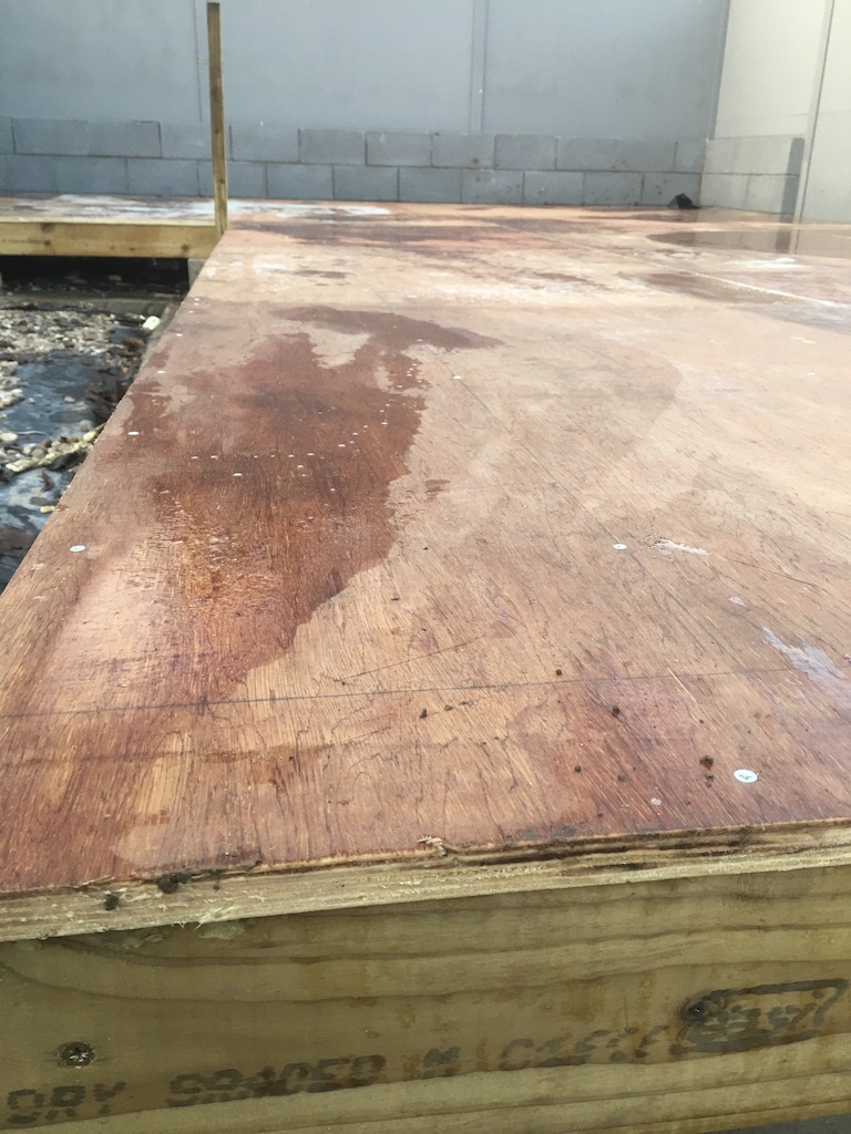

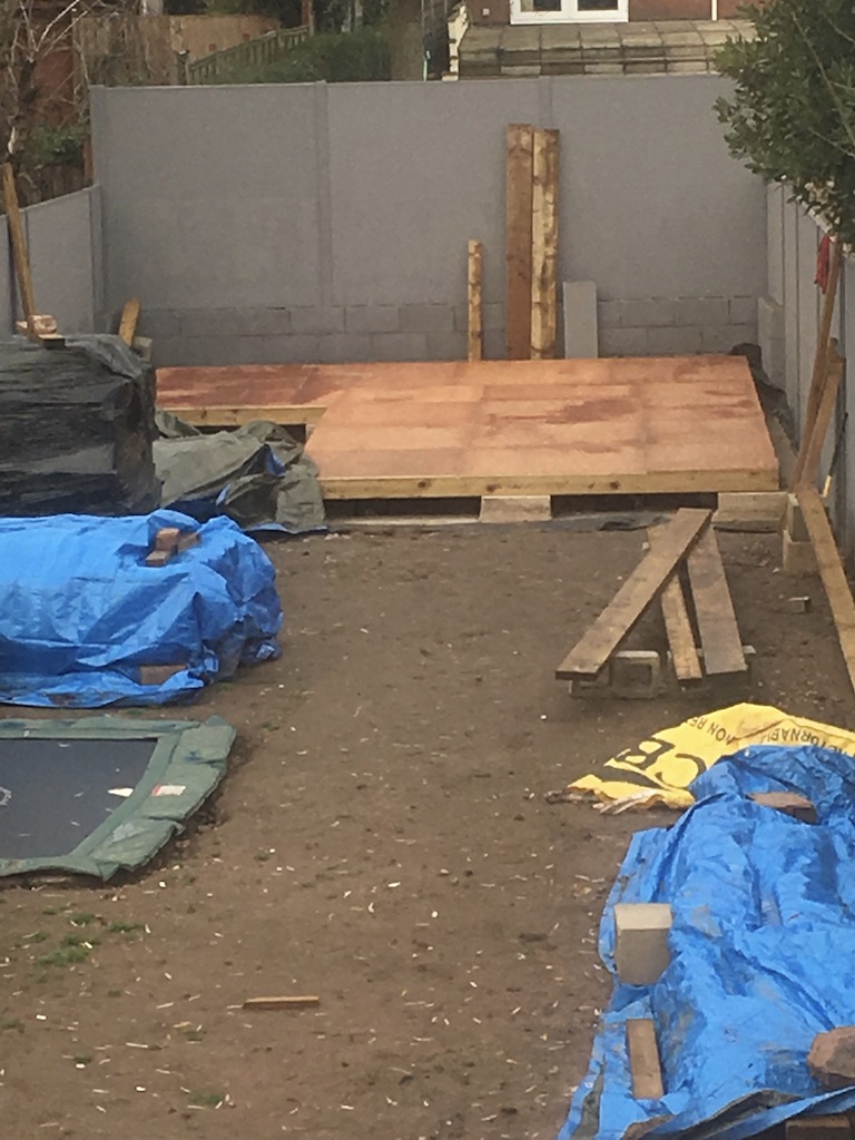

We have got to point now with the cold and winter months (and family commitments) we can't do much until the weather improves. We have got to the point now were we have put in the foundations, concrete blocks, wooden frame (with insulation) and put on 18mm plywood.
We did cover the area with two large tarps, but water got in hence the damp patch showing on the left hand side. We let it dry out on a clear day and applied two coats of oil-based sealant (Barrantine??). We have covered it again now but not sure what else we can do.
[Q] We really could do with some advice on: Water damage/protection for the next few months.
Tx
I take you you want to try and stop your plywood base getting wet ? Those cheap blue tarps are a bit rubbish. Ok for a shower, but not for long term. Get yourself a roll of Damp proof membrane from somewhere like screwfix. About £25. and roll it out over your ply. Either staple it down around the edges, or weight it down with some bricks and blocks. You might ger a bit of condensation, or sweating through it, but being ply it will dry out, and the membrane will protect it untill you can get back on it. Go Girls

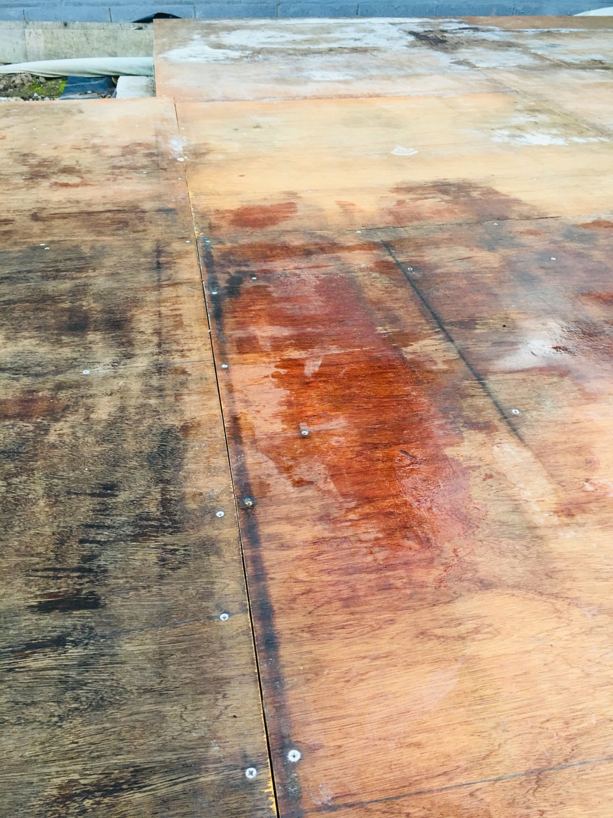

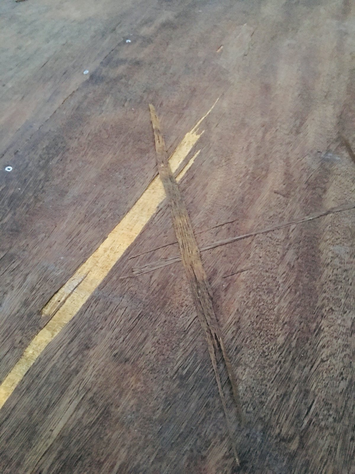

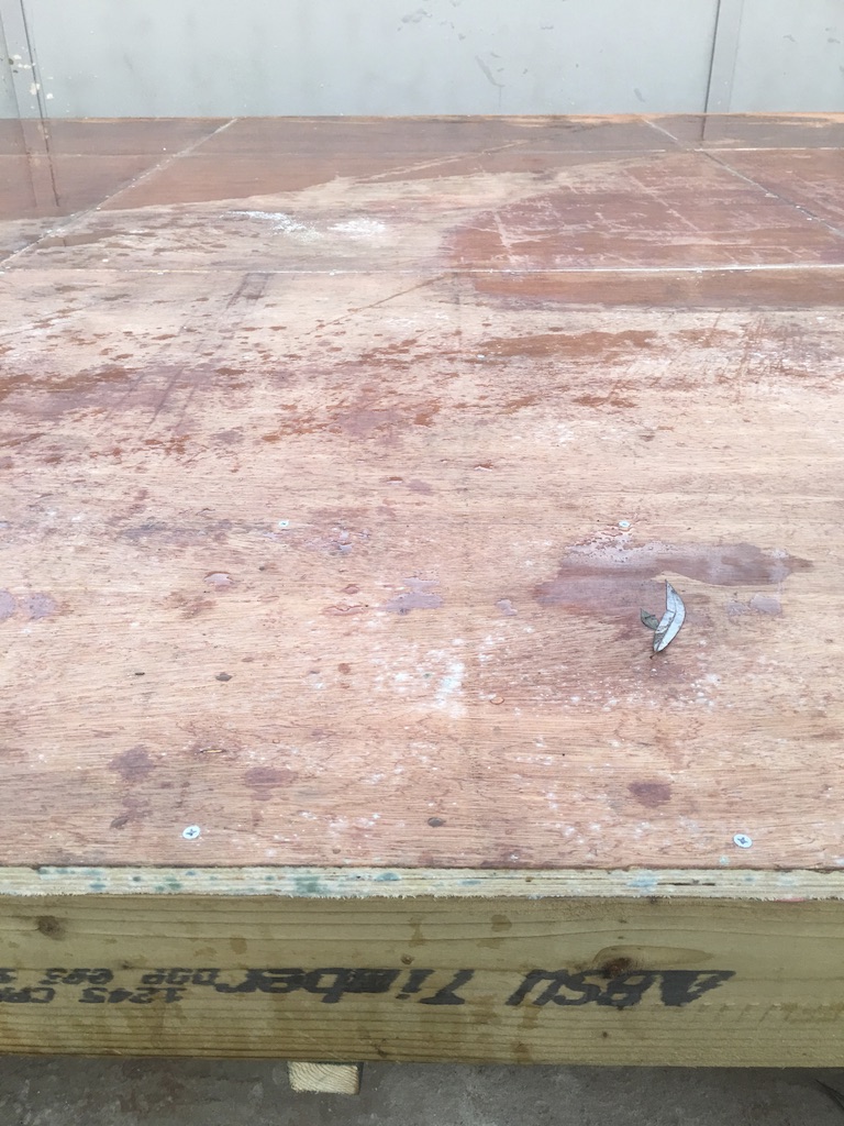

We all got really sad after we took off the tarp (which was doubled up). We got this horror:
UNADJUSTEDNONRAW_thumb_4014.jpg UNADJUSTEDNONRAW_thumb_4016.jpg UNADJUSTEDNONRAW_thumb_4015.jpg UNADJUSTEDNONRAW_thumb_4013.jpg UNADJUSTEDNONRAW_thumb_4012.jpg
The weather over the next few days is looking dry (and cold) so we are going to leave it uncovered. After a few days, we will cover it with the DPM. We are all upset about this damage, we get emotional, so more than others (lol), we are thinking now that we will need to pull these Plywood sheets up and put down new ones. Just our luck!
Any thoughts from you guys would be gratefully appreciated x
From your pics the ply doesn't look too bad. I'd let it dry out over the next few days then cover it until spring. Then uncover and re-assess. No point jumping the gun just yet.

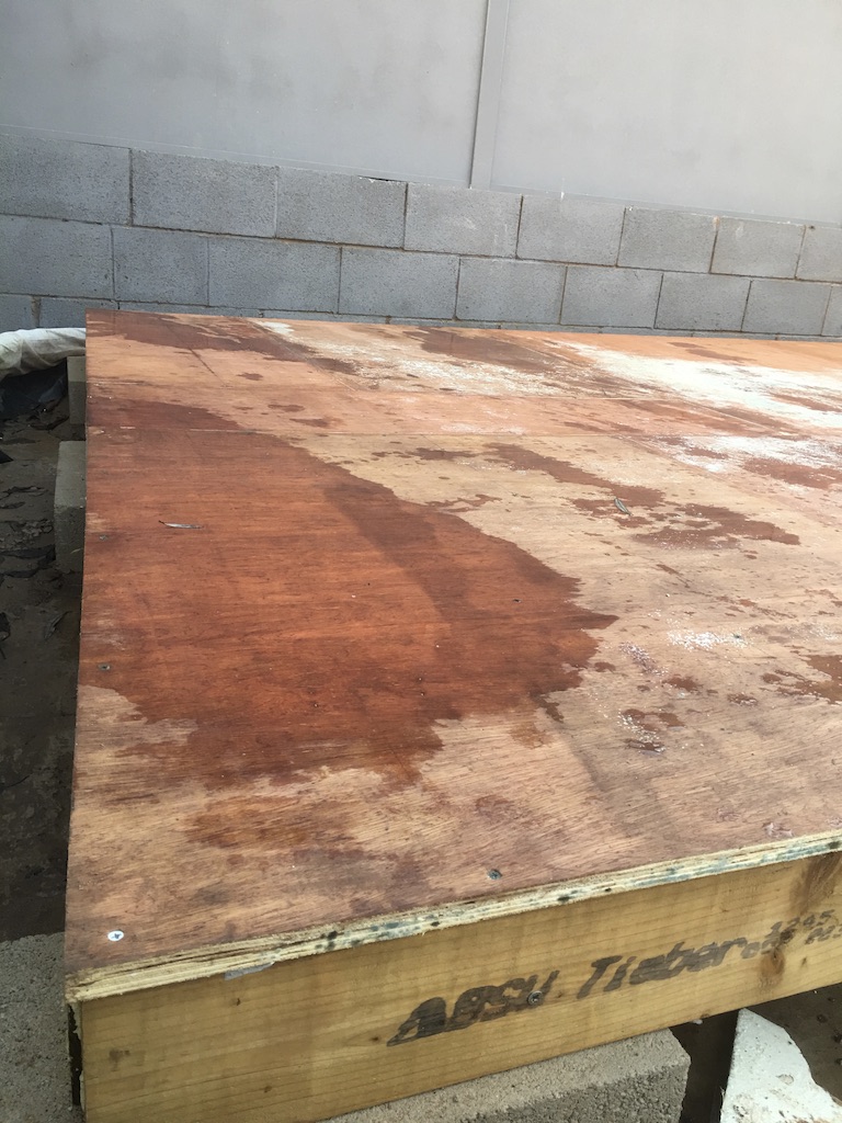

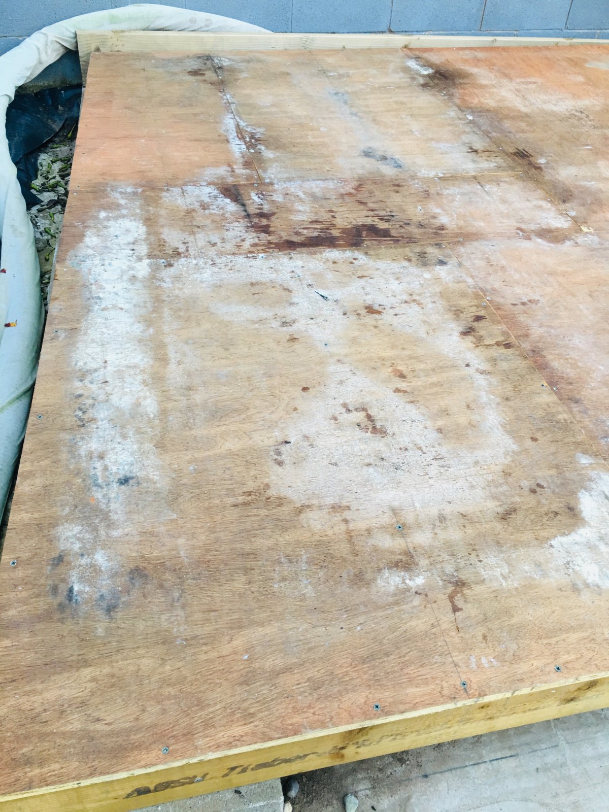

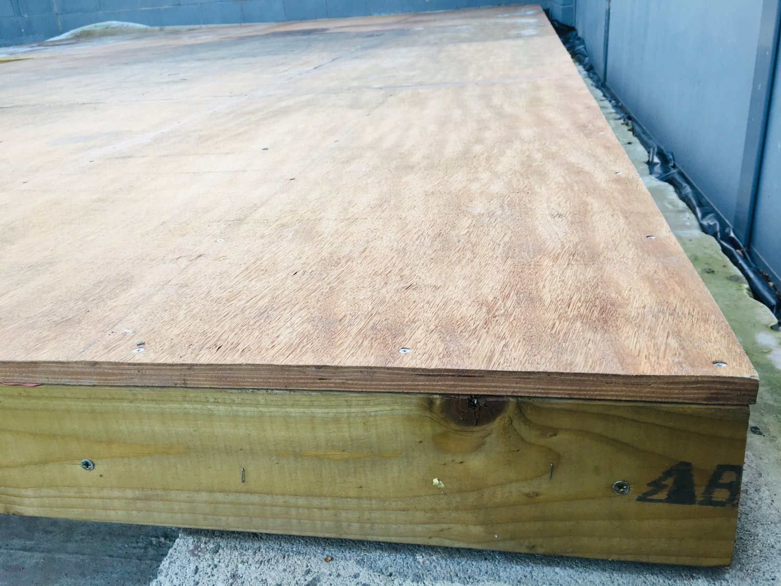

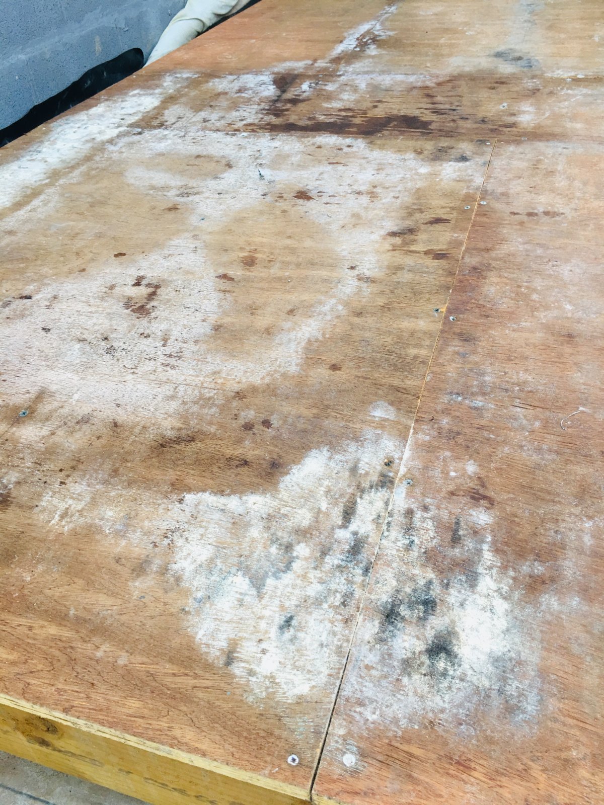

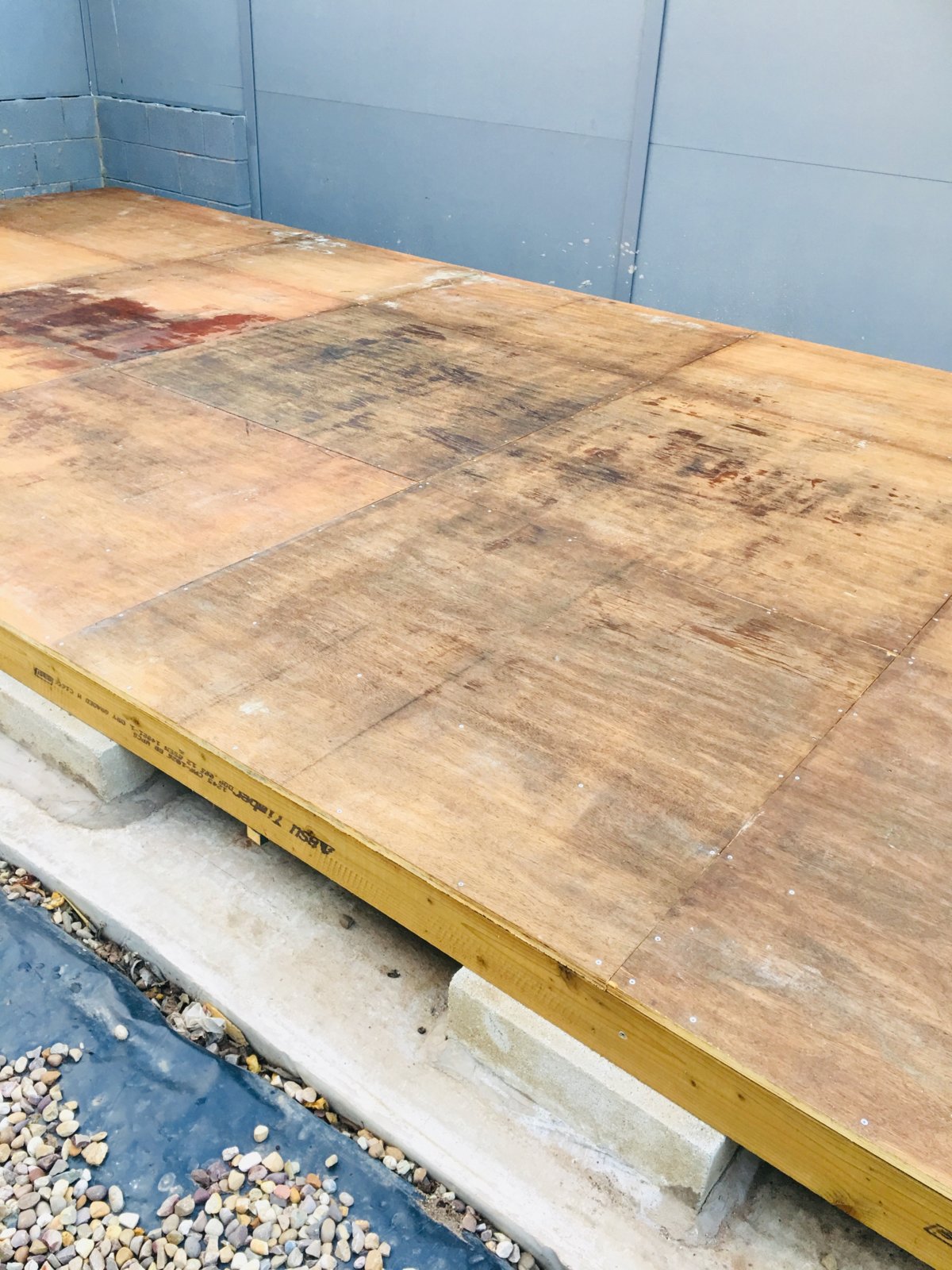

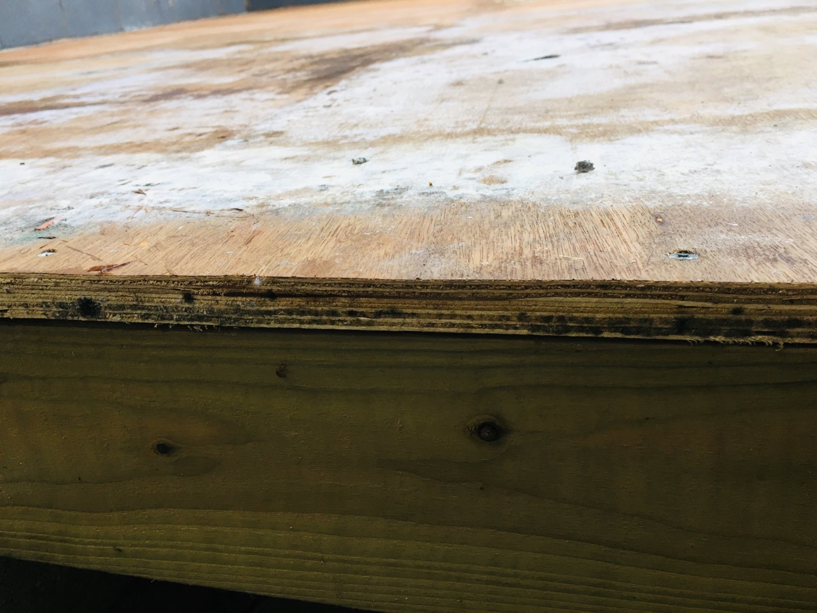

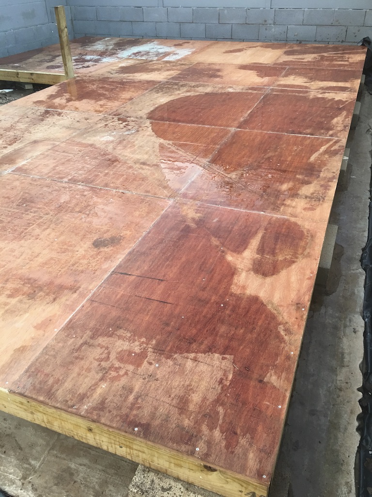

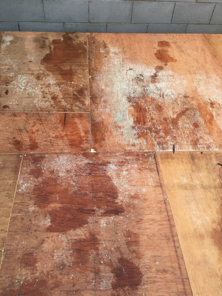

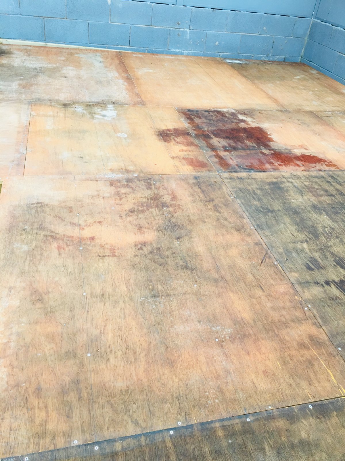

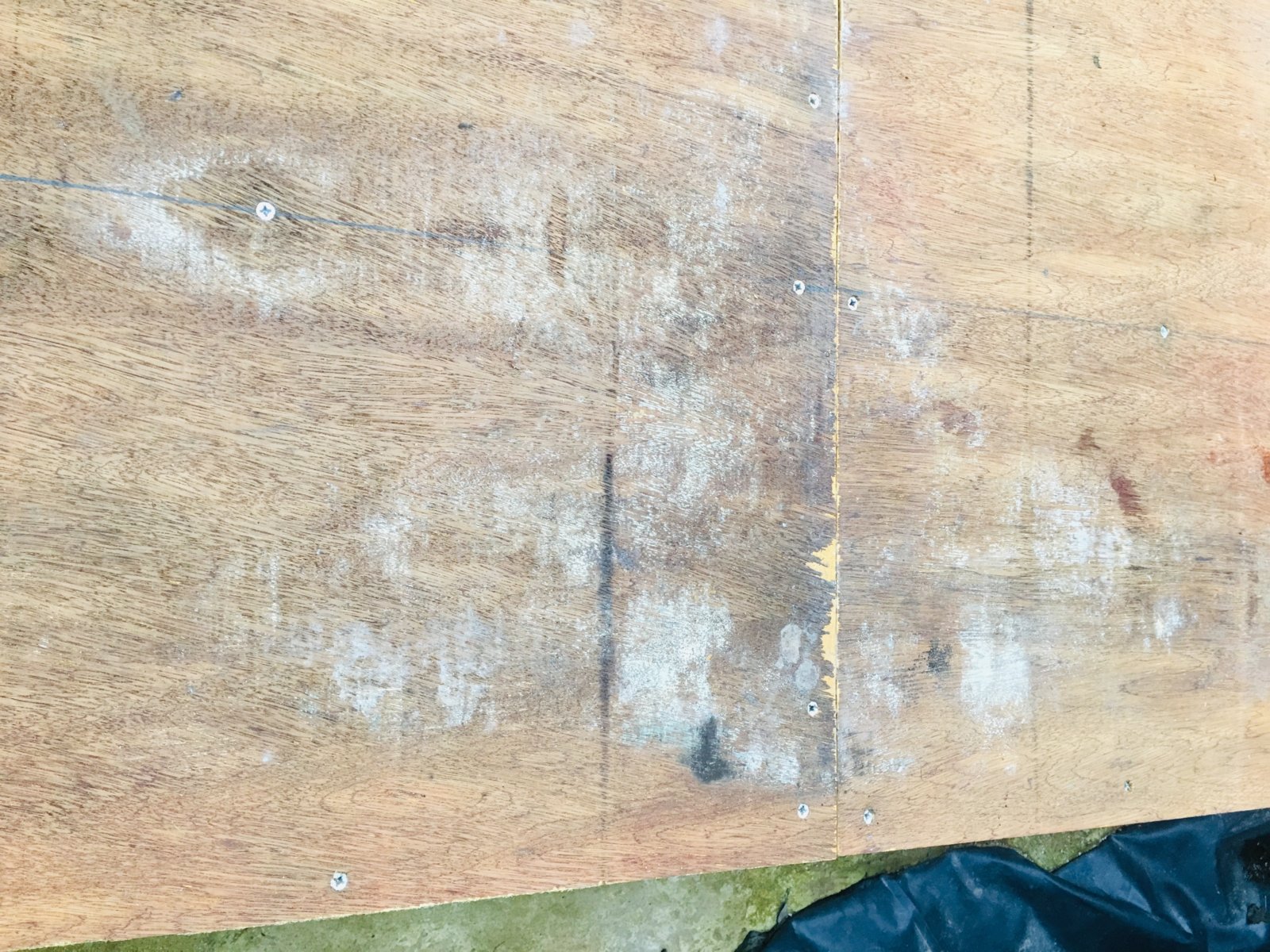

We lifted off the wraps and we found mold and discoloration on the Plywood. :( I have attached pictures.
IMG_0371.jpeg IMG_0372.jpeg IMG_0373.jpeg IMG_0374.jpeg IMG_0375.jpeg IMG_0376.jpeg IMG_0377.jpeg IMG_0378.jpeg IMG_0385.jpeg
Some of the ply have mold on the top and some have not. Some of the ply we have noticed the mold has spread down the edges/sides. Some of the ply we have noticed have turned discoloured - turned black (is that mold?). Noticed one of the ply has 'flaked'.
We thought about using a weak solution of beach and scrubbing the surface, wash and let it dry in the good weather. Some of us are arguing on using bleach on wood, some of us saying that it would need to kill the mold so will need to be a stronger mix, and then we argue some more about what would happen with a strong mix... we just argue! :LOL::LOL:
Sanding is the other 'craazy' option we came up with!
We rang up a few merchants. Some said to replace the plywood! Other merchants said it is okay - just wipe it with a brush.
Want to ensure this mold does not become problematic later on (years). Can someone please give us advice on what we can do? Thank you!!:D
[EDIT] Just wanted to add, the ply will be covered with another layer - so for the shed area we are looking at a PVC flooring and the Office we will put down laminate.
Brush off , you could scorch it black (heat gun or blowtorch)which will kill anything and also acts as a preserver .
