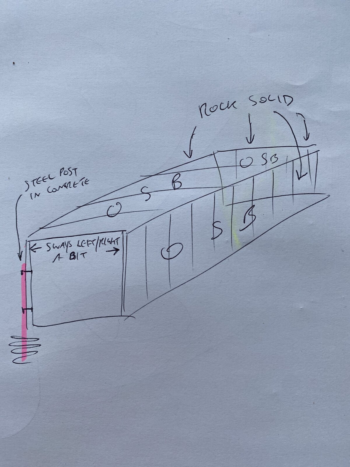

Evening all, not posted here for a while, hope everyone is well.
I’ve been knocking up my garden room, and have realised I may have made a design mistake so trying to work out my options.
Basically all was good, walls are up (4x2 sheathed with 12mm osb) roof deck is on (5x2s). Issue is, one of the end walls is going to consist pretty much entirely of a 2m wide aluminium bifold. There’s only about 150mm of “meat” either side of it.
Bifolds are paid for but not arrived yet, and I’ve now found that you can “sway” the opening somewhat as there’s very little lateral restraint as it’s completely open ready for the doors. Despite the other 3 walls and roof being up and sheathed in OSB.
Everything is pretty well fixed with 100mm screws everywhere, and short of fitting some big flat steel angle braces at the top corners of the opening, I’m not really sure what to do.
Reckon there’s a way forward here, or is this an invalid design, and I need to rethink the whole thing?
Thinking about this I reckon my options are:
1) rely on the steel bifolds to provide rigidity (doubtful?)
2) get some decent heavy duty L plate steel brackets (the flat ones not angle brackets) and fit to each top corner studwork on both sides and use loads of screws
3) fit some kind of separate corner post to one side with a decent depth and amount of concrete to shore it up, would need to get creative with the cladding to hide it
4) fit the bifolds on a different (longer) wall - this is looking like the easiest option :D but changes the design from how we wanted it

they’re top hung doors, fixed to a doubled up 6x2 above and only 2m span so I’m not worried about that so much, more the risk of the whole structure diagonally racking if the wind catches the adjacent wall. I’ve no idea yet whether fitting the doors will help prevent that. Without the doors in, there’s a bit of sideways movement at the top despite the other 3 walls and roof being on

may also try and add a wind post, which I reckon could be what’s needed,
Just on the wind post topic, this is to stop tall/long walls buckling in the middle under wind load, not to stop racking.
You'd need more like a moment frame, sometimes in big extensions they make a goal post or even a box frame to resist the torque on the joints. Although that would be clearly excessive cost in this case!
Wind post would not have strength against the relevant forces in your case.

Maybe wind post is the wrong term .. see pic
I reckon the pink steel post will stiffen it up if the doors themselves don’t…

the trouble you have with a single post is the load is transferred to the ground by leverage so the support point is around 2m away
