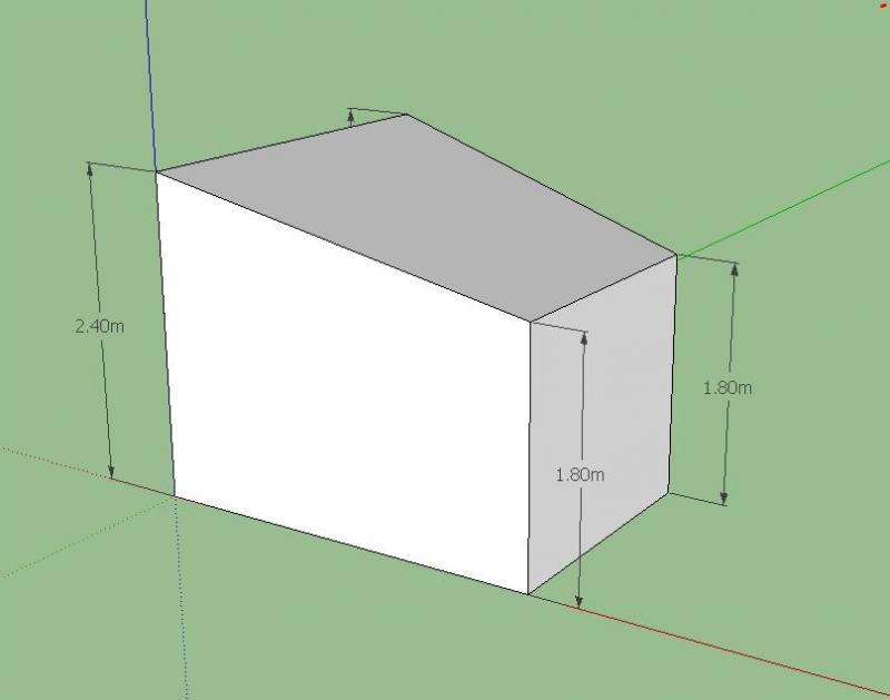

Wanted to build a small garden shed out of bricks at the end of garden. After clearing all the over grown ivy, i have got a problem with the shape of shed.
Please can anyone advice what to do with the backwall of shed.
Follow the line of plot,then you have problem with flat roof. Do not really want to leave space at the back to make it square.
Any suggestions appreciated.
View media item 84672 View media item 84674
A decade or two back I built a shed a bit like this except all four sides were unequal lengths!
All you do is have a single pitched roof, if you build your two parallel lengths of wall first, as you know the heights of each, then you can infill the remaining two sides.
Trying to do a conventional hipped roof would be a bit more challenging.
Thanks freddy. It will be a flat roof. Can you please direct me to a pic or something if possible. I tried to look it up, but no luck.
get yourself a block off foam and make your shed as a rectangle with the slope on the roof
then trim to the shape off the plot keeping in mind the water shedding off the roof should discharge on your land which may rot the timbers quite quickly if not directed away from the structure
Thanks freddy. Much appreciated.
Bigall: I believe you mean the roof timbers. I am building it out of brick. I will keep it in mind.
I intend to build a small parapet wall on the roof as shown on freddy's pic,and will also leave a bit of overhang on all sides at eaves. This way will be able to divert the rain water easily. I hope it works out fine.

Yes the end of wall at the left of your picture. Raise it maybe by 3-4 courses and use capping. Then can obvoiusly form a gutter from lead and can hopefully avoild the water collecting.
