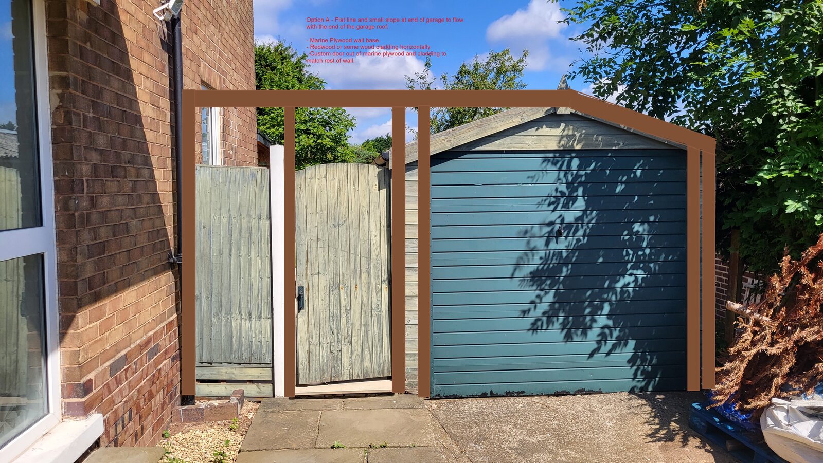

Hi,

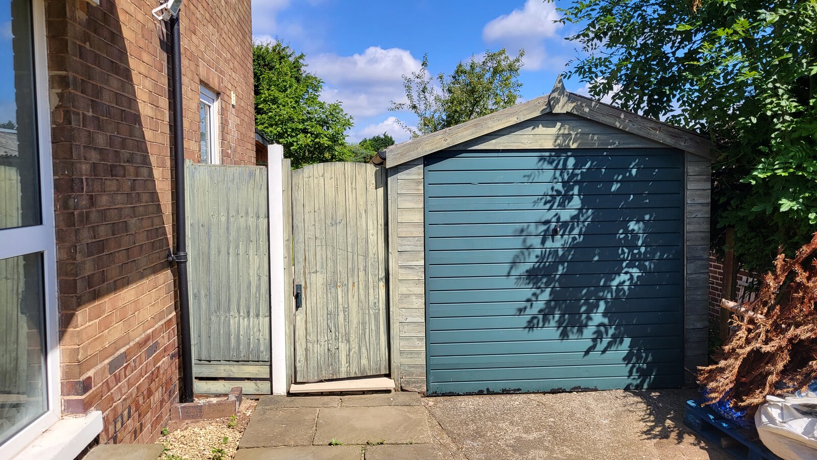

I finally have some time to tidy up the front garden, and one of my first projects is to rebuild the side entrance to the garden and garage.
I have several unused marine plywood panels and thought of creating something more substantial than just a fence for the front (see attached pictures). My plan is to build a wall from the plywood, add battens, and finish it with horizontal wooden cladding. I also intend to make a custom door from the plywood and clad it to match the wall (theres a reason for the over-the top wall for a garden, bare with me).
Here's my very simplified step-by-step plan:
  1. Attach a post to the wall.
  2. Attach a post to the existing concrete post (as seen in the picture, it's level and sturdy).

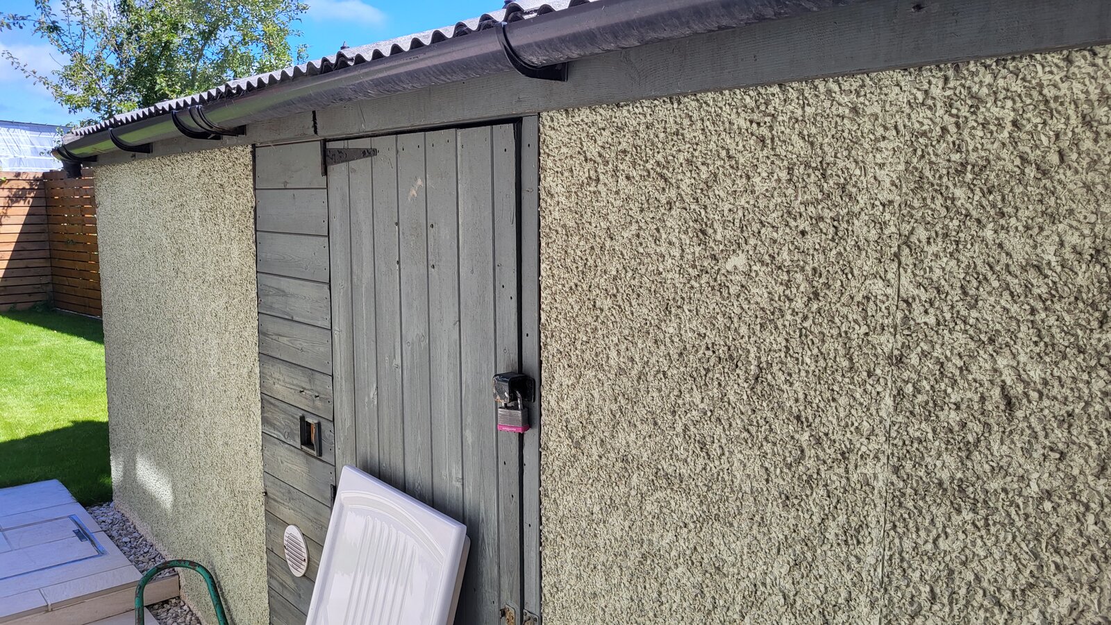

  3. Secure posts to the concrete panel garage. If there's no obvious place to attach, I might use rods with epoxy drilled into the ground.
  4. Attach the plywood panels.
  5. Finish with cladding on the outer-facing wall.
In the future, I might build a lean-to shed between the garage and the house, so this wall would be the first step. Eventually, I’d like to add a transparent roof from the house wall to the garage.

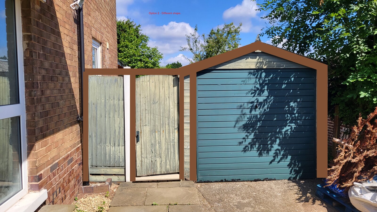

(Options im pictures) Would you recommend Option A: a flat wall with a slight slope at the end, or Option B: forgetting the lean-to altogether? Or do you have any other suggestions?
I understand the plywood wall might seem a bit much, but I have plenty of it and would rather use it than let it go to waste (I've already used a lot on a garden house).

if you are planning to put up a lean to - then A option would help you with that in the future - you may want a decent angle on it from the house wall - so if you do add a leanto and roof in some way - the rain water will flow away from house

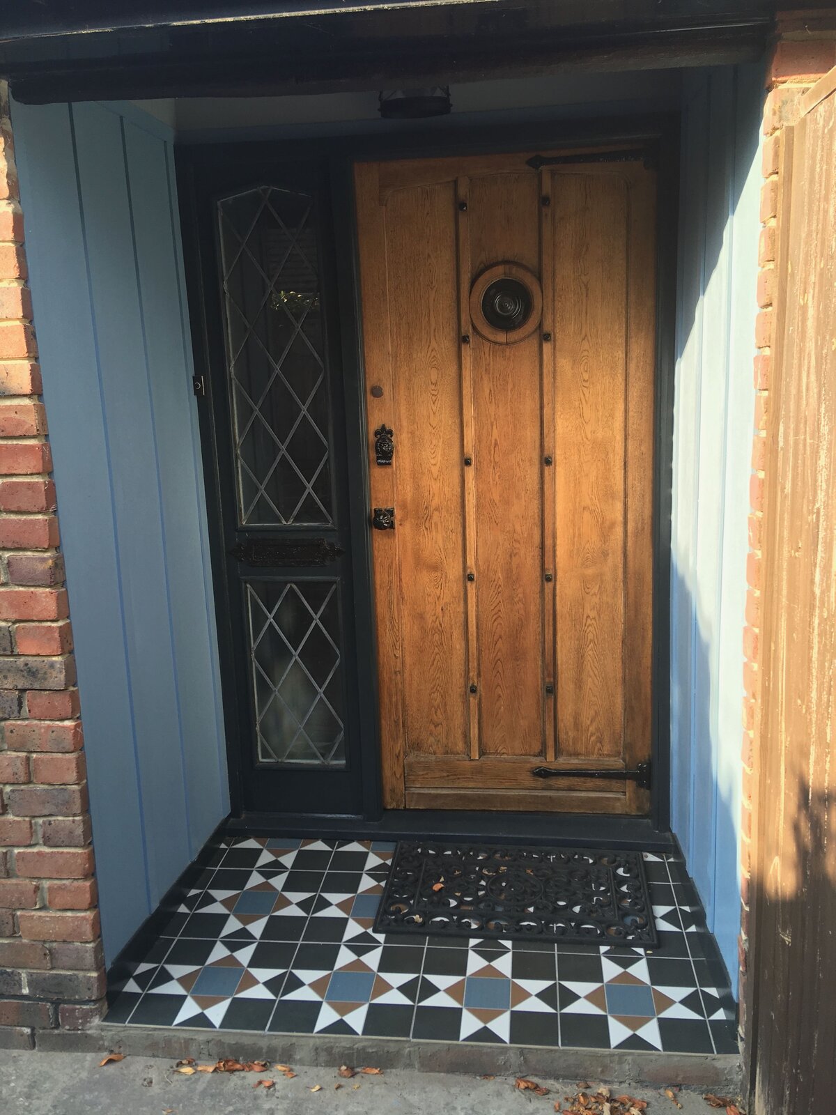

I built a lean to - totally enclosed and a lot of glass
I used marine ply & redwood on a porch and Dulux Trade Ultimate Opaque paint - as its exposed and gets a lot of wind, by the sea
both the sides are marine ply with the redwood to make the upright effects - and painted
Done during covid , and as good as new 4 years later
