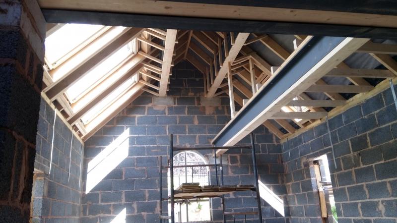

I once built a very tall art studio for a lady in staffs....
This looks really nice! That's the kind of thing I'm thinking of, though maybe not quite as high and with a sloping roof rather than pitched so it's tall at the painting wall end.
This looks like you used the 4m permitted gable height?
In my case I would be limited to 3m for pitched roof, but that would suit my requirement better than having height in the middle of the space.
In my case it would be a bit more bare bones inside, but would need to be insulated for all-year round use.
What's the budget for something like this? Feel free to dm me if that's private information.
It was about £65k back in 2015. It will be nearly double that now.
Wow ok thanks, and in London maybe even more. I was thinking more around £50-60k mark.

Insulation, exterior décor cladding, roof, wall/floor finishes, plumbing/electrics, services to the building i.e. drains/power/internet, fitted bespoke elements, structural beams (bigger buildings).

bear in mind if its closer than 2m to the boundary or higher than allowed it will need planning permission
over 30sq metres you will need building regs anyway
design wise, keep the shape rectangular, ideally with a flat or shallow sloped roof.
if you are happy with plywood interior for walls and maybe painted timber sheets for the ceiling, you will save on plastering and decorating
Probably a cavity construction in blockwork would be cheapest and you could batten the outside, have timber cladding on the sides of the building you see and just rendaboard or steel box section for the sides facing the fence.
