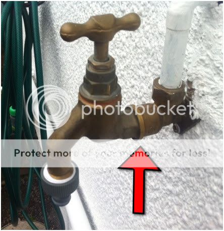

I have supplied a photo of the tap in question.
Is this tap made by peglar ?
I ask as i have seen a few taps but where they scren onto the fitting at the wall is on an angle where my tap fits in horizontal.
If i split the tap where the arrow is pointing can i then just screw on the new tap and job done ?
dont know the make but yes any threaded outside tap will screw into that backplate ... might want to add a bit of ptfe tape aswell

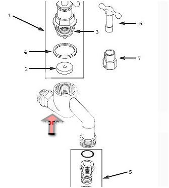

Here's the spares diagram:

In respect to the photo shown below am i correct in thinking that the damaged item is where i am pointing to ?
Yes and no.
Not 100% certain about the Pegler 142HU, and can't check as I'm off work at the mo, but most makes have 1 check valve by the inlet and the other by the outlet.
The picture below shows, just inside the threaded tail, one half of its white plastic DCV. The other will be just inside the male thread for the hose union. Normally held in place by circlips or brass rings.
