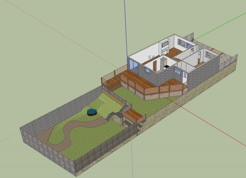

After Clearing the garden, then leaving it for too long I am back to square 1!
Oh well time to start again, below is what I want to acheive:
What do you think?
Would you change anything or do you have any ideas that could improve the garden....

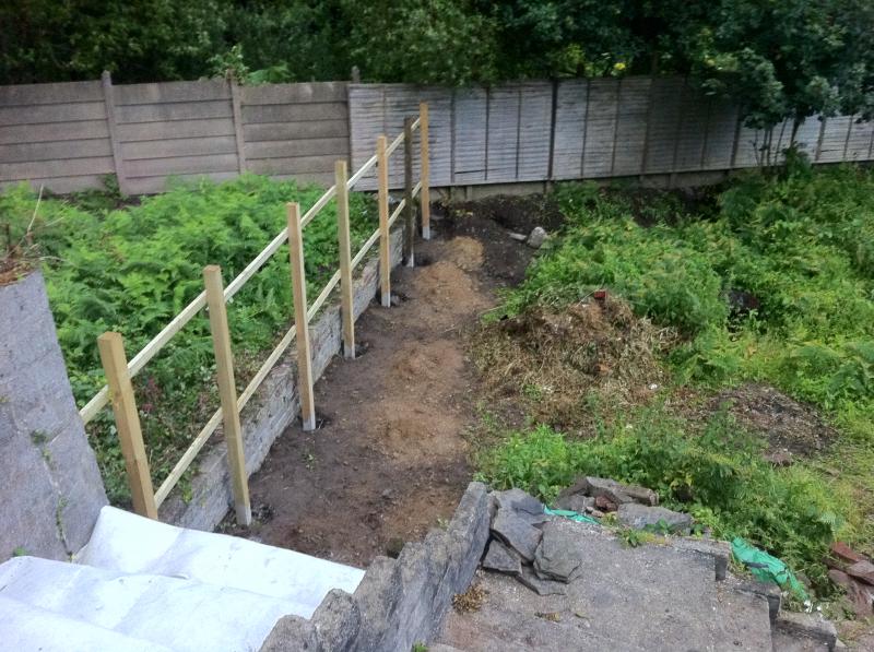

My 1st job was to fit a 10.7m fence along the side wall of the garden.
As the neighbors’ garden is 2 foot higher than mine I used 10m posts 2foot in the ground, 2 foot against the wall and 6 foot above the wall.
The posts are 1.8m apart, as you may see I need to add 1 more post next to the end post.
A hard afternoon’s work with a shovel and the 6 posts were in within a few hours.

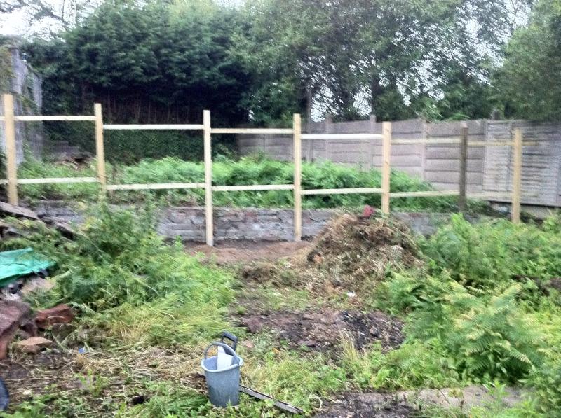

Next job: fit the cross beams and feather edge boards....
As you can see this may be a fairly long process and prob never finished but i'll keep updating as i go....

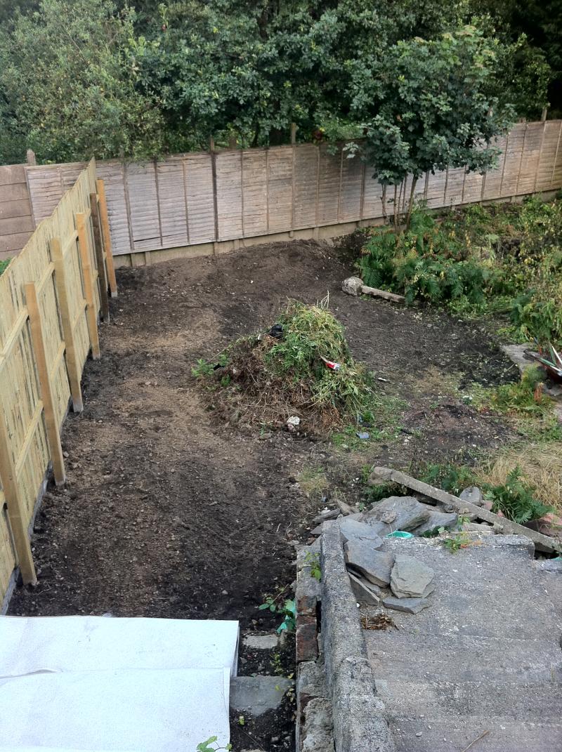

Fence 1 complete!
A view fron the neighbours garden:

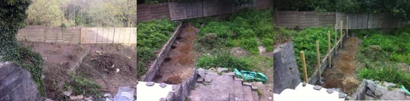

After a bit of battling with the nettles and weeds I think I am finally getting back to a blank canvas!
I also found a rather large concrete post with the concrete base attached, after an hour of digging and using 2 fence posts to lever it out of the hole I won!
I now want to add a path from the steps along the fence to the rear corner, with no access at all other than through my front door – living room – dinning room and kitchen Gravel may well be out of the question….
My next option is bark, as its much lighter…although im sure it would end up looking rubbish after 6 months…
Any other options, decking could be my best bet as I have a load of old decking to take up.
