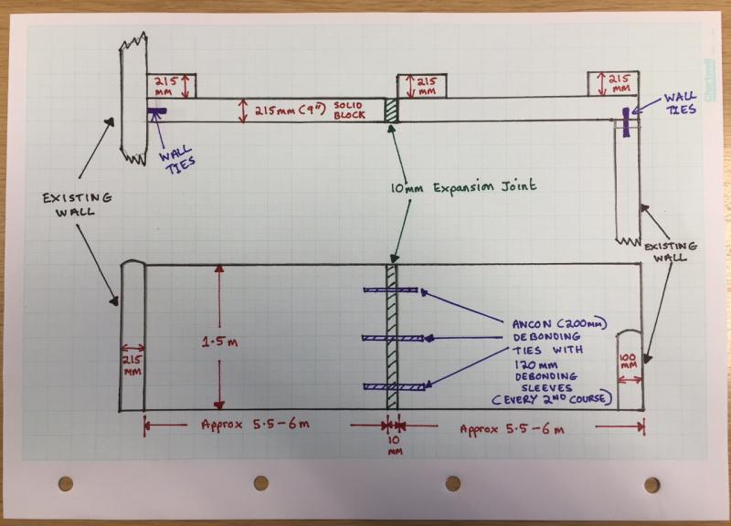

Hello,
If I put the 10mm expansion gap between the two pillars in the middle of the wall (approx 6 m either side to corners), should I just leave a 10mm gap and build up corners on each section (4 corners). Or do I need to install foam in the gap or Helical expansion joint stainless steel rods between expansion/movement joint. One end fixed to mortar bed and the other side in a tube to allow movement.

Does this design look okay?
Would you also recommend using the debonding ties and an expansion joint when I tie the wall in to the two existing walls. Or shoul;d I just tie the walls in with standard ties?

Don't forget that this is a block wall, so it's recommended to install a *contraction* joint at 6m centres.
You can get flat bars, with a plastic sleeve to allow movement, called debonding ties, which go across the joint every 2nd course.
I would definitely use these as it prevents the two parts of the wall from moving independently of each other laterally.
I've just done a calculation and I would advise not going any more than 1300mm high in 215mm blockwork, so it would be sensible to build the bottom at 300mm thick and decrease the thickness to 215mm once you are 1300mm from the top. That way you will not need piers. If you do want to use piers I would recommend them being much closer centres, around 2-2.5m max.
By the way, the piers at the ends are not doing anything once the new wall is tied into the existing walls, so no point having piers in those locations.
Use a minimum 1:5 mortar and dense blocks on a 600mm wide foundation. Take your foundation a minimum of 500mm below ground and have at least 150mm between top of foundation and ground level. It would be sensible to use brick to 150mm above ground, or put in some lapped slates, both in 1:3 mortar to act as a DPC.
Don't forget to put a DPC below your coping if you have one, and ensure that your contraction joint continues through the coping and to the foundation.
I'd use a wall starter at the ends which will allow for differential vertical movement, although the lateral movement should be dealt with by the central joint.

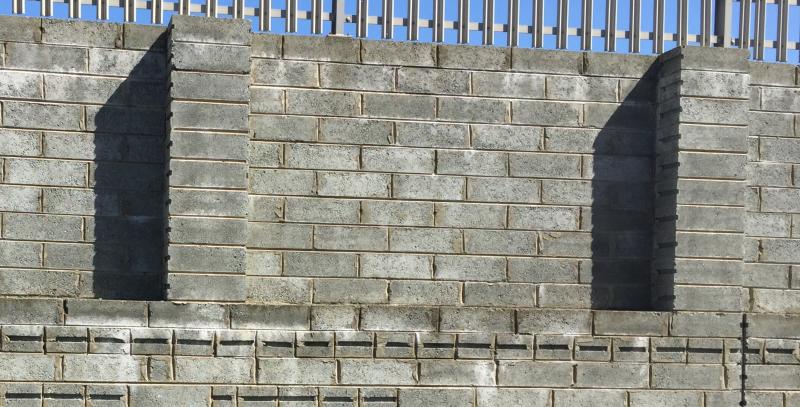

Also is it okay to tie in the pillars with wall ties as opposed to overlapping the blocks? This will keep the front face of the wall the same across all courses.
Like this image:-

I think you replied before reading my edited post. I edited to say that if you make the bottom part 300mm thick you won't need piers, but if you do want to use them and stick with a 215mm wall allthe way down to foundation they need to be at much closer centres - (see previous post above).
If using piers I would rather bond them in properly as you won't get the same stiffness from tying to the wall. Some clever block cutting would allow the front face to look the same all the way along.
Yes, wall starters at the ends as they allow for vertical movement - the contraction joint will deal with the longitudinal movement.
