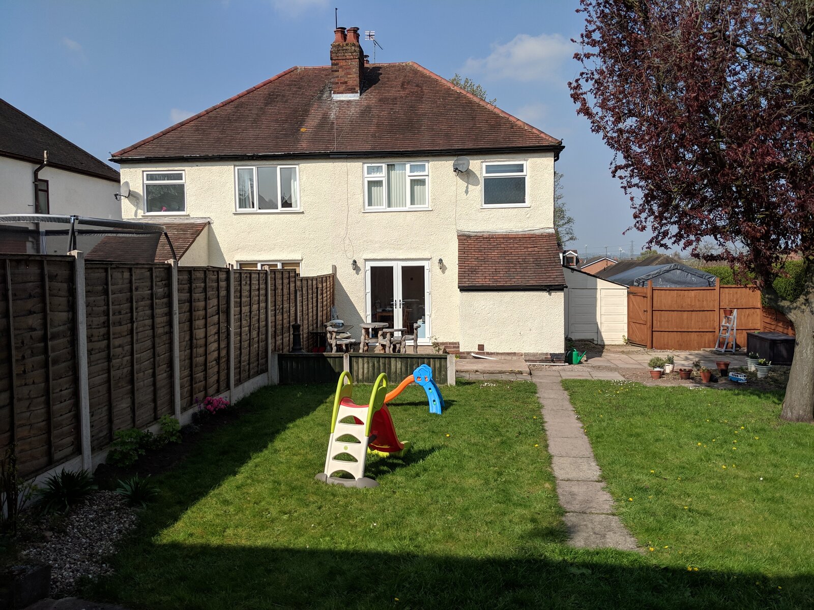

Anyway - the summary is simple. When we purchased the house there were some horrid and somewhat random concrete "patio" near the back of the house. We knew they needed to go but could never quite decide what to do, and because it was nearly 30m2 it was always going to be a serious task.
It's not a great photo, but it's one of the earliest I have from a few years ago before I rebuilt the utility. As you can see, it's not a particularly attractive area.

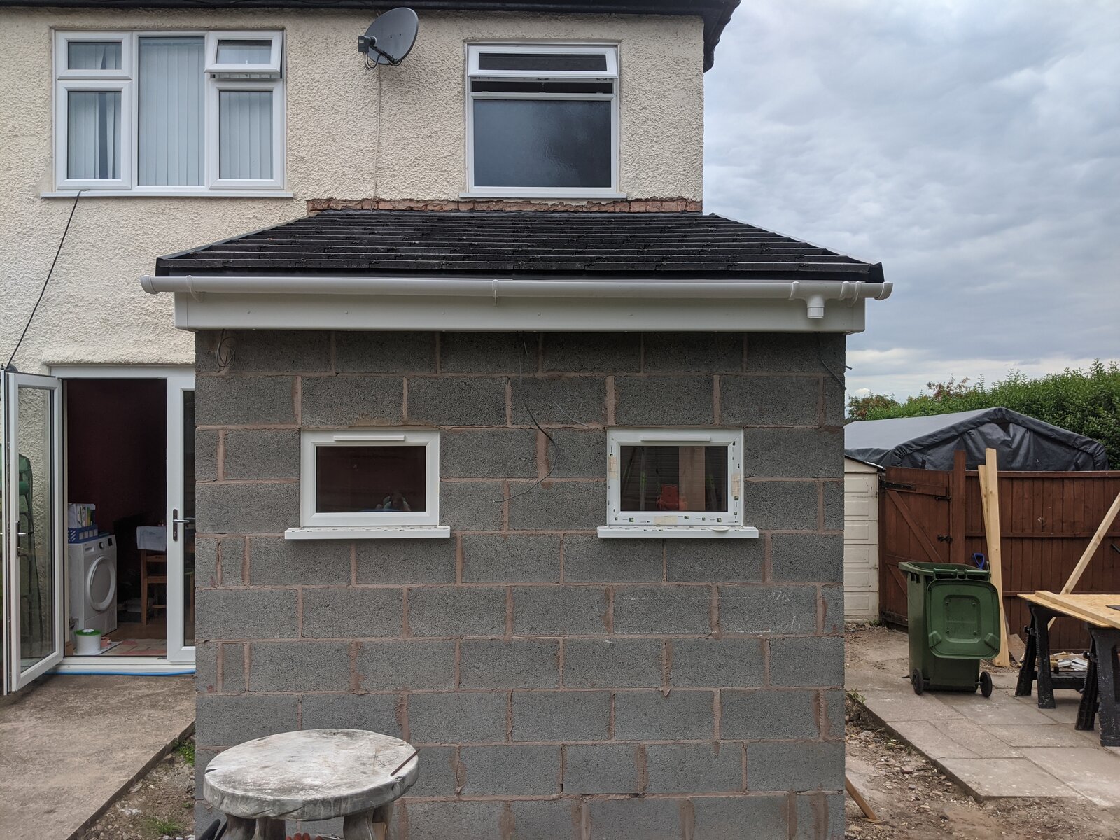

Again, not great photos I'm afraid but hopefully it'll give you a feel for the space as it looked after the main construction of the extension. So, after much debate we settled on the idea of a walled-off decking area. The idea was to create a space large enough that we could clear the garden of chairs and tables. So, plenty of space for a big family table, space for a BBQ, bit of garden storage for kids toys etc

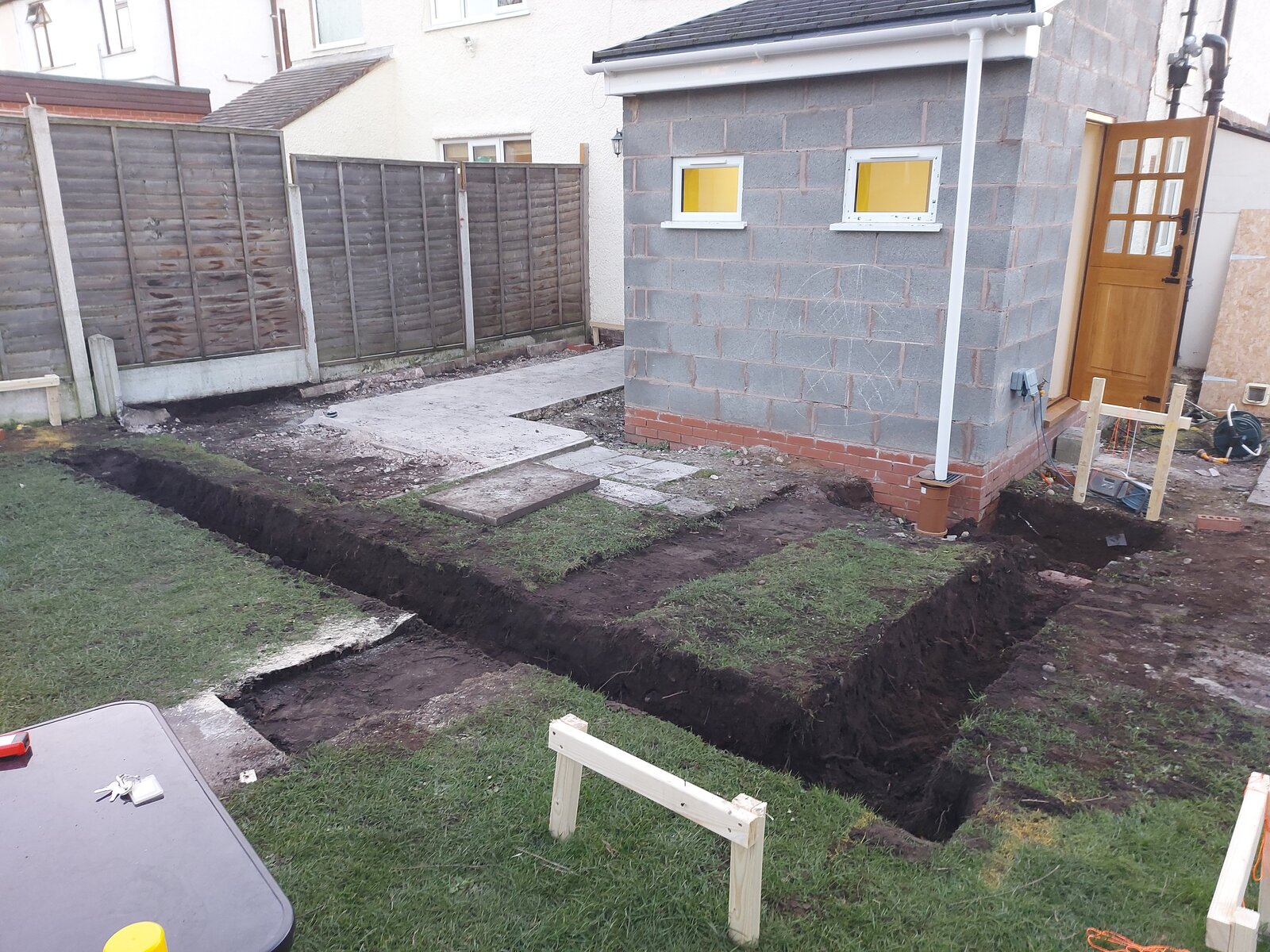

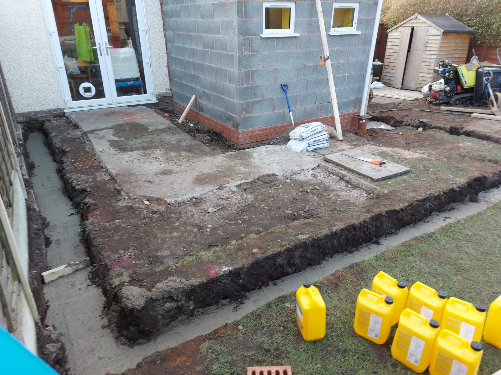

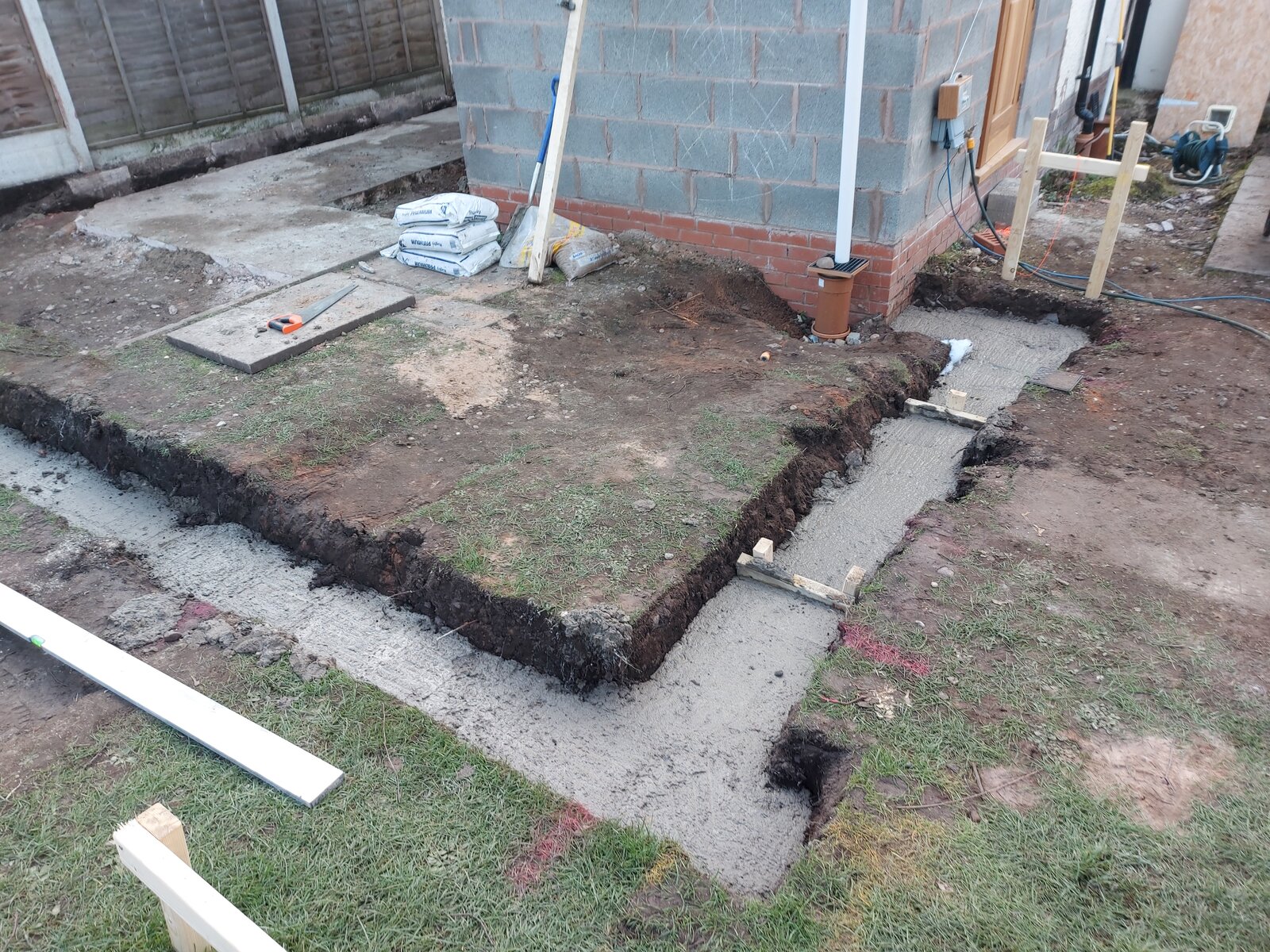

Of course, it wouldn't be a DIY project without some back breaking labour! It took a few weekends but with a little help I managed to clear a bunch of concrete out of the way, set out and dig my trenches. In hindsight, perhaps I should have cleared the middle first - I don't know - but this is the way I did it!
So you can probably tell from the photos that the top soil is just that - very powdery, so I dug down to the sand, deep enough to allow for a 150mm strip onto sand + 150mm from the top of the concrete to ground level. I probably made a mistake here, which I'll mention later.
The foundation was stepped down towards the house, because the sand layer gets lower.
The digging also undermined my neighbours fence a little which concerned me, but in the end nothing untoward happened.

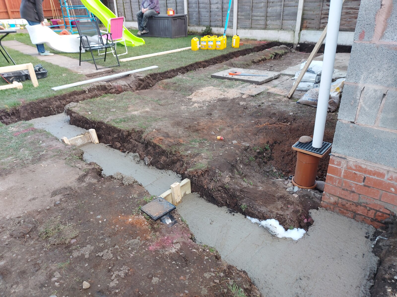

I spent a while debating whether to get concrete in, or to mix myself. In the end, I decided to rope in my brother and dad and mix it ourselves - mainly because getting it delivered would mean time off work and I'd be on my own. I wouldn't say it was an easy day, but it wasn't the worst with three of us - just kept on going!
I marked the height with rebar and my laser level before starting and it went okay. We were still quite early in the year when it was cold, so I did some buy some frost proof additive and covered it all up after. I was a bit paranoid because it turned out to be a colder few nights than expected - but, it's a garden wall when all said and done and everything seems okay. I used wooden forms to step down the footings 75mm a time (brick height+mortar) - that worked fine but they were next to impossible to remove!

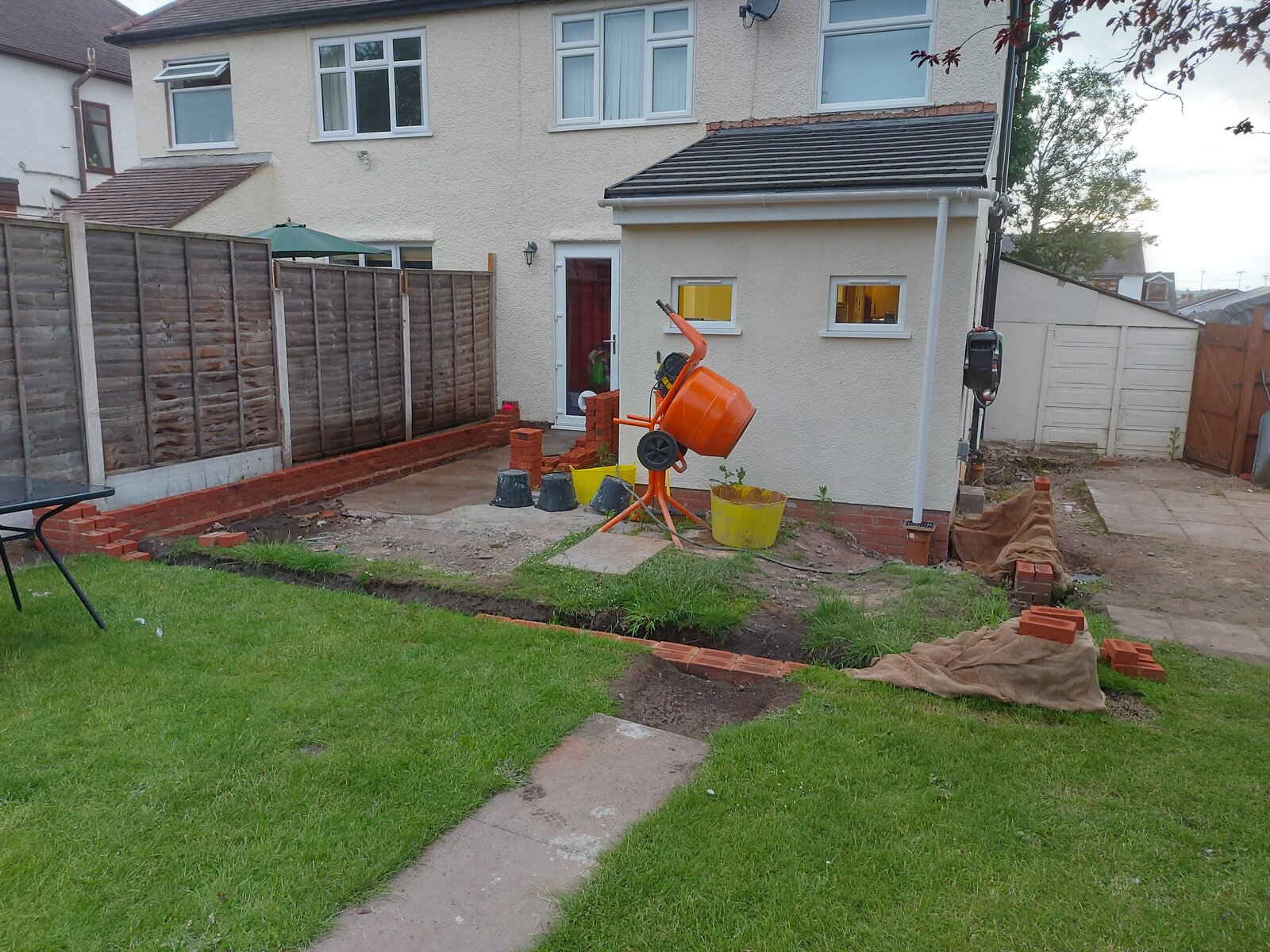

One thing I probably didn't make clear is that the decking will be basically the same height as the existing concrete, so there's a fair few courses that won't be seen. I'm glad I decided to do a 1 brick wall insted of half brick, but it was a bit soul destroying having to build everything "twice". That run from front to back is 6 meters!
Still, progress was slow but consistent. At this stage I was still working single handedly and because I'm slow can only mix 1/4 bag of cement at a time else it goes off.
