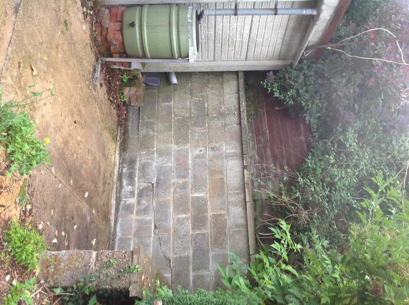

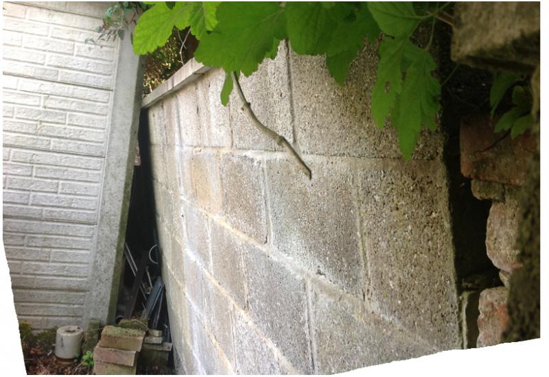

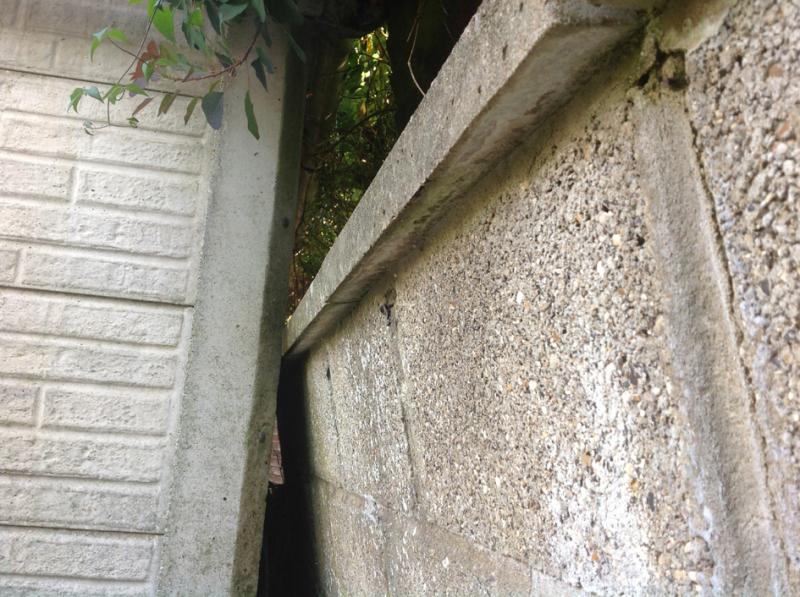

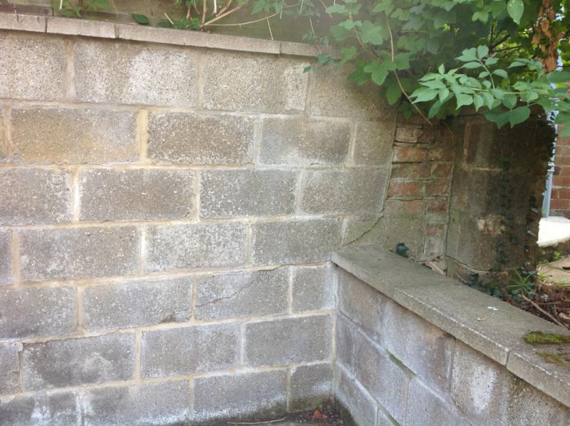

I've taken some photos of the wall. To the right of number 3, half way up the pic is our kitchen door and the oil tank is directly above the wall opposite the door.
Just realised I should have taken some photos of the access (or lack of it as the case may be). How we will get any sort of digging equipment in there (other than 6 men with shovels) I have no idea.

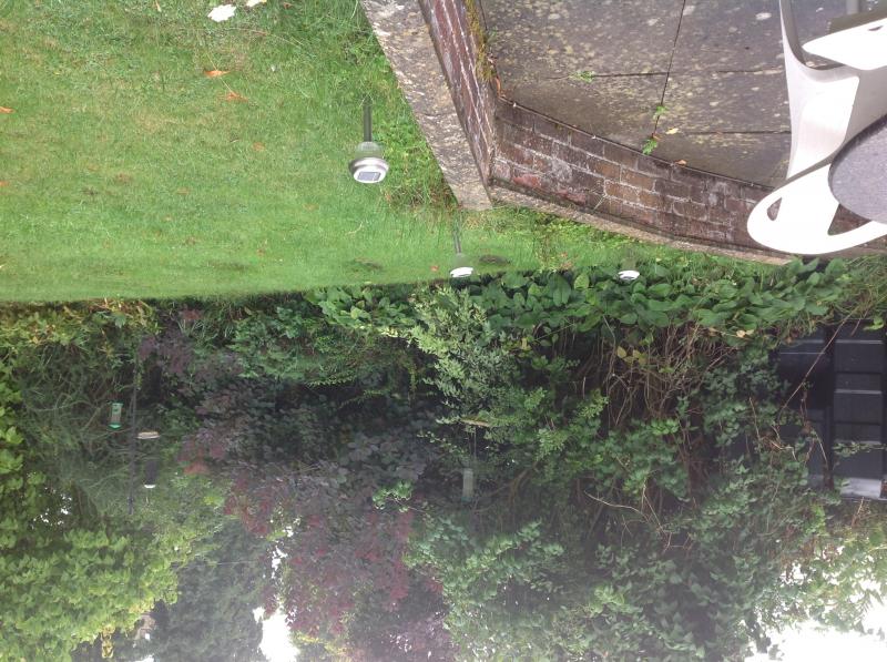

I have attached a couple more photos - I just can't seem to get them to orientate the right way, I don't have as sophisticated picture editor options as I have at work!
The one photo is of the wall from the down the steps out of our garden and the other is of the garden - as you can see, the shrubbery is well established so there is no view of the wall from that aspect.

Hmmm, Doesn't look as bad as your first post made out.
I would personally consider building a new wall in front of it. But then build maybe 2 piers out from it and use them and the new retaining wall as three new walls for a new shed. You would need to ensure your drainage is managed properly though. If you stick a drain pipe at the bottom of the void between the two walls then fill the gab between them with gravel you should be ok (end of drain pipe coming through wall at both sides).

Do you know what your soil make up is? if it's gravely sandy soil, then there is a chance that the old wall could blow quite quickly when the shed is removed. Clay, especially stony clay soil will generally take a long time to move under its own weight. In both cases, if the ground is waterlogged, or if you've had heavy rain in the past week or two, your wall may be acting as a dam and I wouldn't advise disturbing it at all untill the soil has had a chance to dry out. This could be the reason your original wall failed as I see no weep holes.
