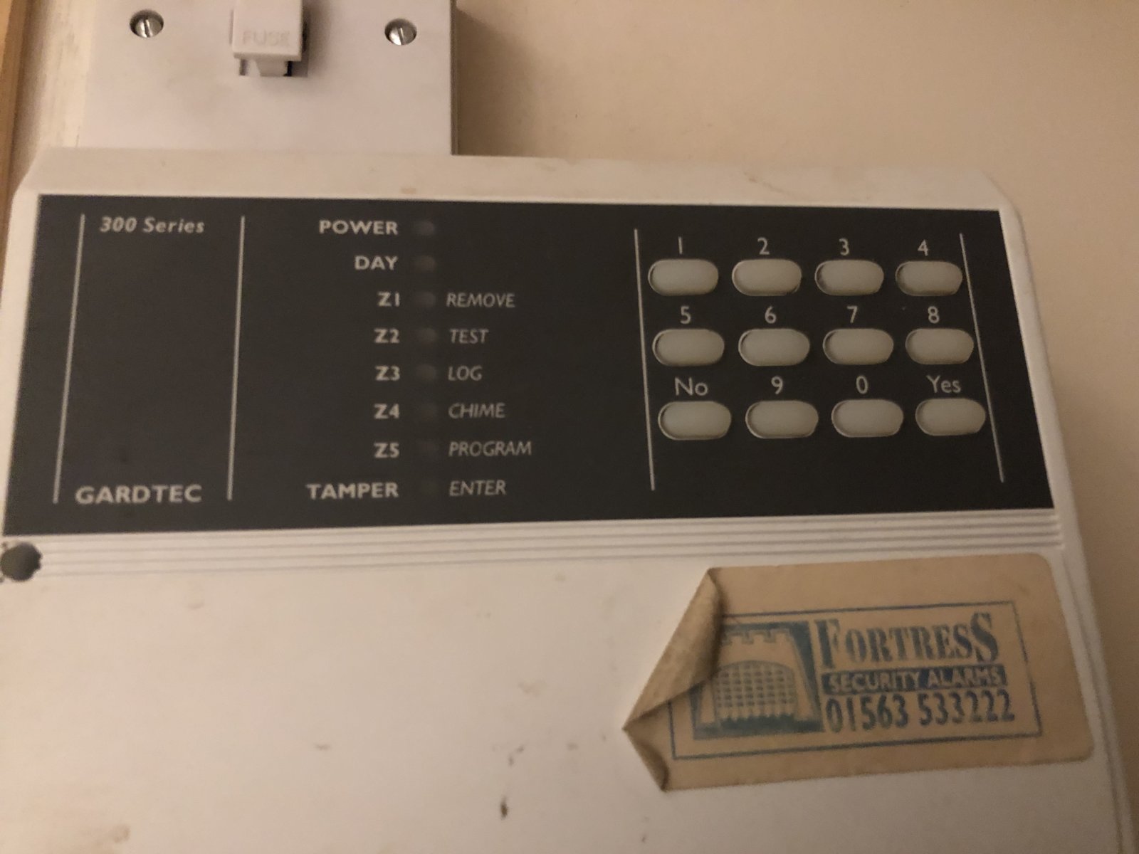

Hi, we have just moved into a rental property with a Gardtec 300 alarm system. I asked the agent about the alarm and he said it wasn’t a working alarm and knew nothing about it. There was no power coming to the alarm, so I checked the fuse box, nothing was there, so I inserted a fuse. Power light and LED day light is on but nothing happening. I have tried entering the master code but not doing anything. Can anyone suggest what I need to do to get alarm working.
Do the keys bleep when you press them ?
Post a picture of the alarm as there where a few different panels in the 300s series
Hi

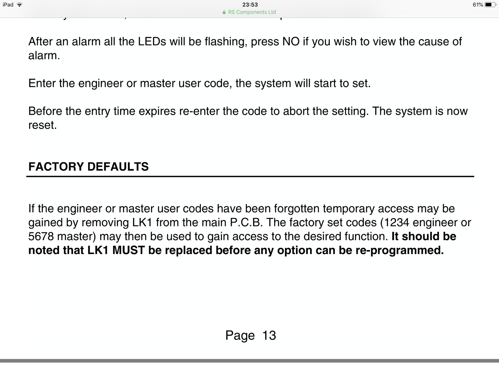

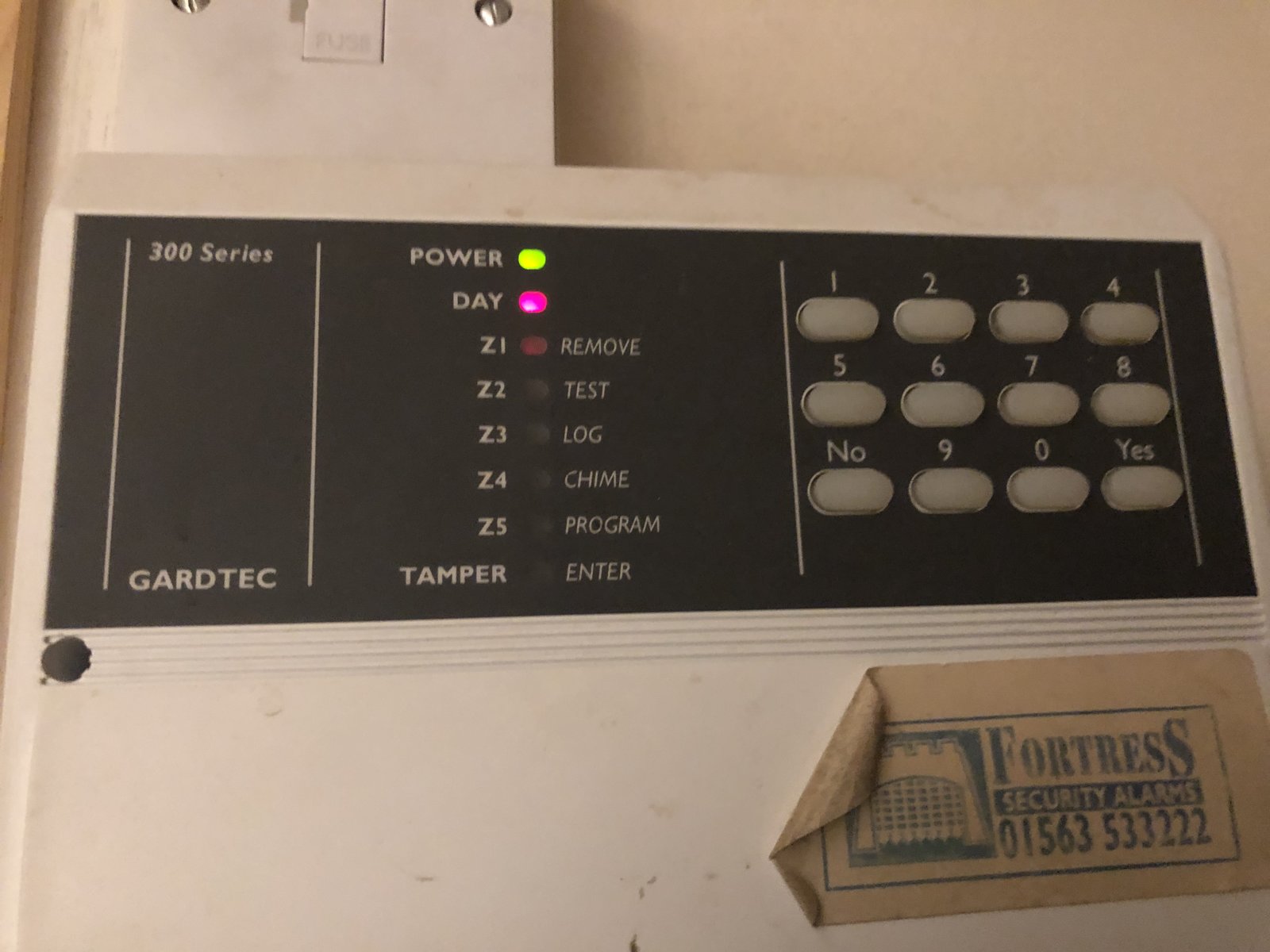

Hi and thanks for getting back to me. Yes the keys beeps when you press them. I have attached 3 pics. 1st with no power, 2nd as fuse is pushed in and 3rd system as it is once power is on.
Thanks for sending this over. We managed to get something when we typed in what you sent. We moved down to programme, but now power, and tamper is flashing while programme is steady.
