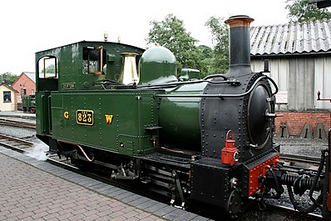

My front kitchen I get nearly a bowl full of water before the hot arrives, and mothers house with a combi boiler DHW would start cold, go hot, then cold again, and finally hot for the shower as the reservoir of hot water in the boiler was depleted and then the boiler finally caught up. Which gives on an idea of how much it takes to heat the boiler, at work referred to as cost of a match, the cost to get boiler to temperature before it does any work. OK the boilers are bigger 1727523655043.png but same applies, cost to get boiler to temperature, so how much DHW is used per day matters.
