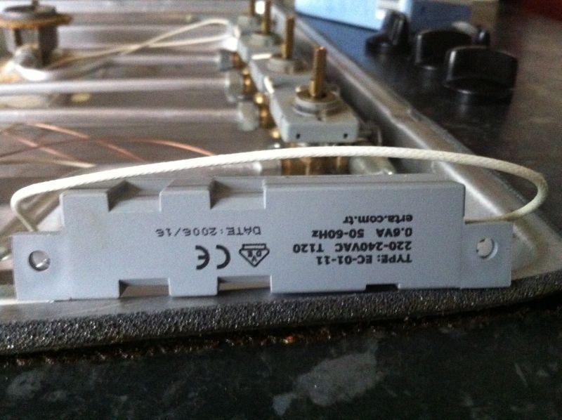

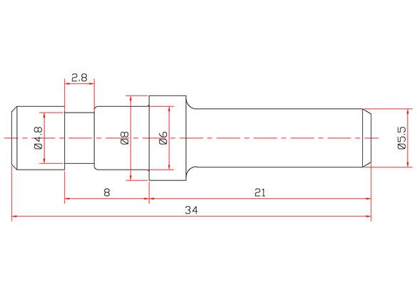

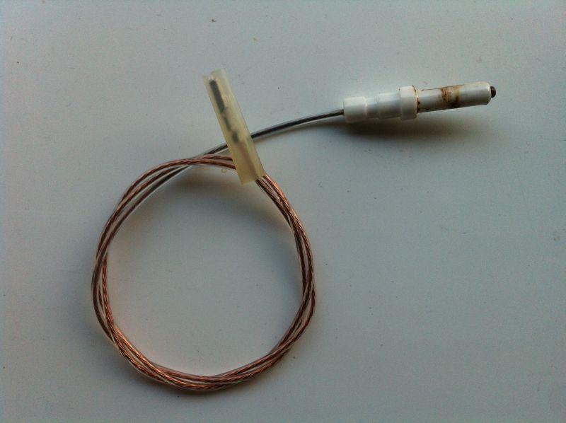

Ceramic on one of the ignition electordes has cracked, and as a result, spark goesn't get in appropriate place and gas is not fires.
I have opened cooker and dismounted an electrode but have no clue where to buy a spare one.
I'm attaching two images. One with cracked electrode, and one with a ceramic part spec I have found on the website of the parts producer.
http://www.erta.com.tr
If you know where this kind of spares can be found in UK, could you let me know please.
Appreciate for any advise.

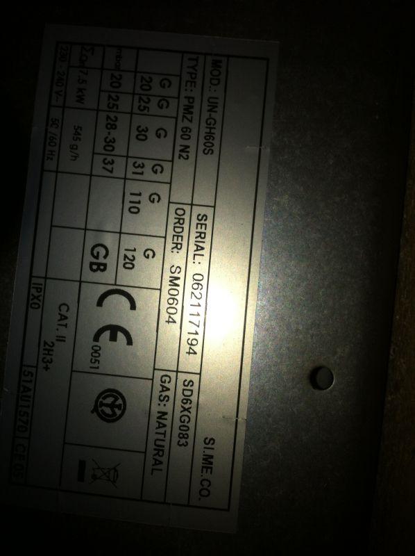

No name, that's confusing me very much. I didn't buy it.
Maybe more images will help.
However, oven has some weird name on it - "Kompact" but it's a separate unit, its electriclal and I guess it doesn't relate to the cooker somehow. Am I wrong?
Sorry but that label means nothing to me, however there are several similar looking ignitors here http://shop.ukwhitegoods.co.uk/Hob+Parts/Ignition+Parts.htm,( click on the "ignition parts" icon) if you want to take a risk they are not particularly expensive. Alternatively you could give them a ring & see if they could tell you if they are compatable or give they could give you dimensions of the new ones. This is a long shot, but the only clue on that label is the SI.ME.CO bit that makes me think of China & therefore Hygena, I may be totally wrong though.
