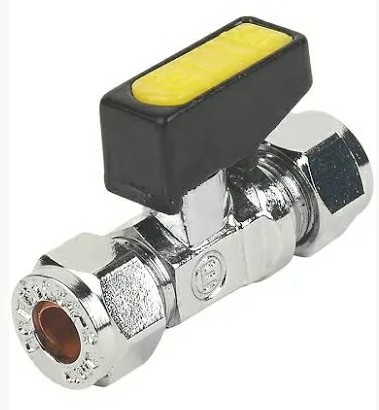

We have a gas fire that was fitted a number of years ago by a gas safe engineer, never had an issue when serviced in the past.
Today we had it serviced (different engineer) and was informed that a gas restrictor valve should have been fitted instead of a gas isolation valve!?
Is there a fundamental difference between the two and should a gas restrictor be fitted instead?
Pics attached

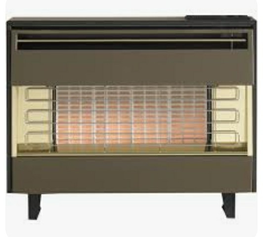

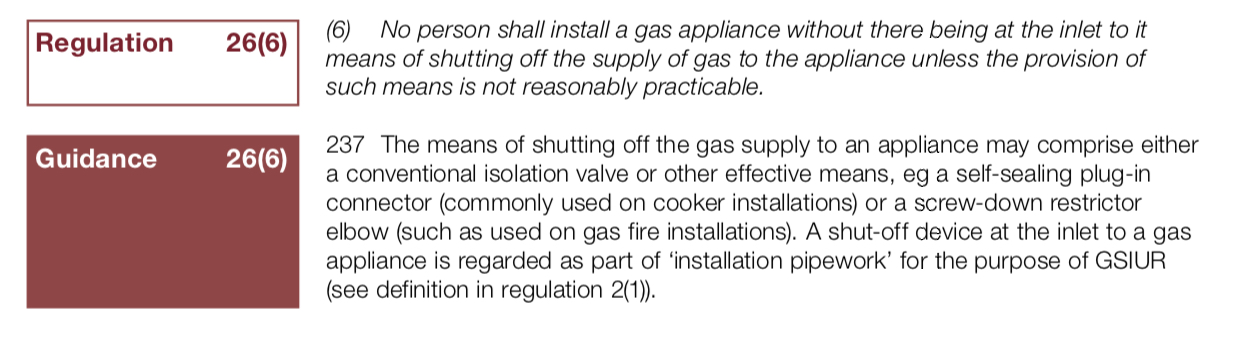

If your fire is the one in the picture (Robinson Wiley firegem visa), then I can’t see it in the instructions, and the attachment shows the stance in the gas regulations.

As suggested, there isn't really anything in the regs that say it can't be used. A gas tap valve may be easier to tamper with/get knocked they can be used as a means of isolation. Would a restrictor elbow be more tamperproof and secure, possibly but no rule that says a valve tap couldn't be used.

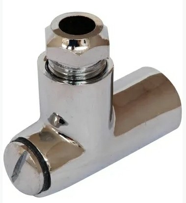

The only thing I would add is that a restrictor elbow would be the usual thing to find screwed down beside a hearth to bring a 15mm gas pipe out from the floor and reduce to a 8/10mm chrome feed for a radiant fire, would usually be what I would fit and would be much more secure than a loose pipe with a valve on it.
In our case the pipe is not chrome, it is 8mm copper pipe

always hated restrictor elbows and the pipe on view to the fire. always tried to hide them.
restrictor elbows serve a purpose and the associated pipe work is more robust than copper weaving its way over the hearth etc, plus it looks like it belongs there. its the way it used be done.
personally i hide all my pipes and wires where practical, i'd use either of the isolators depending on the installation requirements.
