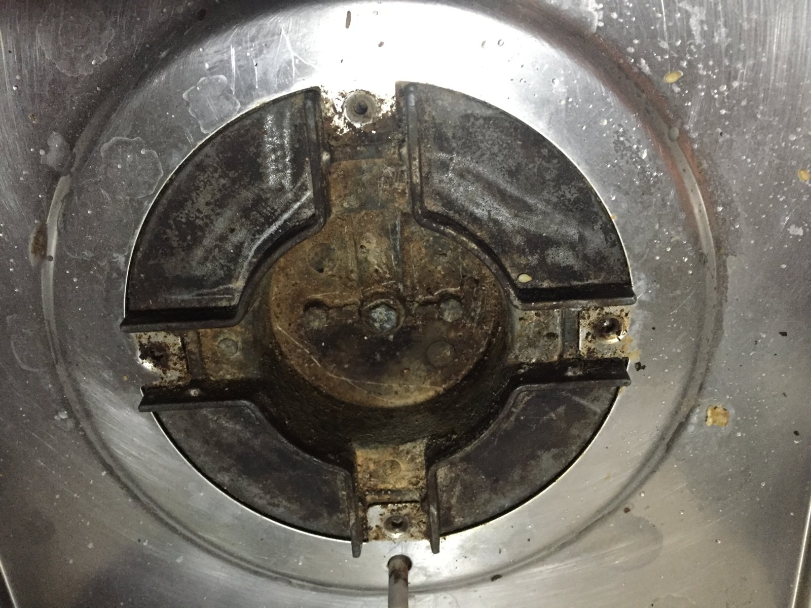

Our gas hob is not working so well.
The big central burner is giving off a very small flame, and one burner is dead. We still have 3 working.
Can this be fixed or is it a case of getting a new one in?
There is a photo of the main burner included.
I have now , but not today.
Been poking a needle into the hole in the middle and i think that has helped.
Got the other one working.
Looks like need to clean these burners more often.
The gas supply has small impurities in them? Sometimes they can get stuck in the small injector holes. Fine needle or pin wiggled in there normally unblock a it. Don't force it through ad with some fine injectors this can increase the diameter of the hole.
