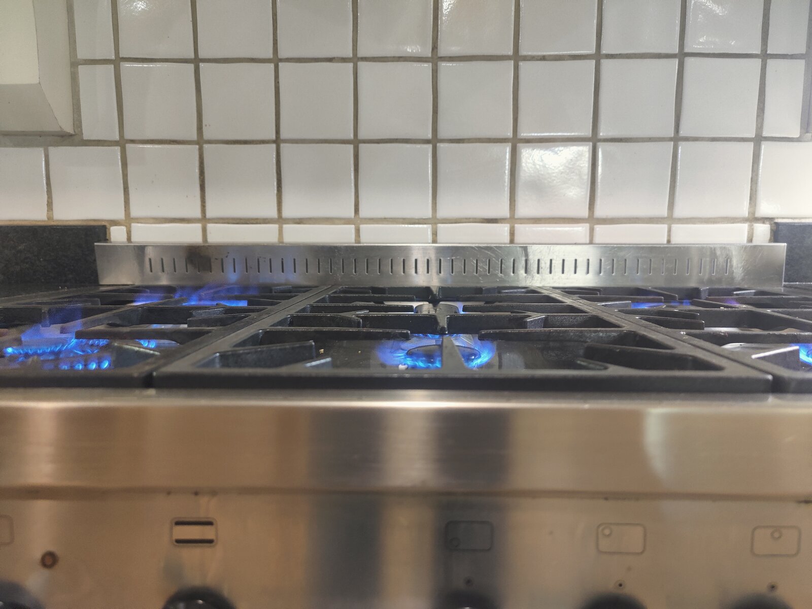

I've just moved into an old property which has a gas hob feb by two gas bottles (medium - not tall ones) and a switch-over valve + regulator.
The flam on the hob is very low - lower than my previous mains-fed hob.
Could the regulator be out and not enough pressure? Is the only way to get a plumber round and test the pressure or is this normal for a bottle-fed house?

So I can light all burners and the flame does not waiver so the regulator can get enough gas out. Maybe these flames are normal.
+1, nothing wrong with them by the looks of it. If you're at all unsure, get an LPG RGI in and get him to do a pressure test, that way it can be confirmed that the cooker is getting 37Mb
Thanks chaps (chappets?)
I noted the smallest of the flames did not change when all the big ones were on so assume OK too.
