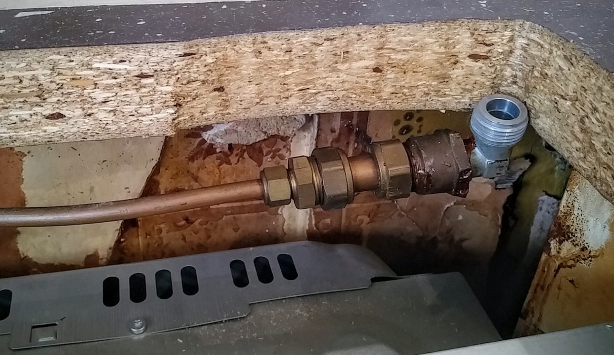

The last time the gas hob was changed in my house was approx 15 yrs ago
Here is the current set up
What I wanted to know was whether the current setup complies with current regulation.. or will I need new parts when the new hob is installed?
It doesn't look a great install with all those adapters!
Is there an isolation cock on the pipe work in the immediate vicinity of the appliance ie in the cupboard adjacent or behind the oven , if not then that wouldn't pass for an ACOPS approved installation.
The gas safe engineer that installs the new hob, will be able to assess whether the pipe size and fittings are suitable and whether there should be a local isolator installed.
cheers guys
all sorted.. got an isolator installed too
