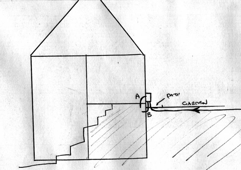

Having garden and path dug up and new meter fitted to front of house. No say in the mater, and it'll be an eyesore. It's a split level house, so the meter, by the front door, is half way up the house.
They intend going through the wall (after the meter) into a room, then down through the floor of this room into the 'cellar'. This is just a room (my office) thats got no windows and is mostly underground. The boiler is in this room and they can put a T into a gas pipe that feeds the boiler.
My problem is... why can't they dig down (in fact they already have, to feed to meter from the road, under the garden) and just go straight through the wall into the cellar, instead of going through the upstairs room?
When I asked this I think he just said 'can't be done'.
So..is it possible to have the pipe from the outside gas meter going down about a foot into the ground, then into the house? If not, why not? Why is it possible to have all the gas pipes underground, except for from the meter into my house?
I think I've made it sound complicated, when it's simple!

I'll see if i can draw diagram.
from what you say, the room is underground with the garden up against the wall. If this is the case that wall will have some sort of waterproofing. If the pipe entered the room below ground level it would be impossible to maintain the integrety of the waterproofing
That's exactly it. The wall is (probably) underground. I say probably because it's hard to tell exactly where the top of the cellar is, in relation to ground level. I post a diagram.
Can the pipe not enter the house underground, even only inches? How do other pipes enter the house if not underground? How does the current gas pipe enter the house? Under the garden, and below ground level. I'm sure.
I get the idea that the gas men are just looking for the quickest way. Why should I have a gas pipe enter front room through the wall, and disappear through the floor?
I'll post pic now...
'A' is the way they want to do it. The floor of the upper room is definitely above ground level, but obviously there are joists etc.
Does everyone who has a new meter fitted have to have the pipes going into a room?
gas pipes going through walls, have to, by regulation, go through a sleve in the wall. If this was done at position B in your sketch, you would have dampness/flooding problems in the cellar/sub surface room
Well, it's been done. They did it my way, going down outside, but didn't have to go far, the top of the pipe is flush with the ground, or will be when they fill in the hole. Let's hope they've done it properly and I don't get damp problems.
