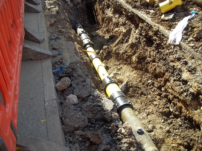

This was a live gas main in the High Street. It was "sealed" by the clay soil. This seal was lost when the trench for the new plastic gas main was being dug. Rapid reaction by the staff got a temporary seal over the hole.
Over night the failed section was replaced without any loss of supply. A bypass pipe was fitted before the corroded pipe was replaced with a short length of plastic.
