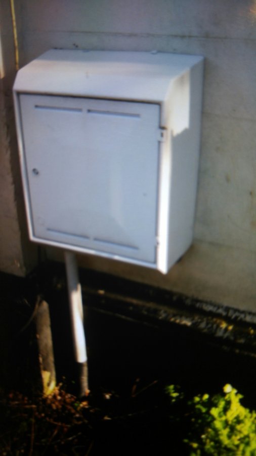

I have a question regarding the movement or rather non movement of a gas meter.
My meter is connect to a courtyard wall at the side of my house, this wall is due to be demolished and rebuilt with a block cavity wall.
National grid have said that i have to have the gas supply disconnected and then reconnected when the work is complete (this is very expensive) the alternative is to move it (temporarily) then move it back when the wall is rebuilt again expensive - finally could just move it and live with the new location cheapest option they offered.
A builder has suggested supporting it whilst the wall is carefully demolished and fixing it back on the new wall when complete.
Is this a viable (legal option).
Thanks for any constructive posts

Just so you can see the meter, the wall about 10 cm to the left of the pipe is staying. The wall on which the meter is located will go and be replaced.
