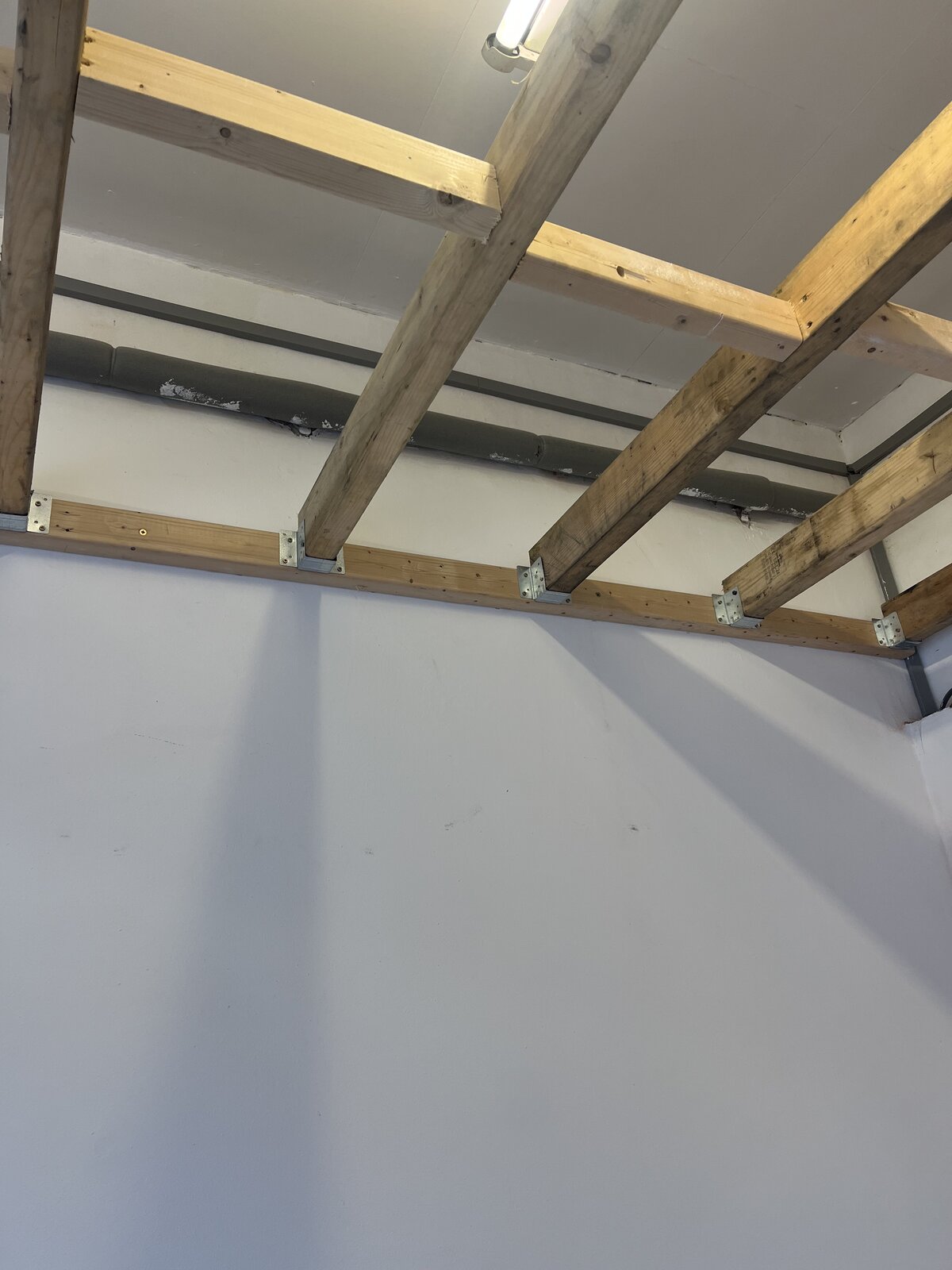

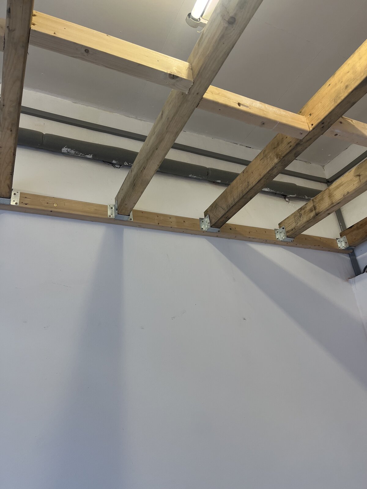

Hi folks,just putting a false ceiling in the missus salon,but as you can see in the pic,there will be a 28mm gas pipe in the void which is going into the chippy in next shop.what vents will need to be fitted in the ceiling(size and how many).cheers
Sorry forgot to add pic

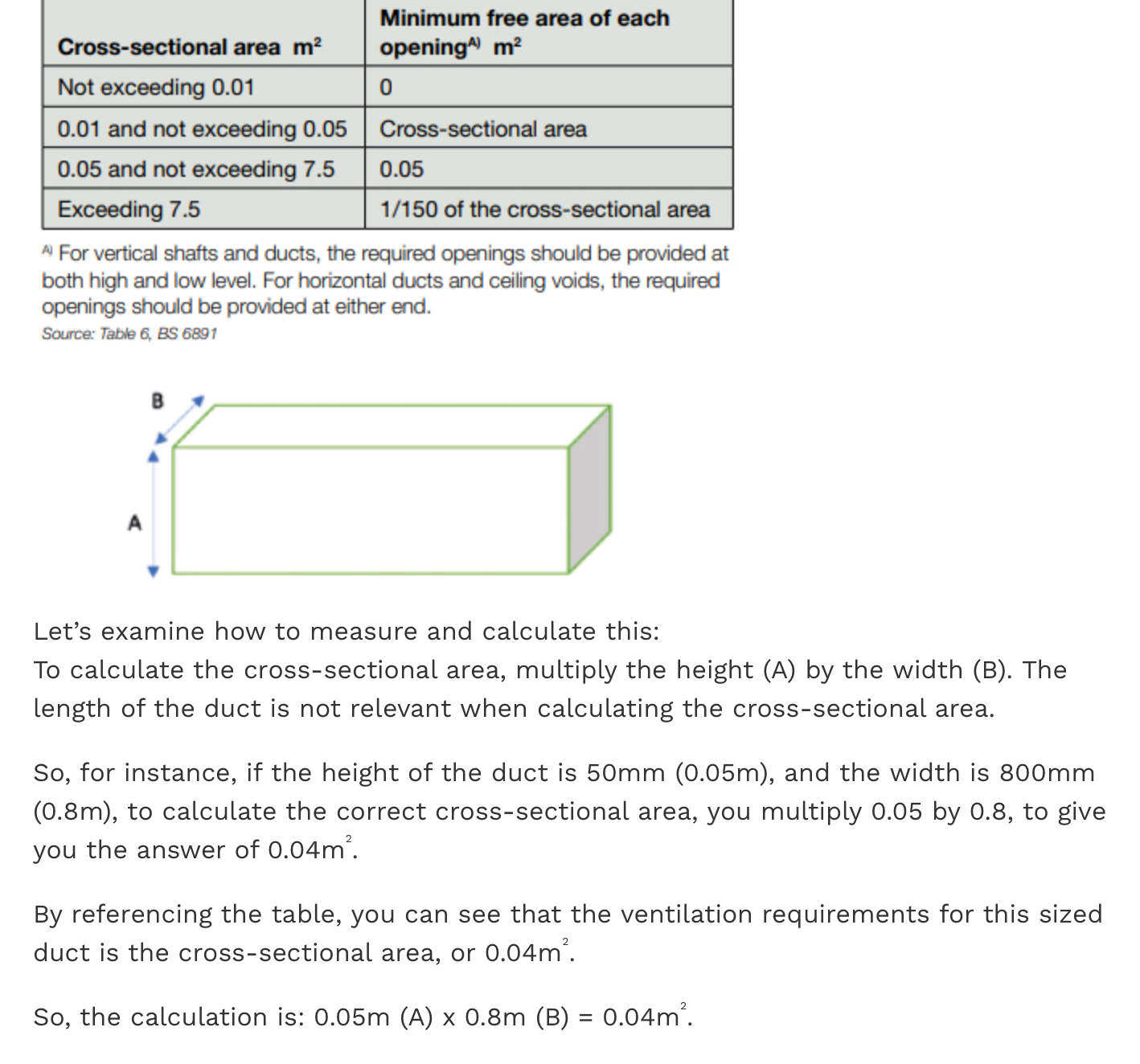

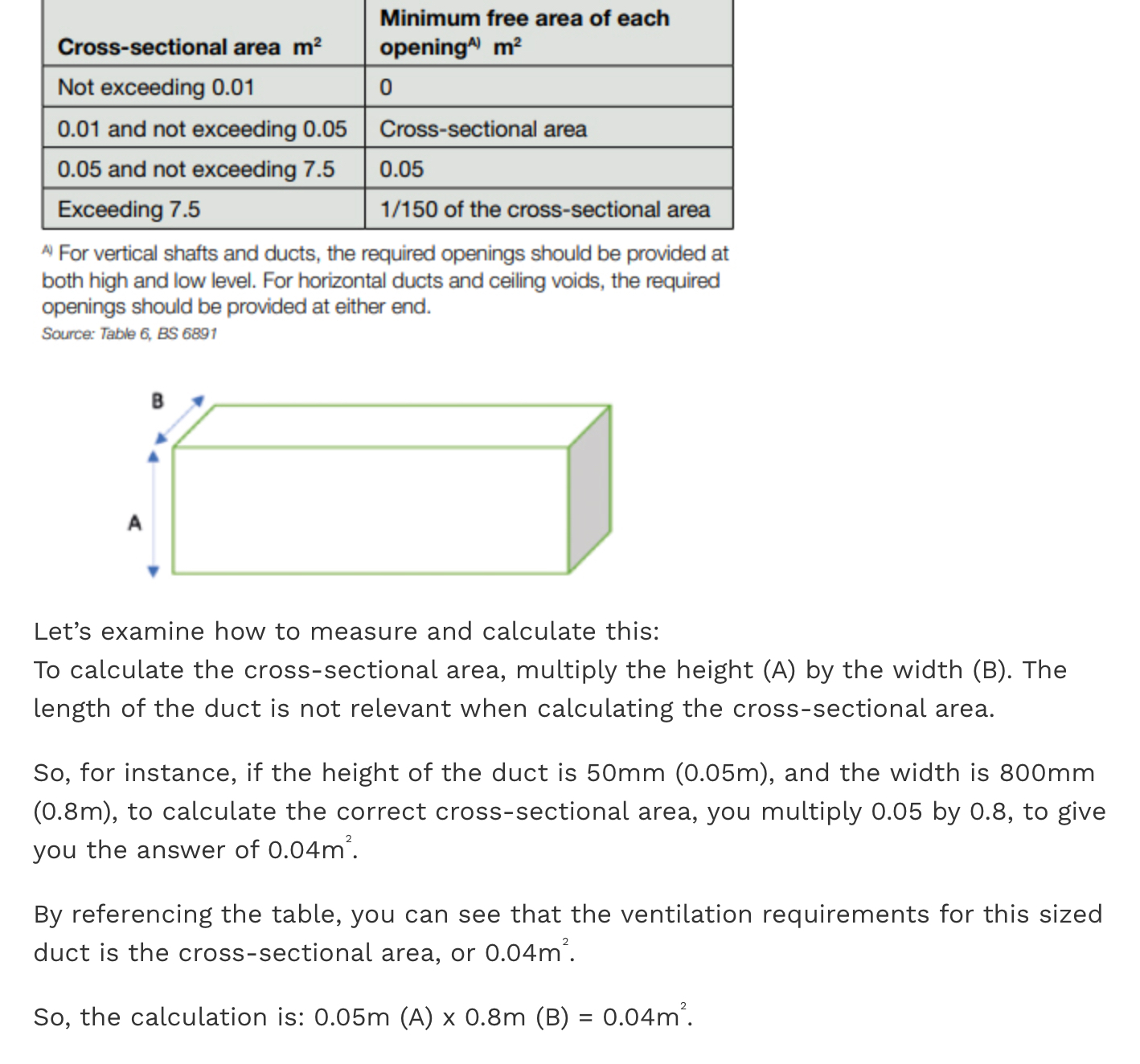

Try this
I’m getting 0.15 with my calculations.would that be correct with the measurements.
