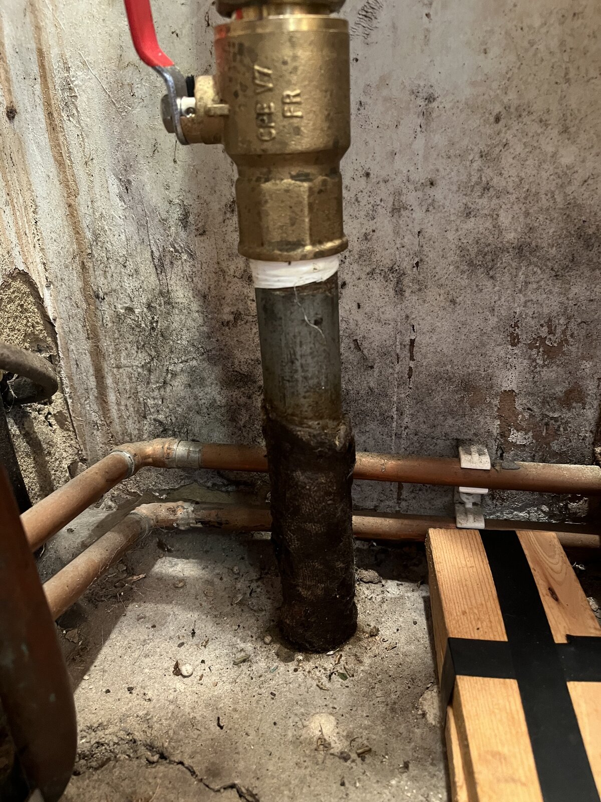

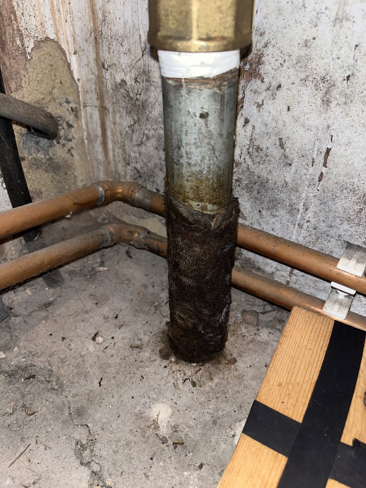

Hi, does anyone know what this material is around the gas pipe that comes into my house? It’s brown/black and quite sticky. Anyone know why it was used? Gas leak?

Denso tape I guess, maybe gas engineers use something more specialised.
It’s used to protect pipes from rusting if it’s galv or from corrosion if copper - which I think is damaged by cement.
Denso tape is really horrible stuff to use

Thank you. Does seem to match Denso tape from a quick Google (hoping it was not some kind of asbestos wrap).

In the past, I have encountered IP electrical junction boxes in flower beds wrapped in denso. No idea if it is the correct product or not.
Looks like Prem50 "petrolatum" impregnated tape. Darker than denso which is putty coloured, otherwise similar afaik.
Lighter fuel or WD40 should clean it up.
