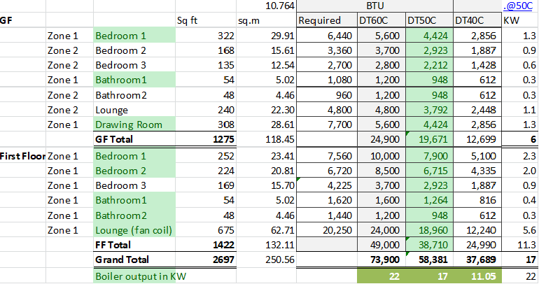

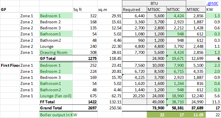

Sorry, I have 13 radiators in total; ones highlighted in green are used frequently. Rest I keep them off and put into use when I have a need for them. A large fan coil unit is occasionally in use as well. I would be grateful for any advice on an efficient system boiler (will add DHW to it later).

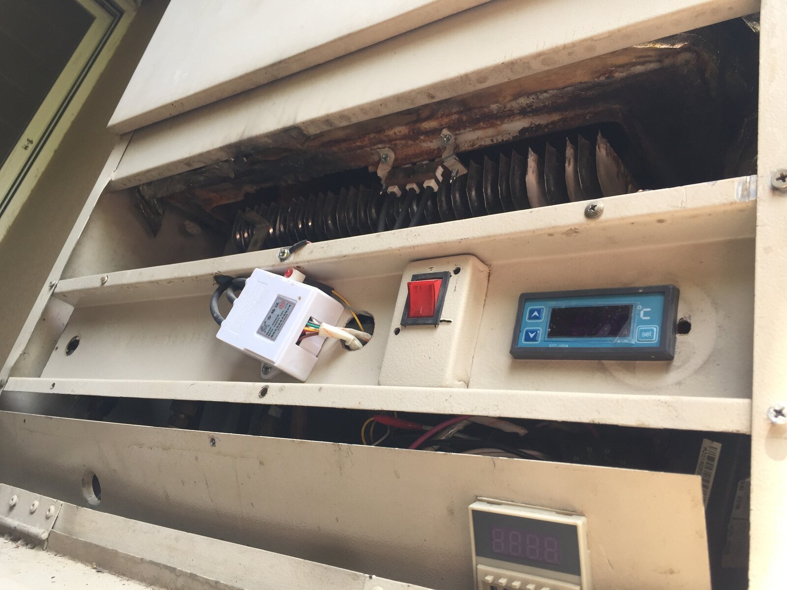

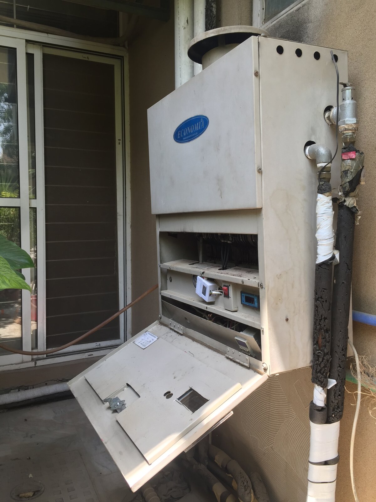

I have attached a picture of my locally made boiler (CH only) which was installed when I knew nothing about boilers (still don't know much!). It is rated as 35kw/120k btu but its efficiency will be much lower even if it is true. It has 13 radiators attached to it; 4 (1.5kw rads), a fan coil unit (3-5kw), 5 medium and 4 small bathroom rads). It does a decent job of heating the house running for 10-12 hours daily. (6 hours in morning and 6 in evening). I have logged its gas usage so I know how much it consumes for central heating; 1.1m3/hr with 8kw load.
What worries me that even after changing an old boiler (outdated and inefficient in my view) I may not be able to gain in terms of gas usage. I would be grateful for any guidance on efficient boilers in the market that can outperform my existing one.

8 kw is the minimum load that is on this boiler on regular basis. From the attached spreadsheet, I have calculated kw of radiators; 2kw for double panel larger ones and 1.5 kw for large single panels.

Based on my calculations of mean water temp of 50deg C my requirement is an 18kw boiler for all rads? I hardly ever use all rads but 8kw is minimum load that will be on this boiler.
