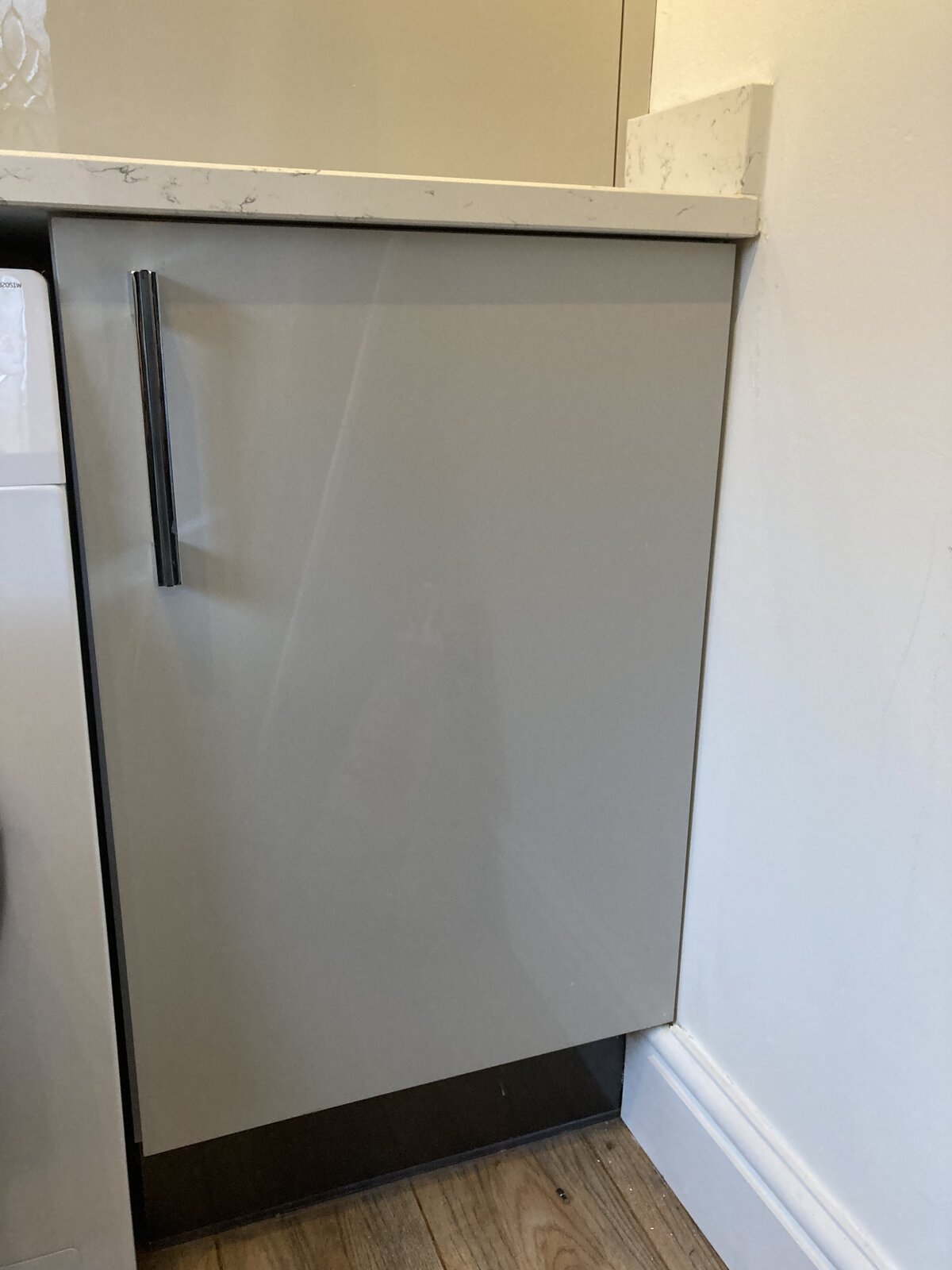

Hello all,
I have attached a picture of my current gas meter . My supplier is due to install a smart meter but I want to foresee any issues. Obviously access is a bit tight but wondered if it’s possible to fit the smart meter without ripping out the cupboard.
Thanks for any inputs/help

Access to the valve needs to be created .... like ..... yesterday!! What was the kitchen installer thinking! Probably wasn't actually!
Blimey. That looks like one of those old ones than can be spun round to run backwards. ;) You will need to be able to turn the gas off though so get that emergency control valve located. Pronto!
Erm, where's the emergency control valve (ECV) and is there unfettered easy access to it?
I don’t know, so probably not. I imagine hidden away behind the cupboard? N

I just went in there again. Back panel slides out easily and the ecv is there for access. I could leave the back panel removed and there would no barrier to the ecv
Regarding the smart meter question, will my installer go with this or avoid like the plague?
The new meter will probably be smaller so the engineer will have to fit a meter bracket and floor stand, by looking a the picture the hole in the bottom shelf doesn't look big enough to accommodate it.
