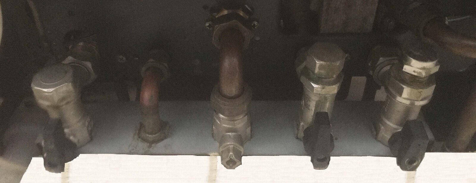

Am I allowed to close the valves for the feed and return under the boiler, drain the boiler down and change the system NTC. I would also like to check the pressure vessel is at 1 Bar at the same time.

Using the X800 for 8 hours or the X400 for a few weeks I will need to flush the system and get rid of any chemicals and sludge. My Baxi Platinum has a 22mm blanking plate underneath it for the feed pipe and a 15mm plate on the return pipe.
If I turn off the feed valve, return valve and all the radiators valves except a small radiator downstairs, I can drain the water out of that radiator and the 8mm microbore pipes taking the water to each radiator via a manifold.
With that done I am hoping I can remove the 15mm blanking plate and fit a 90 degree 15mm to 10mm compression reducer and a 90 degree 22mm to 10mm reducer on the feed pipe.
I can then close the drain valve remove the hose pipe from it and then connect one end of it to the return under the boiler and put the other end in an outside drain. With the garden hose fitted to the 10mm feed connection I can turn the outside tap on and have water going to one radiator via the feed pipe and coming back and in to the drain via the return pipe.
Once I have clear water going it to the drain I can turn off the tap and both valves on the radiator I have just cleaned and open the valves on the other downstairs radiator and repeat the process. Having flushed all the radiators I can swap the two hosepipes under the boiler and reverse flush each radiator.
Lastly making sure all radiator valves are closed and opening the valves under the boiler for the feed and return I can flush and then reverse flush the boiler.

Can I suggest that you are very careful, flushing a 8mm piped system is fraught with risk.
I have experienced more issues when flushing an 8mm system than any other purely down to the narrow bore of the pipe. If any large pieces of crud that are attached to the larger pipework or in the rads gets into the microbore and gets stuck you can make the system much worse.
Only way I'll try to clean a microbore is to remove the rads, clean them outside and reverse flush the pipework from each rad valve, that's to minimise the risk that any solids in the system doesn't get into the 8mm pipe. That's after trying to convince the client to not bother and replace it all.

I replaced the old twin entry rads with double panel double fin rads about three years ago. So hopefully there are no large deposits in them. Over the years the system has had X400 in it from time to time. Before I put a bottle of X100 and X200 in the system I want to give the whole system a quick clean.
