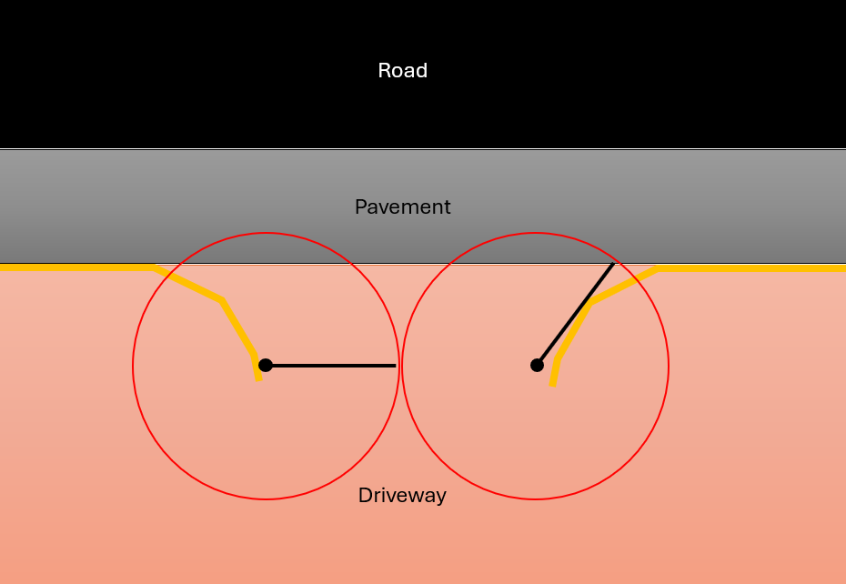

Hi all,
We have a very old (1800s) property that has double iron gates that open outward due to a rising driveway that makes inwards opening not possible. We would like to automate them for convenience (and security, as being manual we tend to leave them open).
All of the information I can find with google is centered around installing NEW outward opening gates and makes reference to Highways Acts and obstructing pavements and getting persmissions etc. Our gates have been installed like this (in various incarnations) since at least the 1950s based on old photos of the village. When in motion they do swing out in to the pavement by about 30cms but when closed or fully open they sit within the line of the boundary wall.
Obviously there is the safety concern and we'd be sure to get gates that have a stop on obstruction function, but other than that do you think we need to get any persmission to be able to automate these gates?
Cheers.

Yeah, I'm slightly different, in that they only obstruct the pavement and only when moving like in the diagram below. Altering the hinges is not really an option as the rise would need to be about 8 inches.
At this point the gates have been there for so long I can't imagine anyone is going to complain... how would they even go about it?!

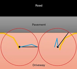

If that means you are thinking of buying new gates then you could consider fitting bi-fold gates
Depending on your local council's Highways Department you may be able to automate them provided that they can only be operated by a person at the gates and who is able to see that opening the gates will not create a hazard.
