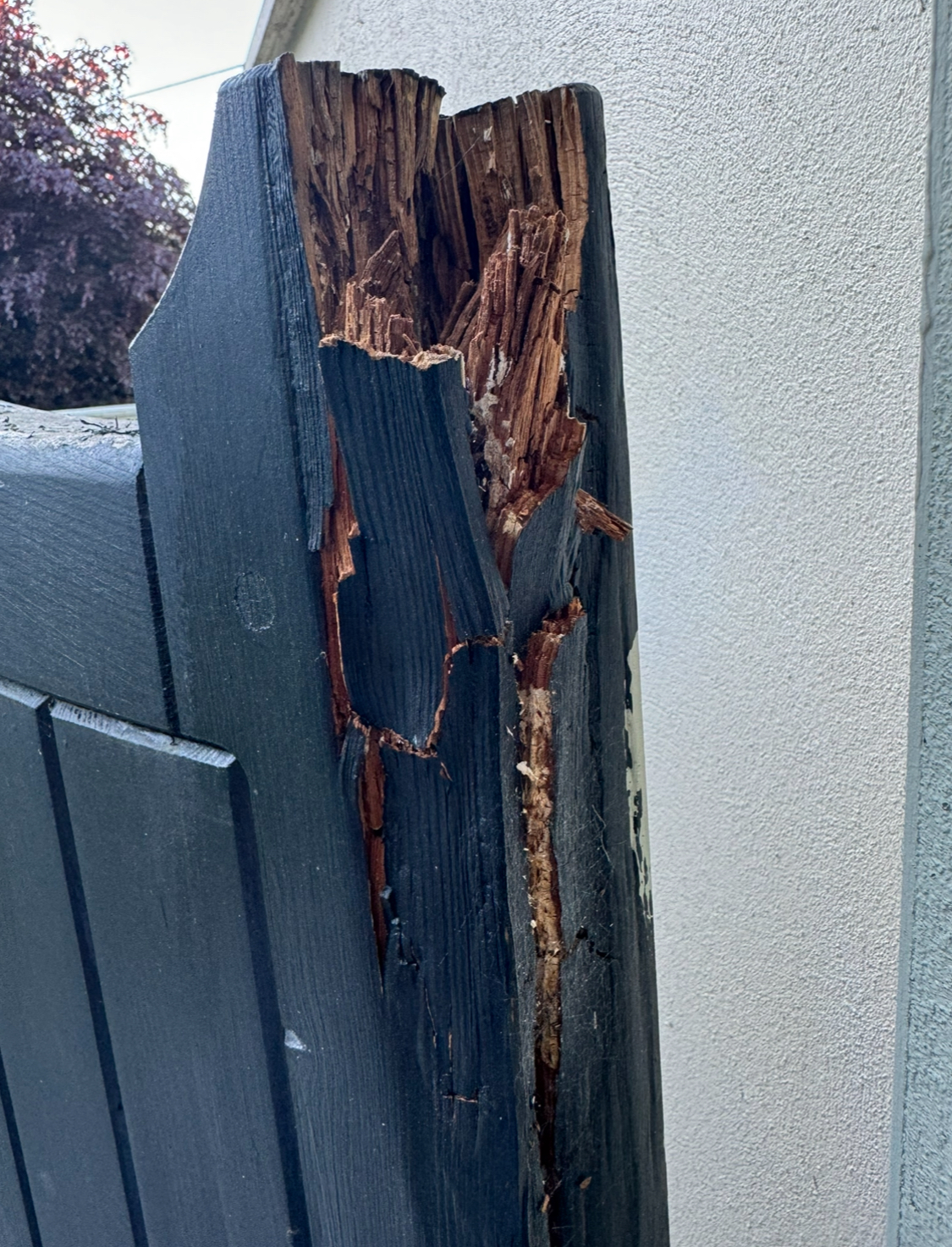

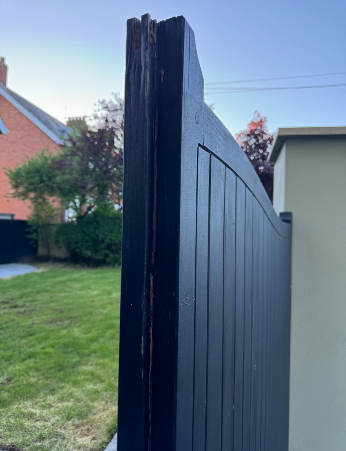

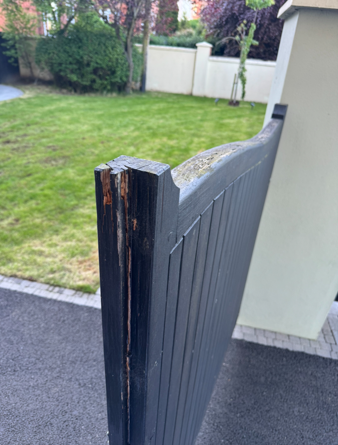

Hello. I’m not sure what kind of gate this is, it was here when I moved in but as you can see, it has started to rot. Is this fixable or would it be a new gate? It looks to be one fixed gate if that makes sense! Thanks.

It needed a cap on the top of the uprights, and more rounded on the top to stop water pooling there, just make sure the replacement doesnt make those mistakes
Thanks folks. That’s what I was thinking.
