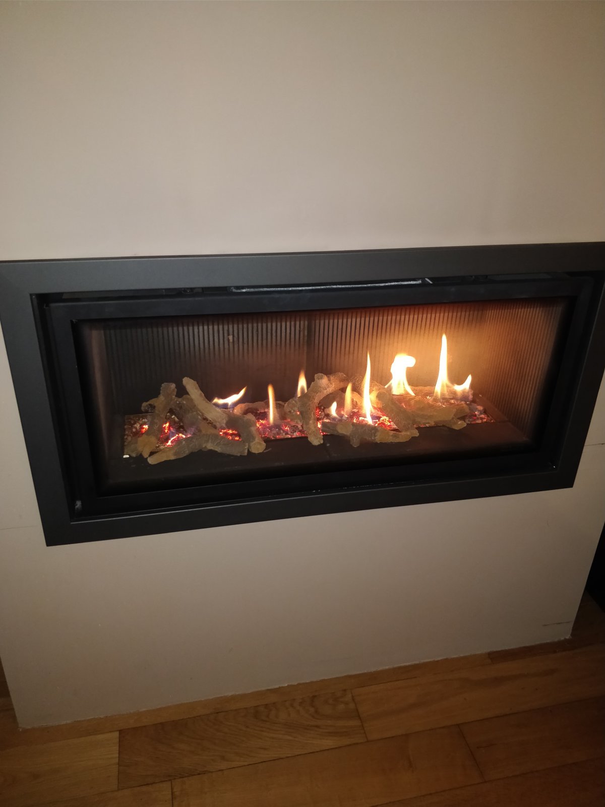

I have a wall mounted Gazco Studio 2 fire with a balanced flue.
The remote has a thermostat feature whereby you can set the required temperature and the remote control automatically adjusts the fire to suit.
Recently, if I have the fire in the thermostat mode, it will just completely cut out after a random amount of time - sometimes it will run for 45 minutes - sometimes it will run for 5 minutes.
If I just put the fire on the 'manual' control setting (i.e. the fire is just 'on' and then you are required to control the flames up/down yourself via the remote) then the fire stays lit all night without any problems.
I just wondered if anyone on here has any idea what the issue could be that could cause this behaviour?
Many thanks for any help you can give me :)

I ended up here as I'm having the same issue although I don't have the thermostat option switched on with the remote.
Just wondered if you finally got an answer to the issue?

I ended up going to the Gazco technical help people. They recommended changing the burner, the thermocouple and the sparky-thing. I did this and the fire has been brilliant since then.
I ordered the parts through their website. I have a mate who is a gas engineer and he popped in after I'd changed the parts to give the fire a sniff test and all was well.
If you're not confident changing those bit then I would just buy them from the website and then ask a gas engineer to do it for you as they are quite fiddly.
