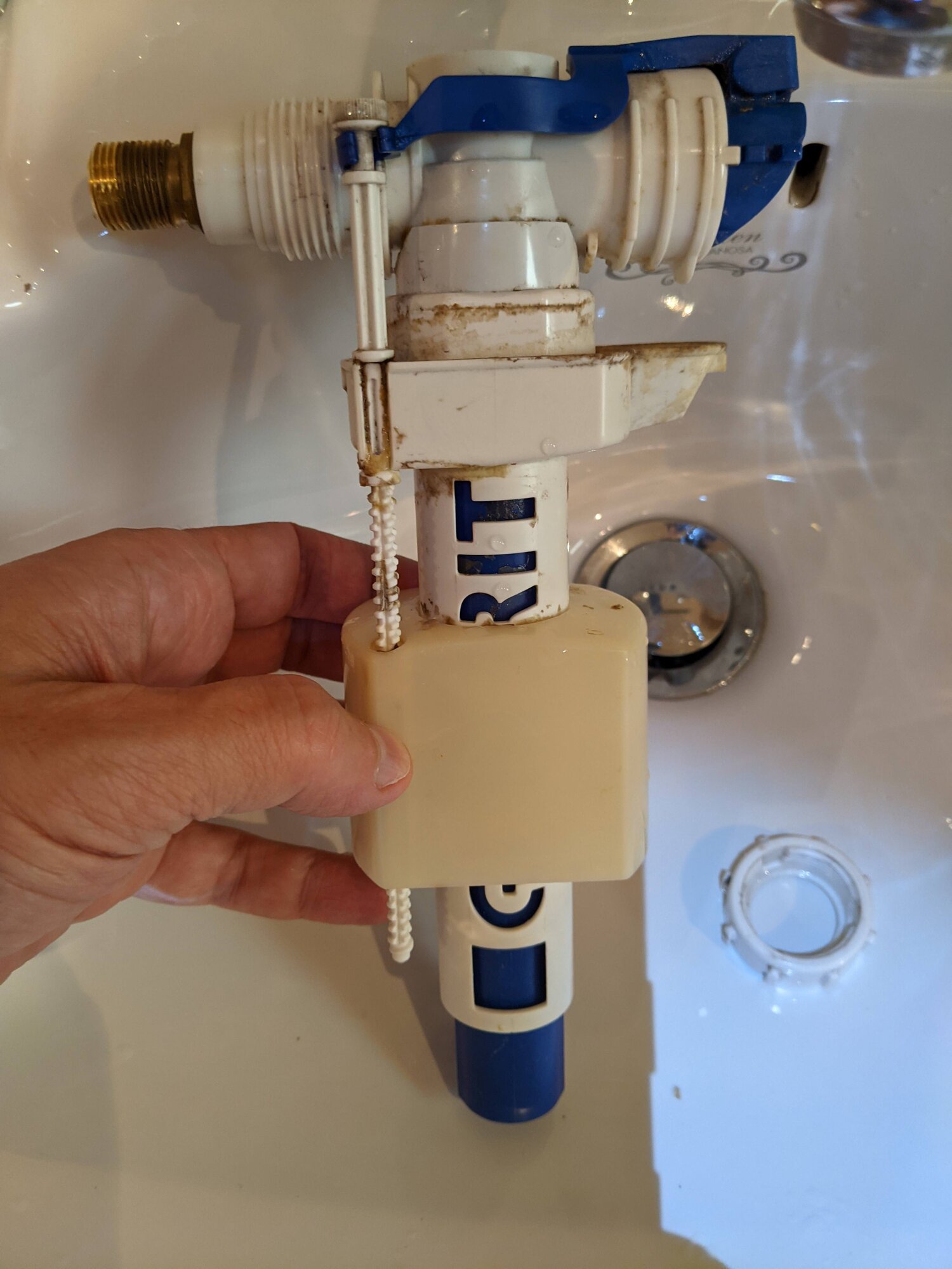

I have a toilet with concealed tank (tiled into the wall) and Geberit mechanism. It's gotten very slow to fill, so I popped it open and gave the mechanism and seals a clean. It made no difference.
I'm a little puzzled as it simply drip fills, regardless of whether the float arm is up or down. Water pressure in the supply hose is fine, I ran it a bit when disconnected from the fill valve. The diaphragm in the fill valve looks clean and good as new, but I cleaned it and the inside of the valve anyway.
