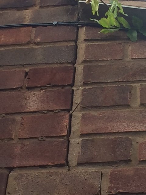

Hi all,
I have recently moved into a house (built in the 1960s) and it has a down stairs extension which we think was built in 1980's.
Now when we viewed it we noticed a crack between the main structure and the extension which runs vertically down the mortar joints.
We payed for a RICs home buyer surveyor who confirmed it was just general settlement and was historic.
Now since moving in I have become quite obsessive about this crack which I think is driving the other half mad.
What worry's me is, it is slightly wider at the top compared to bottom (max about 3-4mm)
Can someone please confirm that this crack is not something to worry about?
FYI - The top twig was already there and the bottom one I added.
Also is it worth refilling these cracks and how much do you think it will cost?

No, you'll have to wait and see. But it does look very old.
Fill it with silicone or a coloured polymer sealant for the time being.
If the surveyor is right, and it's historic movement, then all you need is to repoint the joints. If he's wrong, then you'll make a claim under your buildings insurance for subsidence, and then sue your surveyor for wrong advice. But as sealant would flex, you might not notice any further movement for some time. Get a couple of guys in to quote if you don't feel you're up to the job.

The surveyor is not responsible for any movement in the future. His responsibility was to comment on the situation at the time of survey, and he was most probably correct in his opinion.
That joint is expected to move and should have been pointed in mastic to begin with.

The twigs are for the OP to detect movement
You're looking for progressive movement, not seasonal movement or historical settlement. You can get special 2D Vernier things for crack monitoring or you can just take a series of dated photos with a rule in for scale.

I would not bother. You will see if it's getting bigger, and when you can get your little finger into it, then you make some phone calls.
The probelm with crack gauges and monitoring, is that if you are inexperienced then you will just get alarmed. Its not uncommon for an extenion to move up and doen or in and out over the seasons, and if you dont know that or dont know how much is normal, then you just get anxious for no reason.
Just fill it.
It wouldn’t worry me in the slightest ( if it’s only as the pic )

Chip out old mortar & push in new mortar

Even if it’s worse case underpinning situation ( I really don’t think it is) then it’s fairly simply dig out & fill in sections donkey work
Do t be worried or in fear of the what seems to be the mysterious & terrifying unknown lol
relax & enjoy your home ( fill in crack though as wet/freeze may also make it look worse through time
