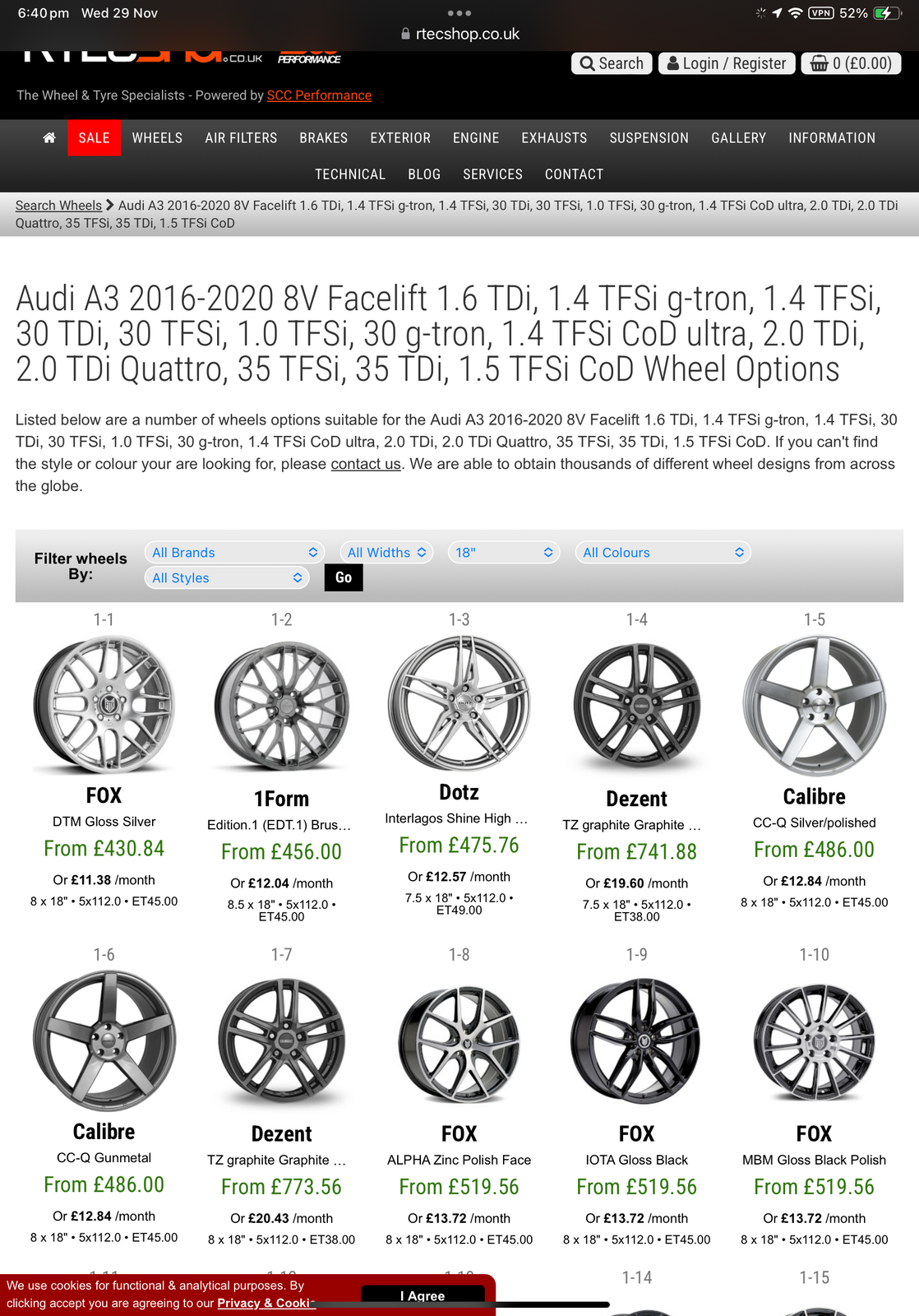

You'll also need to know the PCD and the offset, if you stick your car model into a website like this it should tell you what the PCD and offset is: https://www.rtecshop.co.uk/search_car_parts.php?search_section=wheels_full
That site tells me the offset on the wheels on my car is. 38, 45 or 49.

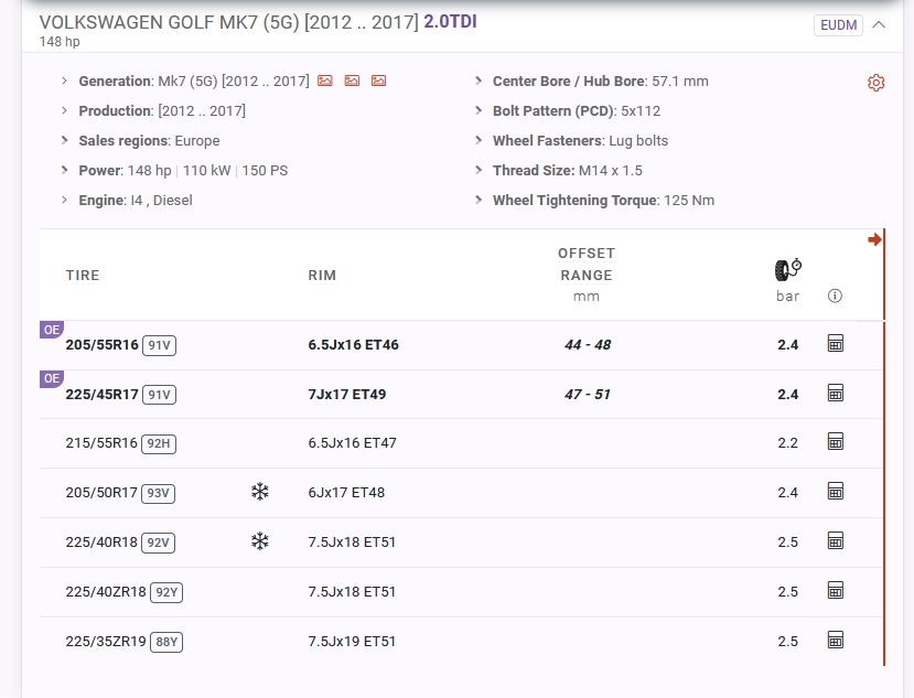

Mottie I think the wheel suppliers will offer wheels that will be within a tolerance still within the cars limits/specifications but I take your point. Anyway this seems to be a better site that tells you what the manufacturers original fitment PCD/offset is: https://www.wheel-size.com/
