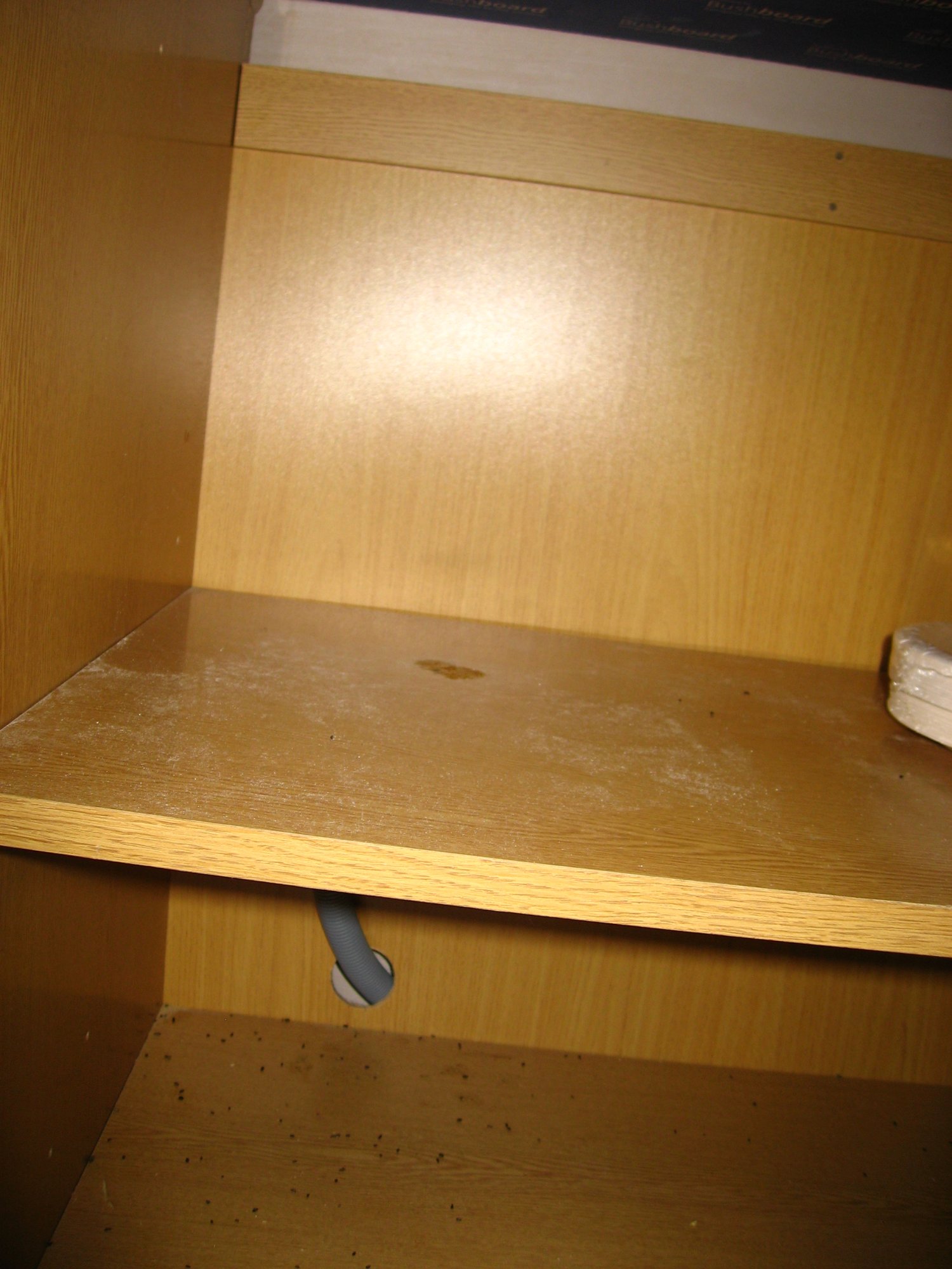

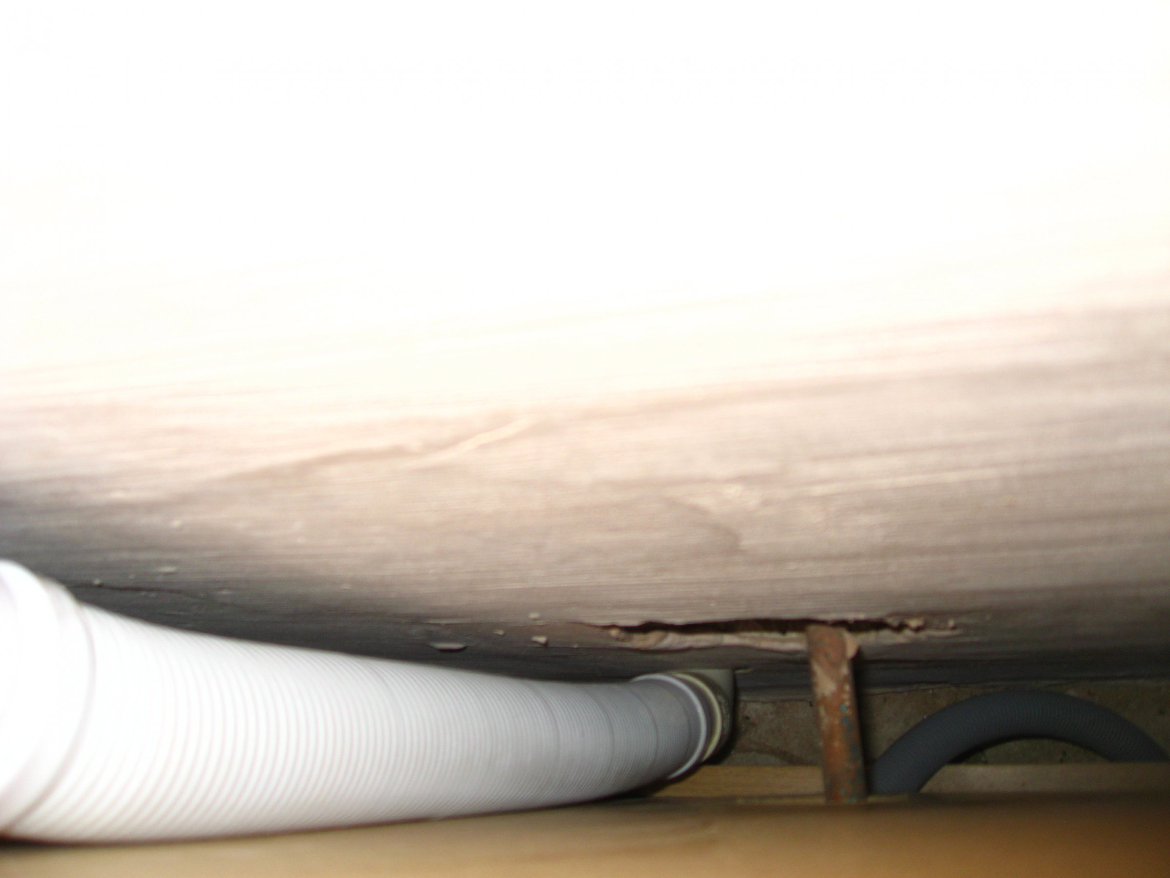

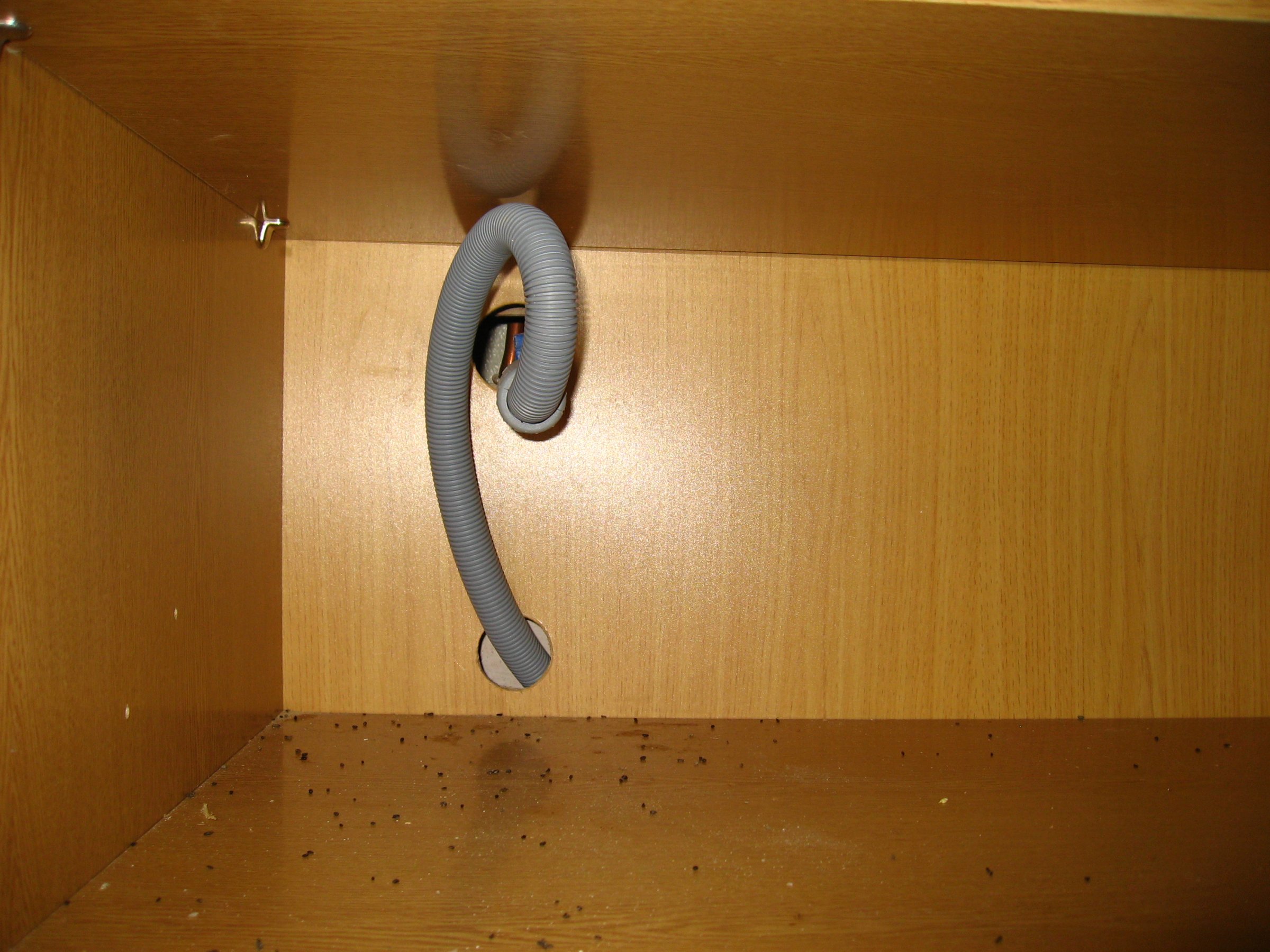

We have some mice coming in through a hole in the wall behind the kitchen cupboards, the dishwasher inlet comes in through a 6" hole (I managed to squeeze my camera down the back that's how I know that)
I can't get to this hole so it seems the only thing to do is to cut through the back of the cupboard, seal the hole, and fix the cupboard back somehow.
Unless there is a magic trick anyone knows of ????
(Where does this hole go to ? Well, on the other side of the wall is the bath in the bathroom, and it seems plumbing is descending into the neighbours flat below in the wall)

Question I have is how to get to the hole - I can't reach round.
I might try to pull the dishwasher out, that might be possible only worry is disturbing the inlet/ outlet.
If not looks like cutting into the back of the cupboard.

You should be able to get an expanding foam gun through your existing holes into the hole and fill with foam, pvc tubing can be used to extend the reach if required.
From personal experience, mice will eat through foam. We did try adding in brillo pads and then using foam around that. It's a temporary measure as once mice have a usual route, they'll try and follow it.

Cannot reach from the kickboard / plinth, but managed to wiggle the spray foam hose in through the existing holes and sealed it. Also found dropping in the attic and an area in the party wall with 2 previous spray foam applications and some dropping, so assume mice have been through this way before. Foamed that place up again, removed the droppings and will monitor.
