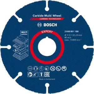

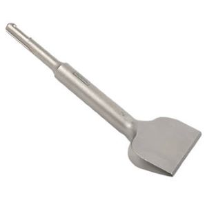

Hi all
I’m trying to take off the tiles in my shower and have done most , need to re plasterboard some walls now but the problem is half of a wall has concrete board under the tiles and won’t come off , what the best way of either getting the tiles off or cutting the concrete board, I can borrow an angle grinder , would that work with something tough to cut grout and concrete board
For getting the tiles off have you tried a SDS drill in hammer only mode and a cranked tile remover?
I've used the Bosch version for years. Works on a lot of stuff, although I have yet to try it on cement fibre board (which I presume is what you mean by "concrete board")
Alternatively these discs will cut cement fibre board and a lot of other abrasive materials:
Obtainable from Toolstation. I was buying them last year to cut-out ventilation duct openings in 15mm cement fibre board screwed onto 18mm OSB. Went through both in a single cut on a basic cordless angle grinder. BTW the older blades were black, not blue (in case you get old stock). They are tough, but they won't last forever.
