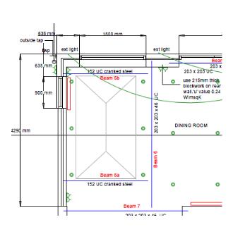

can you post a drawing of the structure? or perhaps some of the figures?
The figures have come out Ok but the drawing is indeciferable. Do you have a photo, or possibly elevation drawings?

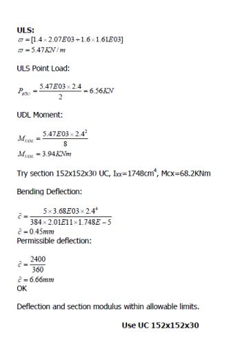

Certainly the figures for bending moment look well below the capacity of the specified steel beam for that span.

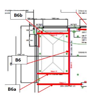

Here is an extract from the plans:
The cross section mentions the joists as being 150mmx40mm, but the remainder of the joists are 225mm x 47mm
In looking at the problem more closely (in answering your question), I was told by the builder that the roof had to be flat as it was impossible to achieve what I originally wanted - a canopy with tiles flush to the slope fo the glass to give the illusion of a part tiled/part glass roof (as the beam would get in the way as it would sit on the wall - and, I had to have a completely flat roof. Therefore, has the problme arisen because they have tried to put 'cranked' beams in on the plans?
Please also note that during the process, I belatedly discovered that the plans were drawn up on Apple - line by line, and not by CAD, therefore, there was no consistency throughout my drawings and as the drawing process had taken so long [he didn't tell me about the commercial job he took on] - I have to confess that by the time the steels were added and the canopy roof changed I was not as diligent as I had been when correcting the numerous initial errors caused both by the separate nature of each of the original drawings and other mistakes that he had made (he rushed the work as well), as we just wanted the builder to start and we had to get BC sign off - this whole process took over four months...
The latest drawings make it a little clearer. If the SE initially assumed a cranked beam would be necessary to achieve the effect you wanted, steel would probably be the best choice.
However, if the roof is to be flat, and the span is 2.8m, then timber would be an economic choice.
2 no. 47x200 C16 grade timbers bolted together would support a uniform load of 10.9kN.
2 no. 47x200 C24 grade timbers bolted together would support a uniform load of 15kN.
If you allow 0.75kN/sq.m. for your snow load and, say. 1.0 kN/sq.m. for dead load, then the C16s would support 6.2 sq. m. of roof. (the appropriate safety factors are built into these figures). Note that if the loading was not evenly distributed along the beam, these figures would need to be slightly modified.
The beams could be notched onto the bottom flange of the main steel beam.
(if you want to see the figures, leave a message).
