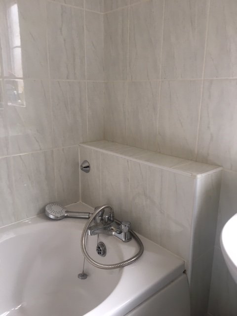

hi All
hope someone can give me some advise on this please.
please see the picture. am hoping there is a way to hang a glass shower screen to this wall instead of the curtains/pole which look horrible and kind of cling to your skin when showering.
however this wall doesnt allow me or at least i cant see a way round it. is there a way to do this or i just have to use a curtain and pole?
also its not a new bathroom and therefore i dont have same tiles to build the section which sticks out all the way up to have an even wall, so am a bit stuck.
thank you
You could fit a screen but would need a bracket at the top too brace the screen and a made to measure glass infill panel over the step.
many thanks Foxhole. i appreciate your response. i think i will just go for the curtains. finding a made to measue glass screen will cost an arm and a leg, as they say. ta
It won't neccessarily cost a fortune
If you fit a standard folding screen by adding a post to the bath/ceiling you could have a small infill panel made. You might be surprised at how cheap it is
thanks Tigercubrider. nice idea. you may see a pic of your idea here ha . thank you.
