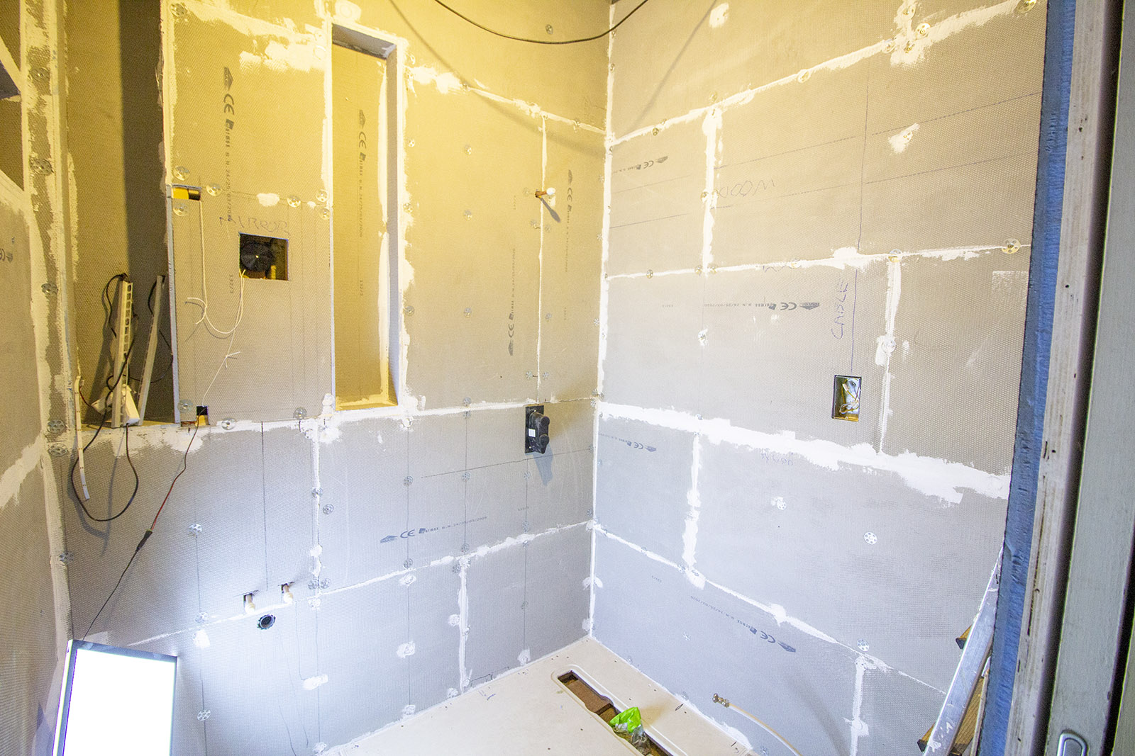

I'm looking for advice on how to fix two 6mm toughened, backpainted glass panels to a Marmox board substrate. The first picture shows the current state of the installation. The second picture is a computer generated visualisation of how its intended to look. I'd like to have the glass flush with the surrounding 9mm 300x600 porcelain tiles.
My thoughts are:
1. Dot and dab with some sort of construction adhesive pushing in until flush with tiles.
---My reservation is that the air pockets behind the glass, between the adhesive, will be breeding ground for mould
Or
2. Use the same adhesive that I plan on using for the tiles with a continuous bed of adhesive over the back of the glass panels. Is that the right thing to do?
Any thoughts appreciated

Thanks for the tips. I will look in to your suggestions. Yes, scrim tape over joints and tanking yet to be done.
