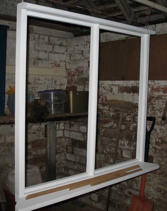

I have just had a window frame made for me which I have to install in an old outhouse and then glaze. I am not a builder, I am an engineer. The window is very simple, no opening panes, and I was given the beading ready mitred for a perfect fit. I would like to put 4mm glass in it and if I used putty instead of the beading that would work (I think !) but the rebate isn't that big and while I can use the bead I would need to use some kind of glazing sealant out of a cartridge instead of putty because I will get a bit short of space.
My question is am I thinking along the right lines or should I forget the beading and putty both sides of the glass even though my experience of puttying is very limited. Any help would be really appreciated and thanks in advance.
