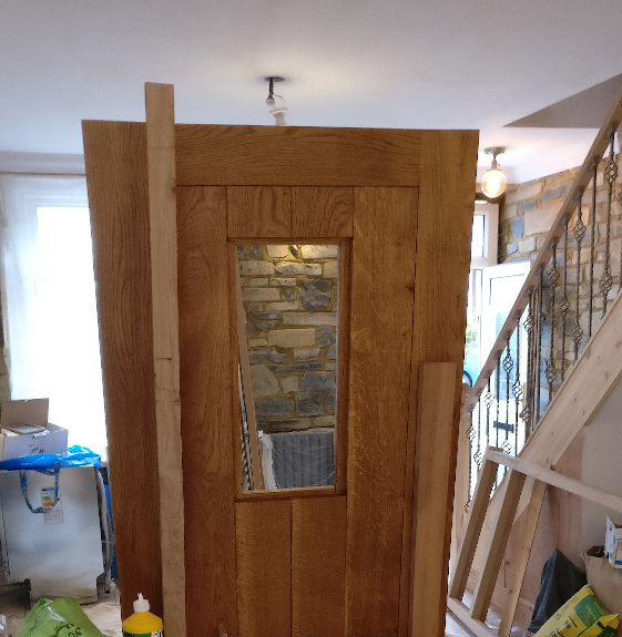

Even with the beads off? Surely you would be able to then get to the edges of the glass and pry it out? I'll attach a photo to show what I mean.
That's the outside face of the door that you can see there. The beads will just go around edge. As you can see, it's pretty vulnerable if someone took the beads off.
to my mind, that door has been fitted inside out.
From seeing how strongly the tape hols the glass into the rebate, I'd say that if you tried to pry it out in the way you describe, you wouldn't pry the glass out, but you would crack it, and then be faced with sharp shards.
It would be quicker and easier to smash the glass with a hammer. If laminated, this would take a number of blows.
Yeah, unfortunately it had to be beaded externally, due to the design on the back/inside.
The glass is laminated, so should be fairly secure against someone trying to smash it, I was more concerned with someone trying to pry it out. If the glazing tape is as strong as you say, I guess it should be alright.
