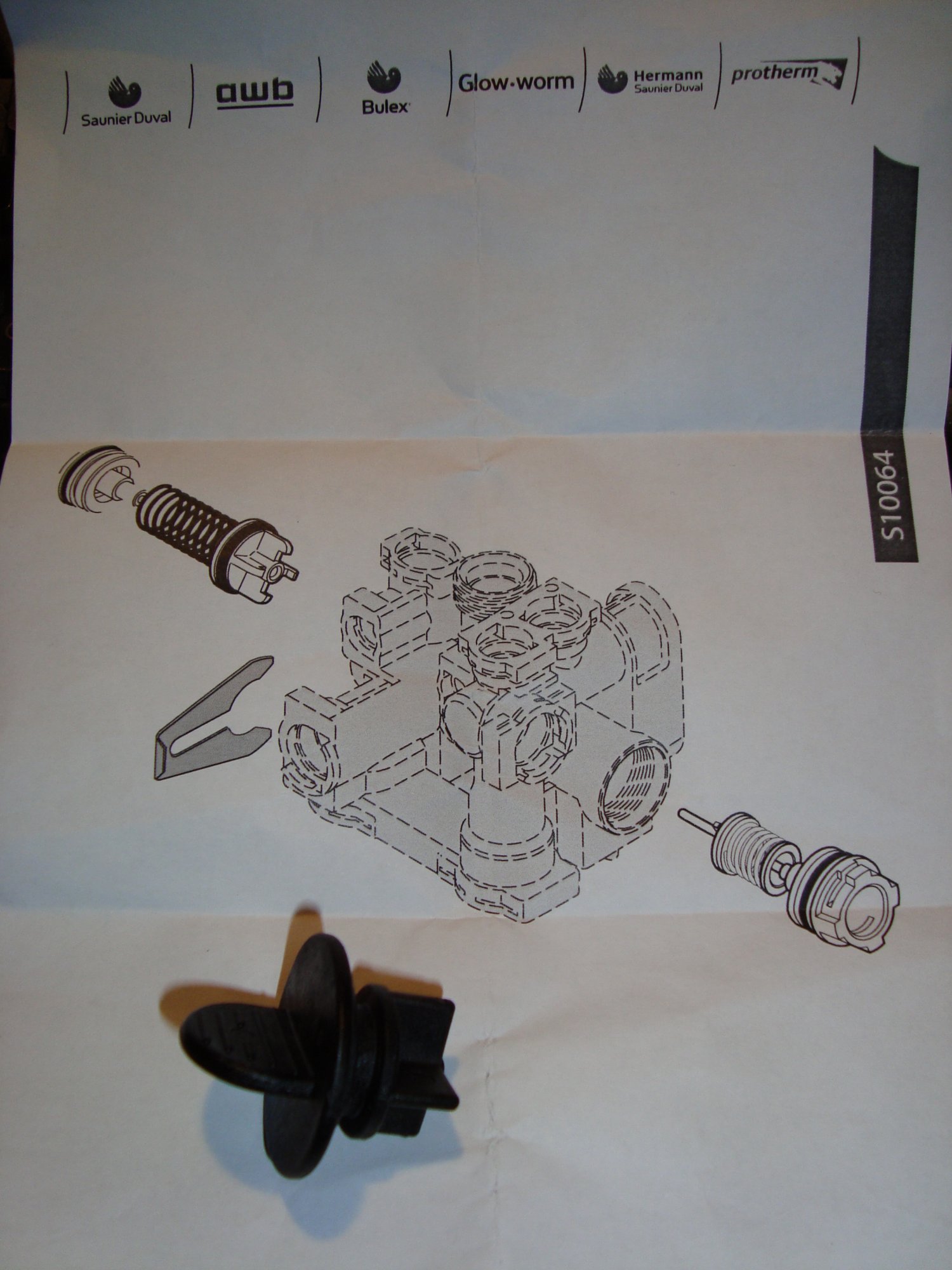

I have bought the cartridge overhaul kit today, and I have one question. In the bottom of my image, there is a black plastic piece in the kit that doesn't seem to appear in the exploded diagram of the div. valve internals. I'm guessing it's not suppose to be fitted in the block/dv permanently.
What is this part for? It looks like a bung of sorts. Is it used to bung up one of the two cartridge holes when they are removed to aid removal of the d/v internals? Or is it a removal tool to help remove a part of the d/v internals?
I'm intrigued!
Been a while since I did one but pretty sure you can discard it. That kit fits a few different boilers.. Must be that one of them needs it (never come across a use for it myself).
