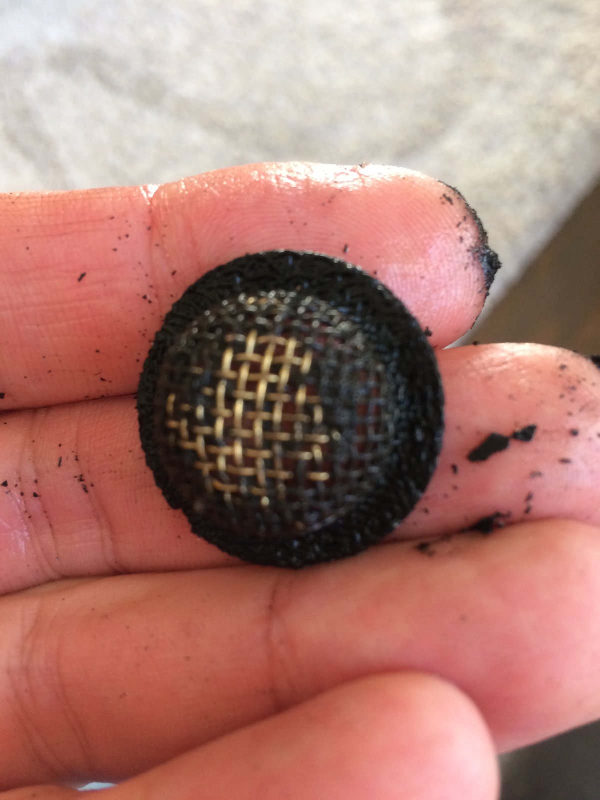

Hi, my radiators are only getting warm but hot water is ok. If i close off most of the radiators the ones left open are getting very hot. Read a few threads about the boiler pipes getting warm etc, but if all the radiators are open the pipes are warm.
Also, if i turn the boiler off a few times the heat does start to come through. Could the pump be on its way out?

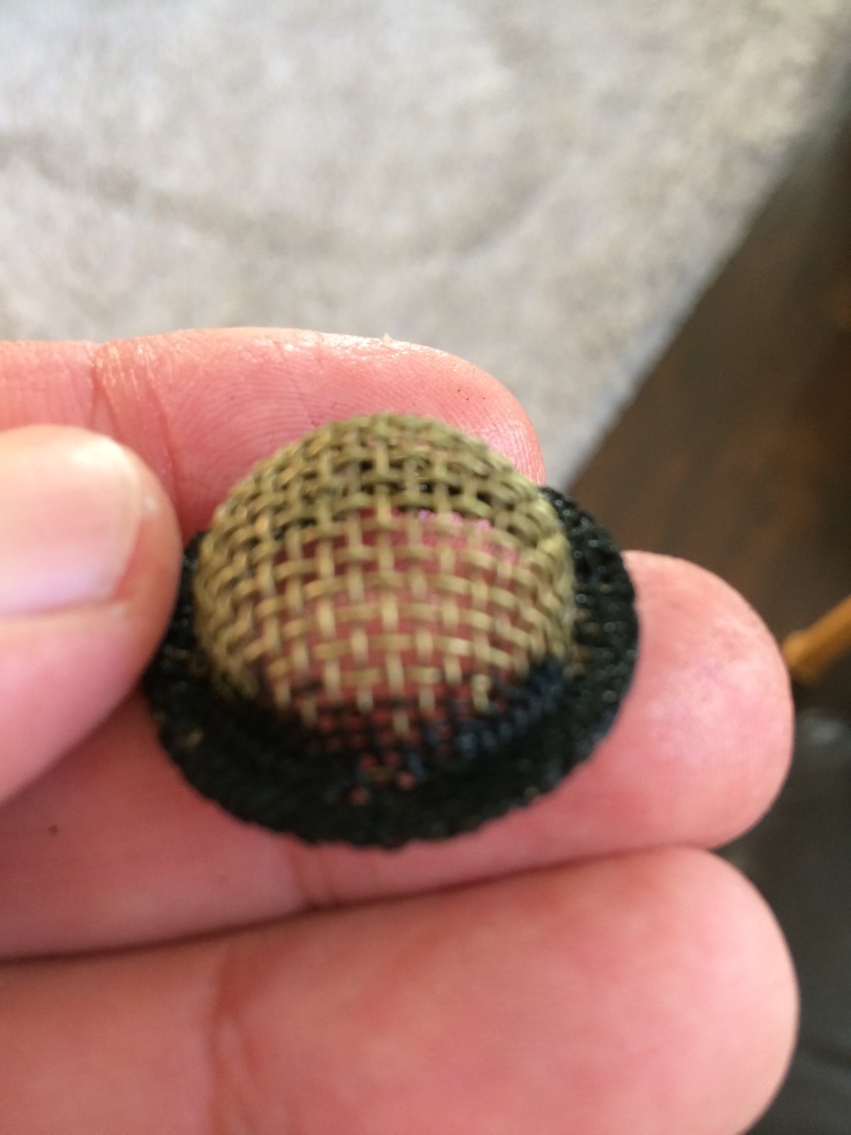

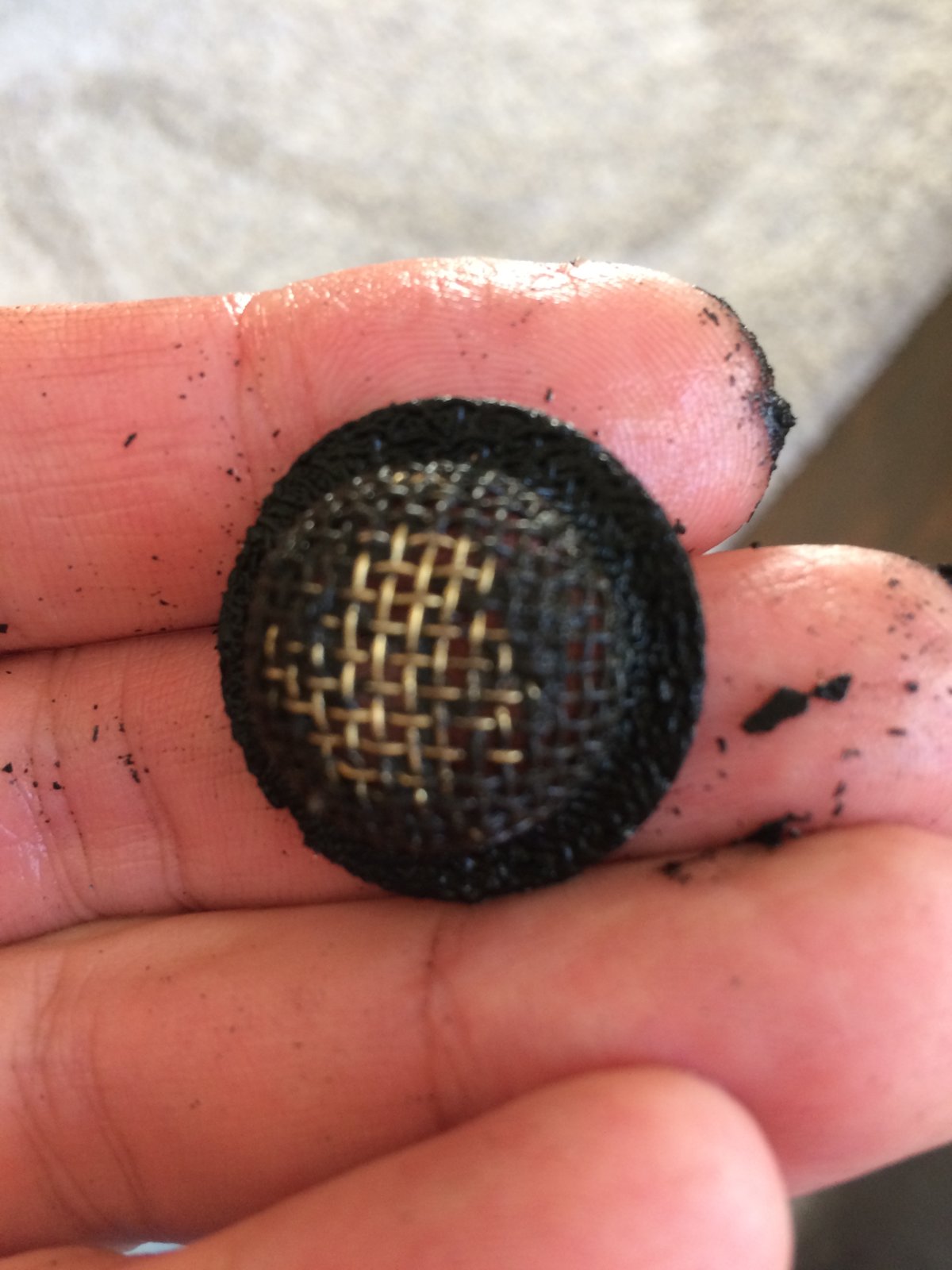

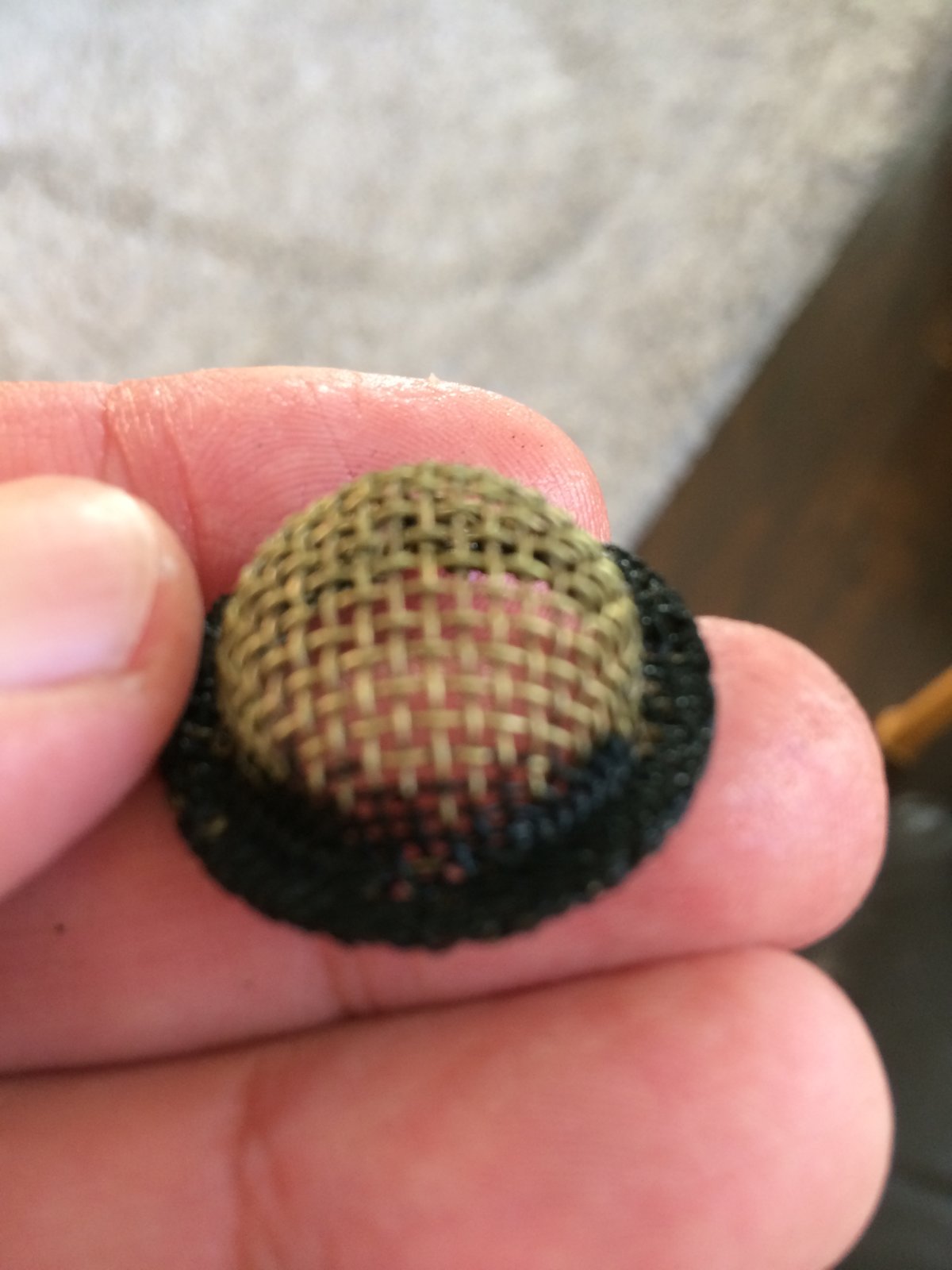

Might still be worth pulling out the return filter located in the base of the pump connection (accessed from below the boiler AFAIR).
Thanks Gasguru, assume this would require a boiler drain? :(
Yes a boiler drain down, bleed the rads and if there's a sufficient upstand of pipework into the boiler you should be able to leave the system fill of water.
Have fun re-charging the vessel...a right angled tyre valve extension comes in handy.
Morning, ok so the boiler has been drained, filter removed and cleaned. Re charged the vessel, heating on so let’s see what happens.

Update. All the rads are now boiling hot!!!! Can’t thank you enough, you were spot on and only cost me a foot pump for the vessel.
