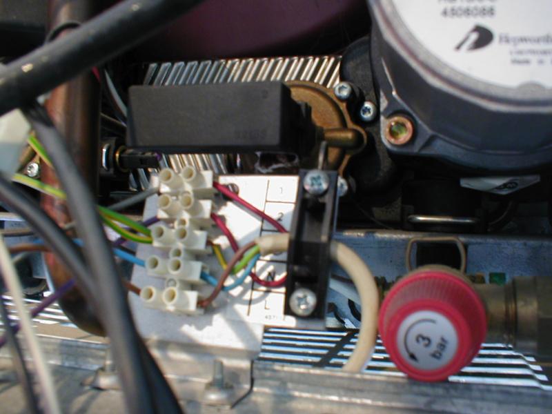

I actually saw the drip I mentioned in my first post a moment ago. It is coming from what I think is the domestic hot water micro switch. The bottom looks corroded and water is dripping from there.
How relevant that is I don't know but it doesn't look good anyway.

There is a Pressure differential switch that looks very similar to the D/H/W switch set up that you have shown in your picture. It is on the left side of the boiler looking forward and is a pump prover switch ( same housing set up ) This needs to be operating to give C/h or D/w/h. ( via a pin on housing) If not then neither will operate. Switch all electrics fully off to boiler and take P/d/switch ( black with couple of wires to it ) off the P/d/sw housing. Break a cocktail stick and insert in the switch ( to make the switch) and tape over to duplicate actual switch making. Stand back and try system again to see if it operates and visually look to see if the pin moves out on the P/d/sw housing. If all works then housing would be the problem stopping pin operating. At least you will know if it is or is not this?
