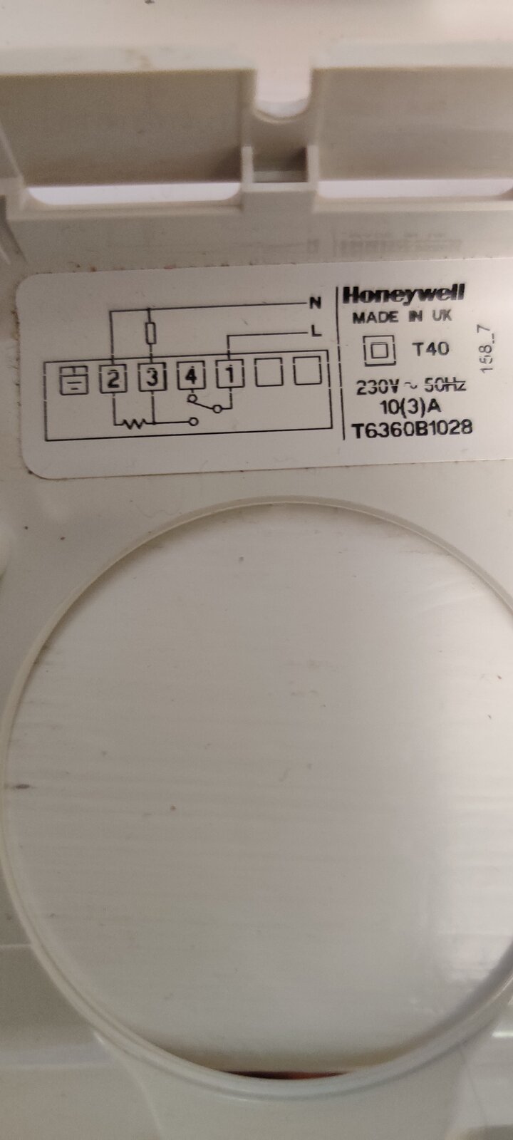

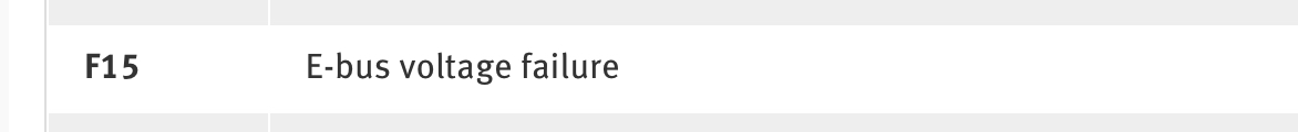

Hi can any one help. My mum just broke her thermostat . It's a glow worm Climastat Room thermostat . I have put a Honeywell t6360 thermostat in it's pace.The problem is the heating is on when the dial is off and when I turn it on the boiler goes of and I get a fault code F15. I have wired it to how it says on the switch. Any ideas anyone.

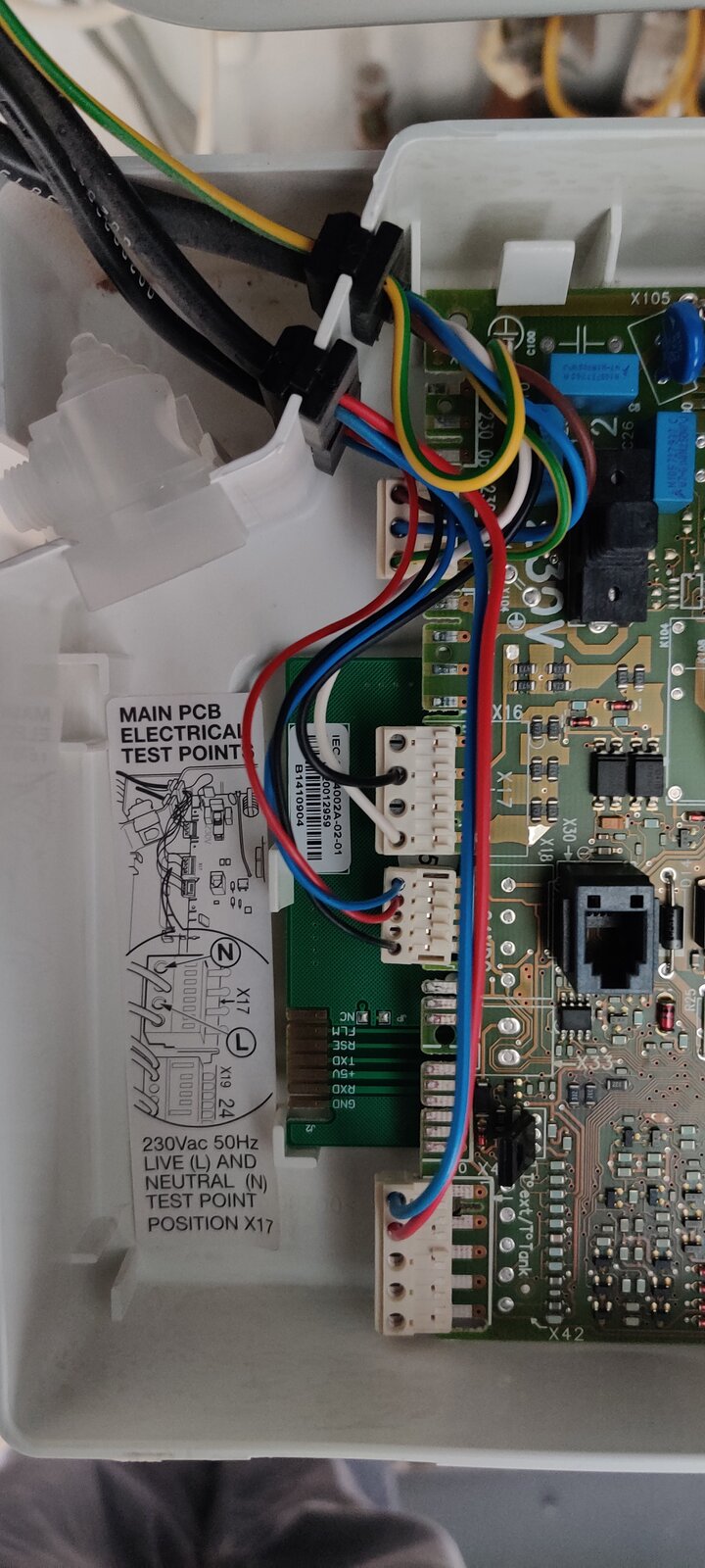

Pcb is sound I soldered the switch on the thermostat so have put that back on. Mum Broke it off yesterday. But I want to use the Honeywell T6360 switch or something similar as mum prefers having a bigger dial. I am not sure how it works as like I said it causes the fault . On the 6360 is 2 and 3 bridged.

You need to show where the thermostat connects to or is it on that bit of the pcb?
The cable goes to this box then to pcb.
