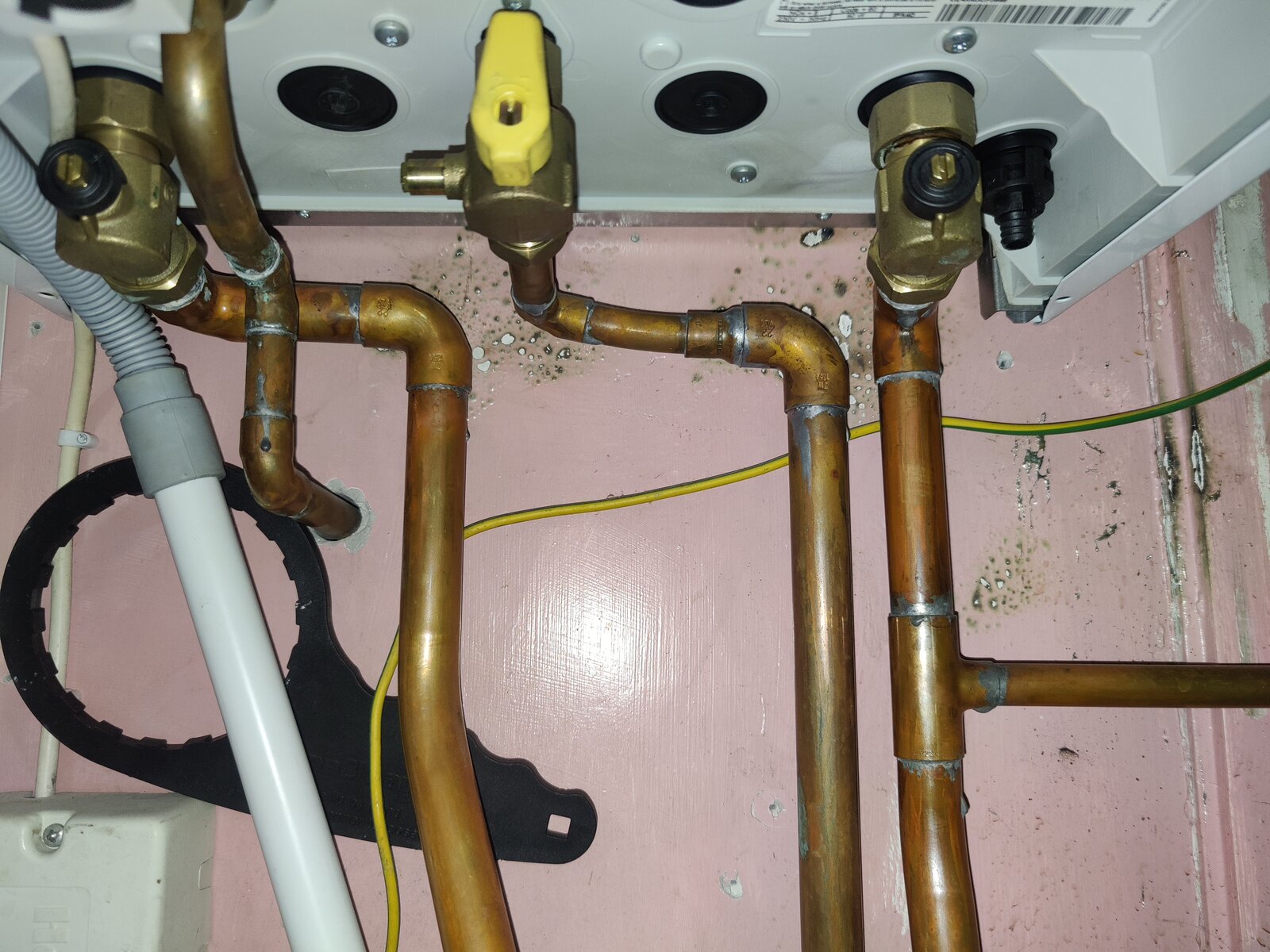

Awoke this morning to a cold house and a Glowworm Energy 30S boiler showing an F75 error code which would indicate a pressure or pressure sensor issue. When I restart the boiler the pressure shows 0.6b for about 30 seconds before going into error, one video online implied it would show 1.5b as default before erroring of the sensor was faulty so hopefully it's just low pressure, but I can't figure out how to increase the pressure as the pipe setup is different to any videos I can find. The boiler controls the heating and is connected to a water tank that controls hot water, the hot water still works. I think I need to open the valve on the right side of the boiler but I can't get it to budge. Further down that pipe there is a small offshoot pipe with a what looks like a black valve attached, with markings on the side for different pressures, that valve turns about half turn in either direction from its current point but doesn't seem to do anything. On both sides of that valve there is a small red button/slider thing that is currently at the top pointing at 0.1b but I can't get it to move either so not sure what that does There is also a maze of other pipes and valves as well.
It was -3 last night so a frozen release pipe is also a possibility but I can't get to it to check as it's on the roof. Can anyone confirm the valve on the right going into the boiler is the one I need to try and turn (think I just need to locate a better screwdriver) and hopefully that will sort it.
Thanks in advance for any help.

You need to keep looking, you’re looking for a braided hose connected, or x2 valves with handles (if that’s what’s been used). Photos of what you have are not related to the filling loop. F75 if related to the Vaillant boiler code (same group) is likely a pressure sensor fault. This will probably need the services of a gas safe registered engineer.
Thanks for the reply. Found it hiding in a dark corner to the side of the boiler, don't know how I didn't spot it before. I topped up for about 15 seconds, restarted the boiler and it still said 0.6b, I then topped it up a bit more to see if it would increase and it didn't but surprisingly it didn't go into a fault code, and then fired up when I turned the heating on. Checked after a few mins and it is now reading 0.9b so it might be ok after all
I doubt it, but at least you’re working again :D
Edit: just looked this up, similar to Vaillant, so engage with a gas safe registered engineer.
