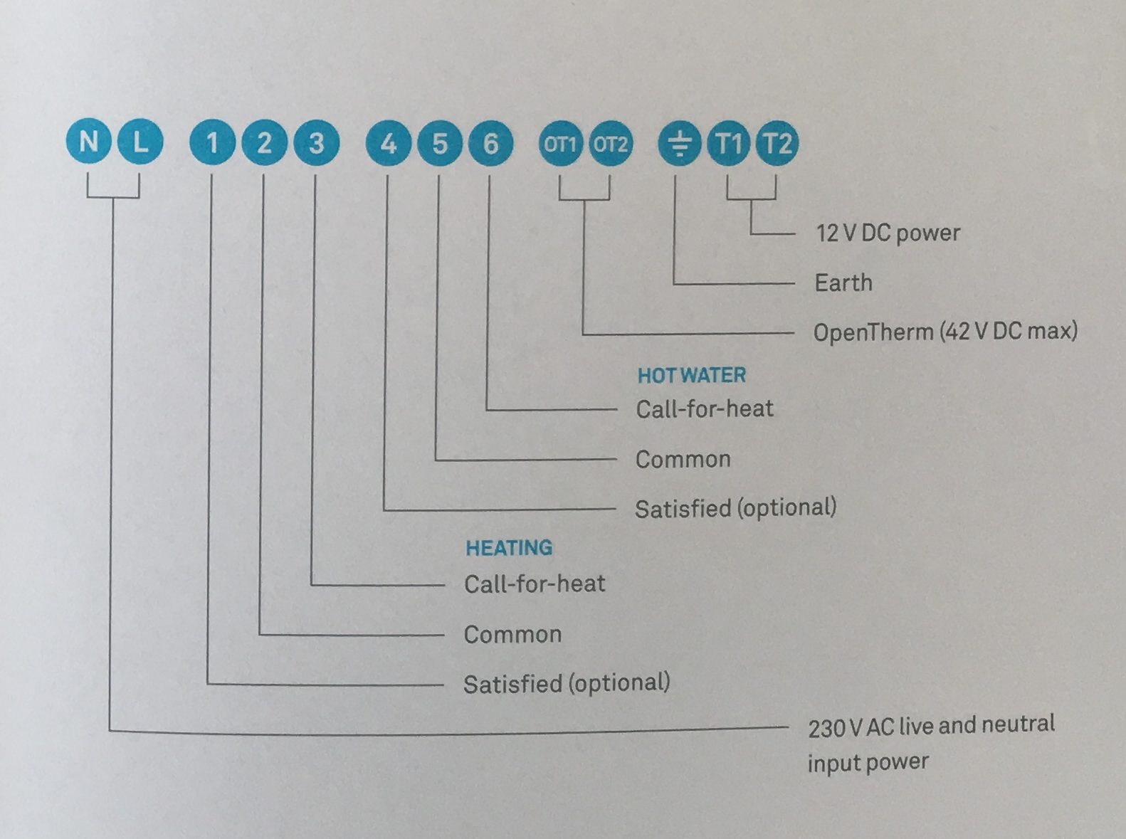

Hi, looking to swap out a Nest Heat Link and associated plug-in thermostat for a Hive single-channel receiver and wireless thermostat. Main reason is that I simply cannot get my head round how to successfully operate the Nest thermostat/controller!! All I want to do do is set a daily schedule of on/off times and temps (so it can just get on with it) but it is proving very difficult and I've given up..

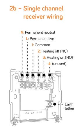

Question; is it easy enough to wire a single channel Hive receiver to the Flexicom 30cx?
I have recently assisted a friend to instal the above to operate with a Worcester Greenstar CDi combi and it was very simple. Mains permanent Live and Neutral come into the fused switch, then go on to the Hive receiver and onward to the Live and Neutral connections on the boiler - easy. Two more wires involved; one (Ls) comes from the boiler (LIVE SUPPLY) and terminates in slot 1 (common) on the Hive and the other (Lr, LIVE RETURN) goes from slot 3 on the Hive to the appropriate slot in the boiler.
Was hoping it would be a very similar when it came to the Flexicom 30cx..but I don't think it is.
I have actually studied the wiring diagram in the installation guide for the boiler (mains voltage system controls and diagram 10.3). The easy (and obvious bits) are the permanent Live and Neutral coming through the 3AMP fused switch. From there they seem to go through a junction box?? On the installer interface, when the live, neutral and Earth are connected, there are just two remaining slots, i.e. R and F. This is where I am stuck...can anyone assist please?
