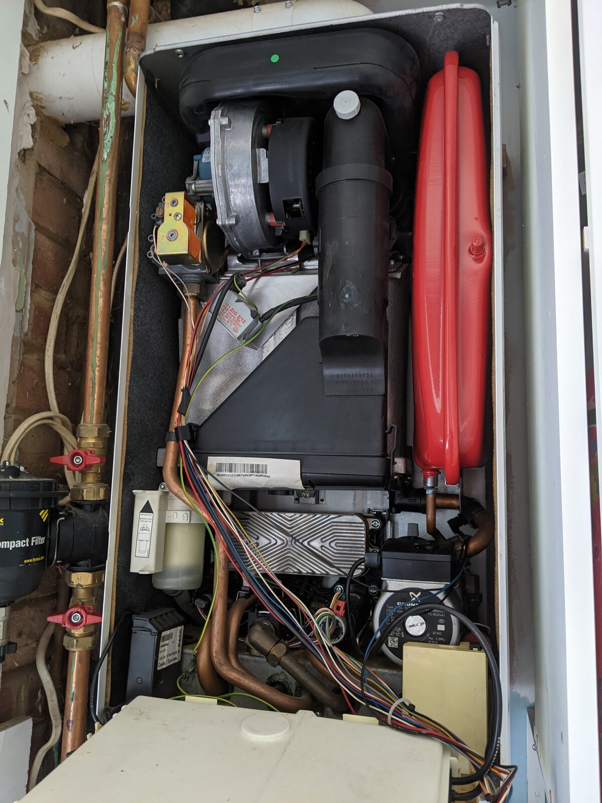

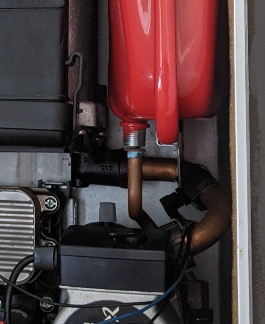

Replaced this expansion vessel today, but couldn't stop the connector leaking (EV was supplied with two fibre washers, I tried one first then both). I did not tighten the nut much at all initially, but that's what I resorted to in the end and have now damaged the pipe.
I've got a replacement EV pipe coming Tuesday, but what's the trick with these so I don't mess up that one too? I suspect its to do with making sure the mating face is exactly aligned with the threaded part on the EV as the nut is tightened / may have been some corrosion or muck on the old pipe/nut that made it difficult to fit right.

As far as the pipe is concerned then everything needs to be clean, corrosion free and lined up correctly. Shouldn't need tightened up too much. Is it a proper Glowworm part you are using and are the seals the correct size.
What pressure did you put into the replacement EV ?
Was the old one really failed?
You shouldn't need to be cranking too hard. I assume it was not cross threaded and the mating edges are relatively flat?
Fibre washers go in your mouth 5 mins before you fit them... So that they start to swell up and make the seal once in place.
Yes, definitely wasn't cross threaded, I was screwing the nut on easily with my hand. I think the mating edges just weren't perfectly aligned as I tightened the nut more.

Thanks but the one you see in the picture is the replacement so no worries there. Just didn't plan on needing a new EV pipe too.
