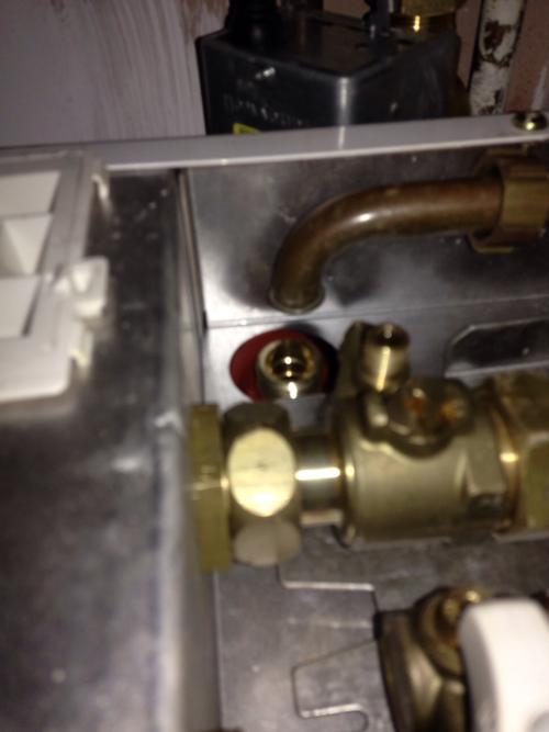

Long story short (ish)
I have a Glowworm Flexicom 30CX, for a few months the pump on it has been noisy/rattling etc...
The other day I get home to find water pouring from the casing. Suspected the pump but not 100% sure, I opt for a Glow Worm engineer for £260 with a promise to fix boiler within 48 hrs.
2 very cold days later the guy turns up, my builder is onsite, I'm at work.
He replaces the pump and leaves. Builder had to get this info from him on his way out otherwise it would have been pure guesswork . He was supposed to call me before 9am to arrange a time, never did this - also never gave anyone his name.
No documentation left onsite, no notes, no phone call to me (the customer). I had to call group service to find out what he had done.
I get home and our regular plumber is there - wife called him over as the heating wasn't working. He found the system completely drained and the boiler isolated.
He also found the pressure relief valve disconnected and dangling internally, which I would have never noticed - so goodbye solid wood floor if it ever over pressurised.
Apparently he had refused to refill the system to test as "your heating might leak". We are lucky to have good relationship a plumber we trust who found and fixed these issues - but it still cost us extra to rectify.
Am I reasonable in thinking this is shoddy, un-professional work?, or is it what I should of expected from a boiler manufacturer engineer?

The first thing I would say is that as it's the CX model the engineer would only of needed to drain the boiler, as it can be isolated from the heating. Leaving the pipe from the pressure relief valve disconnected is just careless on the engineers behalf. Finally as he would of isolated the boiler from the heating system then the only thing that would of leaked is the boiler that he was there to fix.
Sadly it's like most companies these day, they are pushing their engineers to the limit, giving them more work than they can complete in a normal working day. Ultimately some engineers rush leaving boilers in a poor and sometime dangerous condition

Assuming he did actually change the pump and once the system was filled it worked ok?
In which case, Its not perfect by any stretch, but depending on whats going on in your house and the apparent condition of you heating system, he will have arraived to find the boiler empty of water due to the pump leak, and possibly not wanted to take the risk of filling a system where site work is happening when builders are in and about.
The PRV pipe is an easy one to miss although that does not make it ok by any stretch, but again, if soemones being pushed/rushing a job then it will happen.
As far as commiunication goes, he must have told someone he was worrieyd it might leak for you to know that, ideally he would have left a note, but hes under no obligation to leave a load of paperwork in the house. Also the morning call, its quite possible he couldnt get a hold of you for any reason, I know personally when I call a customer, if they dont answer I dont have time to keep trying them all morning.

It would be connected, but they mean he could Isolate it at the CH flow/return valves, there very sturdy (wont leak) valves, and fill the boiler on its own, but that doesnt help your heating scenario.
As I say, Ive worked in a few places where bad expiriences make you particulaly paranoid ie the case that others are in working or have worked on heating systems (a lot of failures through no fault of a plumber can happen after system has been drained and refilled such as when fitting new rads etc) and if the engineer has had a genuine concern then they could leave the boiler fitted with the new part and leave for customer to fill.

there was no suggestion of a possible leak, he apparently said (to our builder who was fitting a floor at the time) he doesn't ever re-fill systems after fixing a boiler "because he was not insured".
yeh pump replaced, boiler working and much less noisy so from that end a good result.
what annoys me is that he knew he was leaving site with the boiler isolated and the system drained having never spoken to me. How many people has he done this to who don't have the knowledge or experience to re-fill and bleed etc...
a lot of people wouldn't know what to do...
The extra £100 was for the plumber to come out same evening, refill, bleed, balance and take a look at a towel radiator valve which has been ceased up for a while. Hence the slightly higher rate.
I just didn't trust that the engineer had done a thorough job, wanted someone I trusted to check and that cost me the extra - I don't think I should have to do this, especially not with the boiler manufacturer involved. - but it was worth it to find the PRV.
