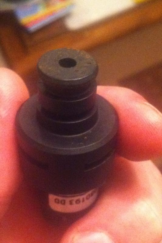

The most annoying problem with this fault I found was finding the correct sensor. The sensor itself had the part code 0020016532 stamped on it. According to Glow Worm technical this sensor does not even exist! The actual sensor you will need (if you have to replace it) has the part code 0020014190.
BEFORE you buy a new sensor I strongly suggest you remove the existing one and simply clean it as when I removed mine it was completely clogged up like this

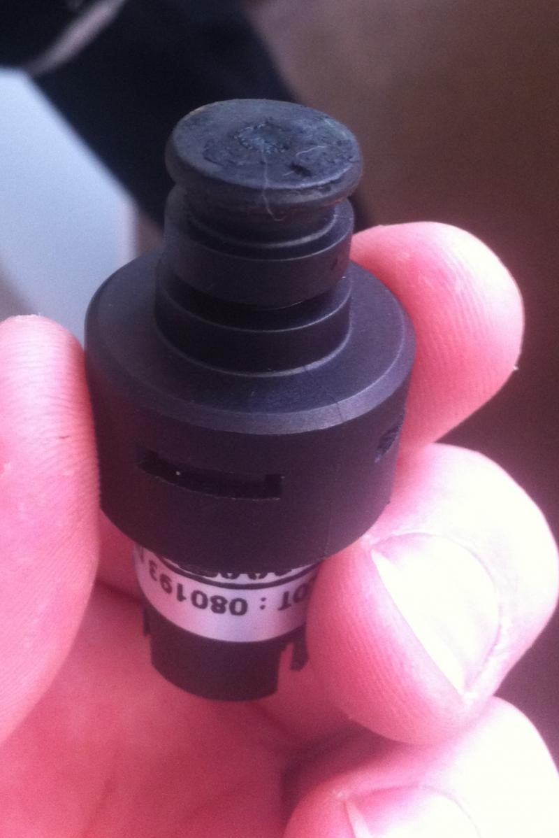

and once cleaned out carefully with a small screwdriver and cotton buds it should look like this

4) If clogged up clean it out as mentioned above and put it back, definitely worth trying as may save you £25. If it doesn't work simply start again and replace the sensor!

Well worked out, it's a known issue (or at least I already knew about it...), cleaning the sensor often does the trick
Thanks, sadly when I tried searching for help on the F9 fault I couldn't find anything about it so was a matter of trial an error!

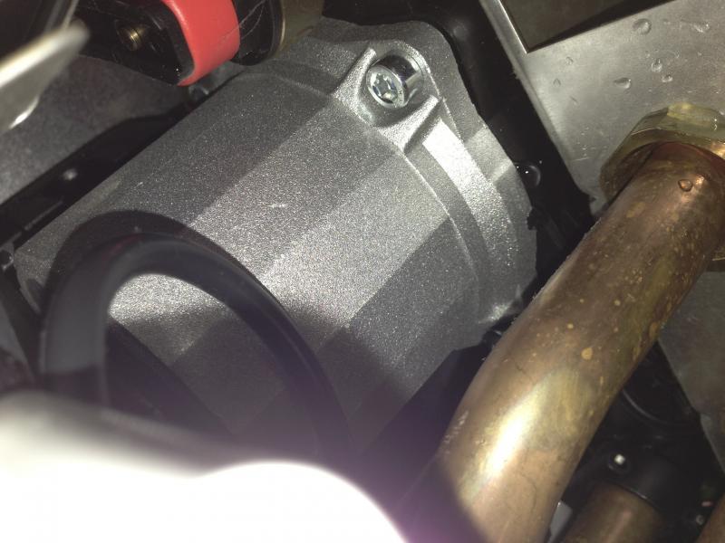

Do not repressurise the boiler to 2.8 again or you may find this happening where water leaks out below the pump and the housing it is attached to
Over £200 for a pump with housing plus labour charge
Although that only looks like a wee drip , it pizzas out if you try to put water into the system,
it has been leaking water when i increase the pressure.
I will check the sensor today, do you think its too late for the pump as its leaking already?
Cheers
If it is leaking between the pump body and the plastic housing it is attached to , then it needs replacing. The pump body and housing are supplied together if it is a genuine Glowworm part You purchase.

the leak i had noticed looks like it was coming from the overflow pipe not the pump fortunately. even though I'm not sure why the overflow pipe would be leaking still
thanks
The valve that the pipework connects to (red top r/h side of pump) opens or should open when pressures reaches or exceeds 3 bar
The two faces/seats of the valve do not sit perfectly flat after this as dirt or tiny ices of grit cause this and it weeps , losing pressure
