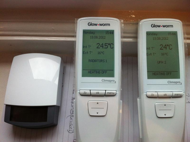

I need assistance in trying to get me to understand how to get the full benefit out of fitting a Glow worm Ultracom combi with a wireless Climapro2 programmable roomstat and a weather sensor.
The Climapro is a 2 channel roomstat which is my case will control the heating system and hot water preheat mode on/off settings
Presently I have got an Ideal Isar combi dying in my airing cupboard- corroding, leaking, error coding etc etc. A Glow worm Ultracom 2 is sitting in the hallway waiting to be installed by me
The Ideal boiler heats up one zone with rads on it controlled by a Danfoss TP50000si programmable roomstat and the other zone with 5 under floor heating circuits on it controlled by 5 Polyplumb/John Guest programmable roomstats.
Each zone has a two port zone valve on it . As far as i can tell when a ufh prog roomstat calls for heat it activates the actuator on the manifold and in turn the zone valve opens, the boiler kicks in and we have heat. Similarily with the prog roomstat on the radiator side opening the other zone valve
Each zone can work independently of each other or together as required
After being in touch with Glow worm technical I am confused with two different ways of thinking. Also I do not want to spend a lot more money if the gain is only pennies!
1. One chap said get another Climapro and a Systempro and rewire the system into the Systempro which seemed a bit excessive to me
2.Another chap said keep with the Climapro for the radiator side and hot water control and do not bother with ufh as I already have 5 prog roomstats anyway, and the difference would by negligible
I do not understand how having two climapros would give me a worthwhile gain and also, wouldn't it conflict with the ufh prog roomstats?
Anyone got any thoughts on this confusing subject ?

2x climapros, systempro and outside sensor is the way to go. bin the current control for the ufh.
otherwise you will just have to use regular controls and no climapro. The benefits of the climapro/systempro and outside sensor justify the added cost imo and a far superior control system to on/off stuff.

Well, I have nearly finished putting the boiler in and at the moment it is working via the present prog stats on the rads and ufh, I may end up sending the climapro back as it seems way too expensive just for the sake of having a weather sensor. Glow worm reckon it adds about 2% to the boiler efficiency, so if my annual gas bill was £1000 does that mean I would save £20...or am I looking at it with my glasses upside down!?
UPDATE:
After two sparkys and another gas engineer have visited, we have come to the conclusion that it is not worth the extra money - £347- to replace the Danfoss TP5000si with the Systempro 2 zone kit. The claimed gain of 2%on the boiler efficiency would mean it would take approximately 20 years for payback ...I would have thought that Glow worm would have made the system work with both 24v and 230v at the same time and not either/or, according to technical .
