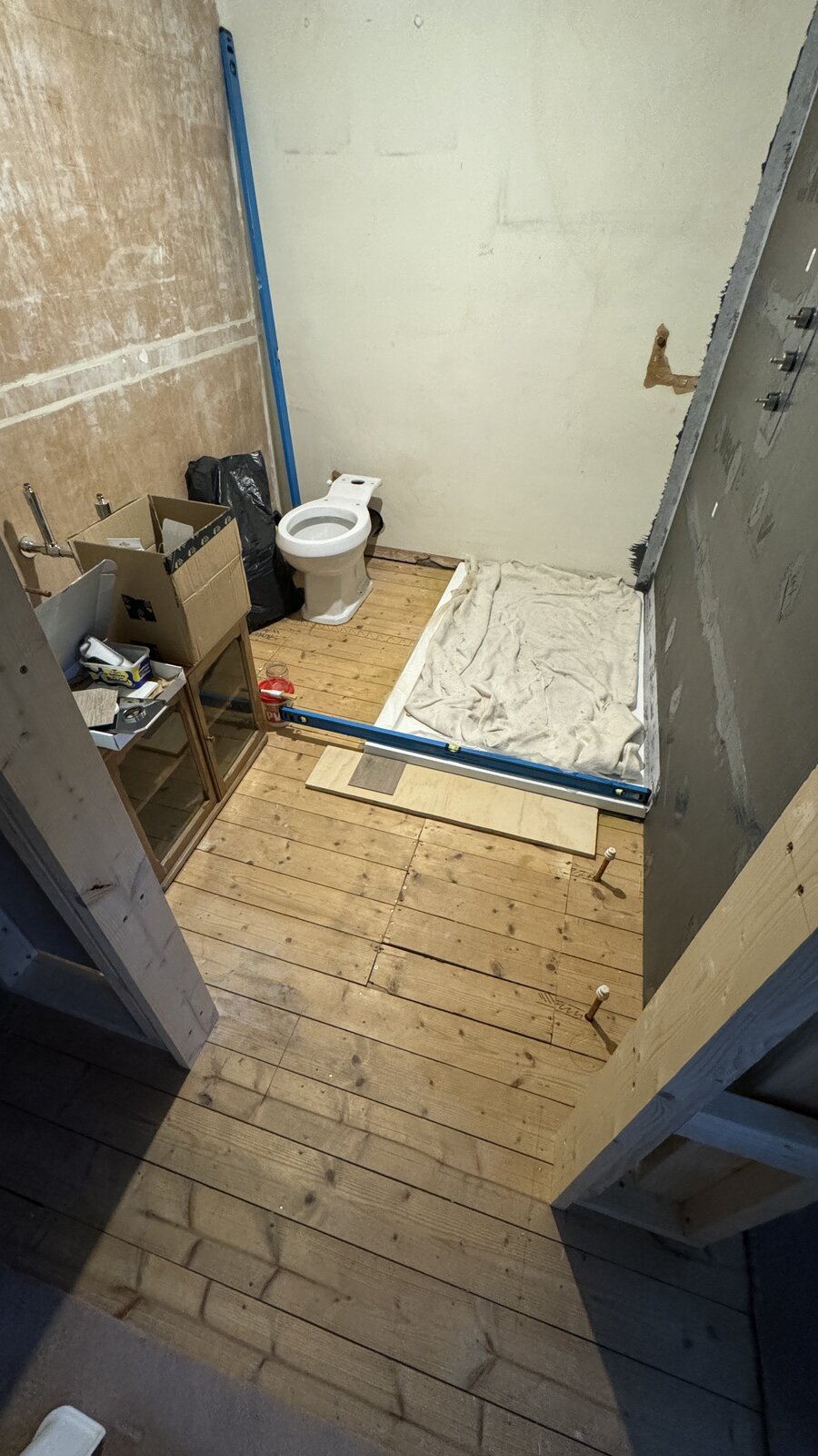

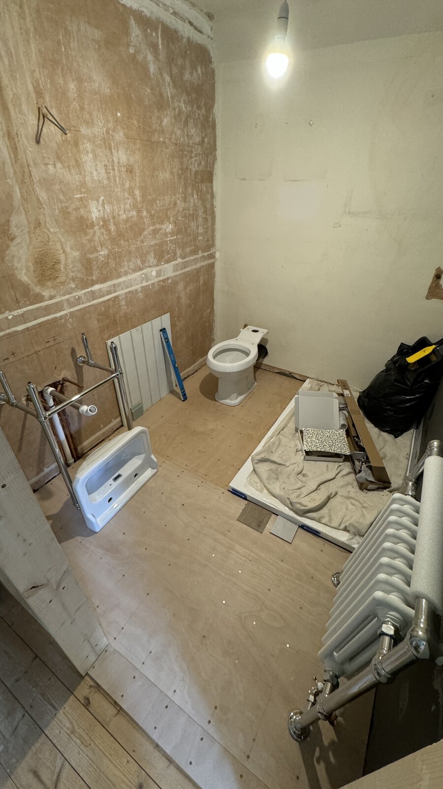

Evening all,
I'm currently building a new en-suite & need to get the base for the floor down. It's an old barn but this part of the house was extended in the late 1970s so the floorboards are relatively flat & in good shape.
We've got a walk-in shower tray but the plumber had a hard time getting it level so the biggest gap between the floorboards and the bottom of the tray is 21mm. I want to run a nice bead of silicone between the LVT and the shower tray & don't want to have to use a quadrant or anything similar. I also don't want a noticeable height difference between the LVT and the carpet in the bedroom.
For that reason I think if I use 12mm hardwood plywood with 3-4mm of glue & LVT tile it should near enough bring me up to height nicely.
I can't find any flooring grade ply in that thickness so can I just use a hardwood plywood like this? It says 'Suitable for structural use in most moisture resistant and exterior applications'. It's an en-suite for my wife & I with a large walk-in shower tray & I'm fitting a decent inline extractor so the floor won't be getting wet at all, maybe just the odd drop here & there.
Thanks!
