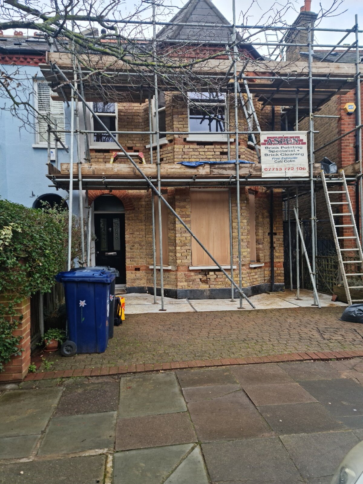

A mate is hacking render off a yellow London stock and red rubber brick house.

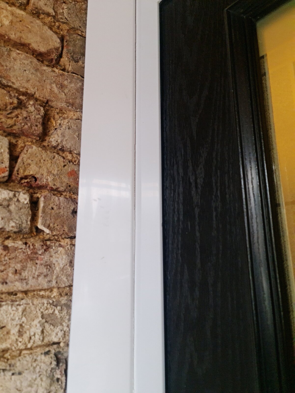

The render is off now and he is busy replacing the red rubber bricks and polishing the yellow stocks. However when he removed the render from the porch area the uPVC "architrave" around the uPVC front door cracked where it meets the uPVC door frame. It is just a straight profile set at approximately 30 degrees to the door frame where it used to meet the rendered porch.
The porch will be rendered. It might be hard to tell from the image, but a crack has developed where the two uPVC faces meet higher up.
What product would they have used originally to "glue" the meeting faces?
And if the said product is difficult to source- would he be able to use something like superglue?
The section is question is only about 600mm.
BTW, the fitters did not use silicone at the join.

The trim is fine, bar the fact that a crack has developed at the meeting face over 25% of the length.
I've never been any good at sticking trims on with superglue, I either get it all over my fingers OR all over the frame so I tend to silicone trims on, some fitters swear by glue and are really neat with it while some use double sided tape, never been a fan of the tape method because when the sun softens the glue they just pop off. If its superglue then its basic mitrebond stuff with the activator, nothing special. If its the joint between the trim and the door frame running the length of the door then I'd run a fine silicone seal all the way up

Thanks.
I will probably go with the Stelmax because it looks like that is what was used previously.
My image isn't particularly helpful.
The trim is 4mm(?) deep and sits at about 30 degrees to the door frame. It isn't flat to the door frame.
I guess that the meeting edge is mitred, meaning that the potential glue surface area is very small.
Other than the area that has cracked away from the frame, a very rigid white product had previously been used.
For all I know they may have used superglue initially on the door frame, silicone at the rendered wall edge and then, possibly the Stelmax.
